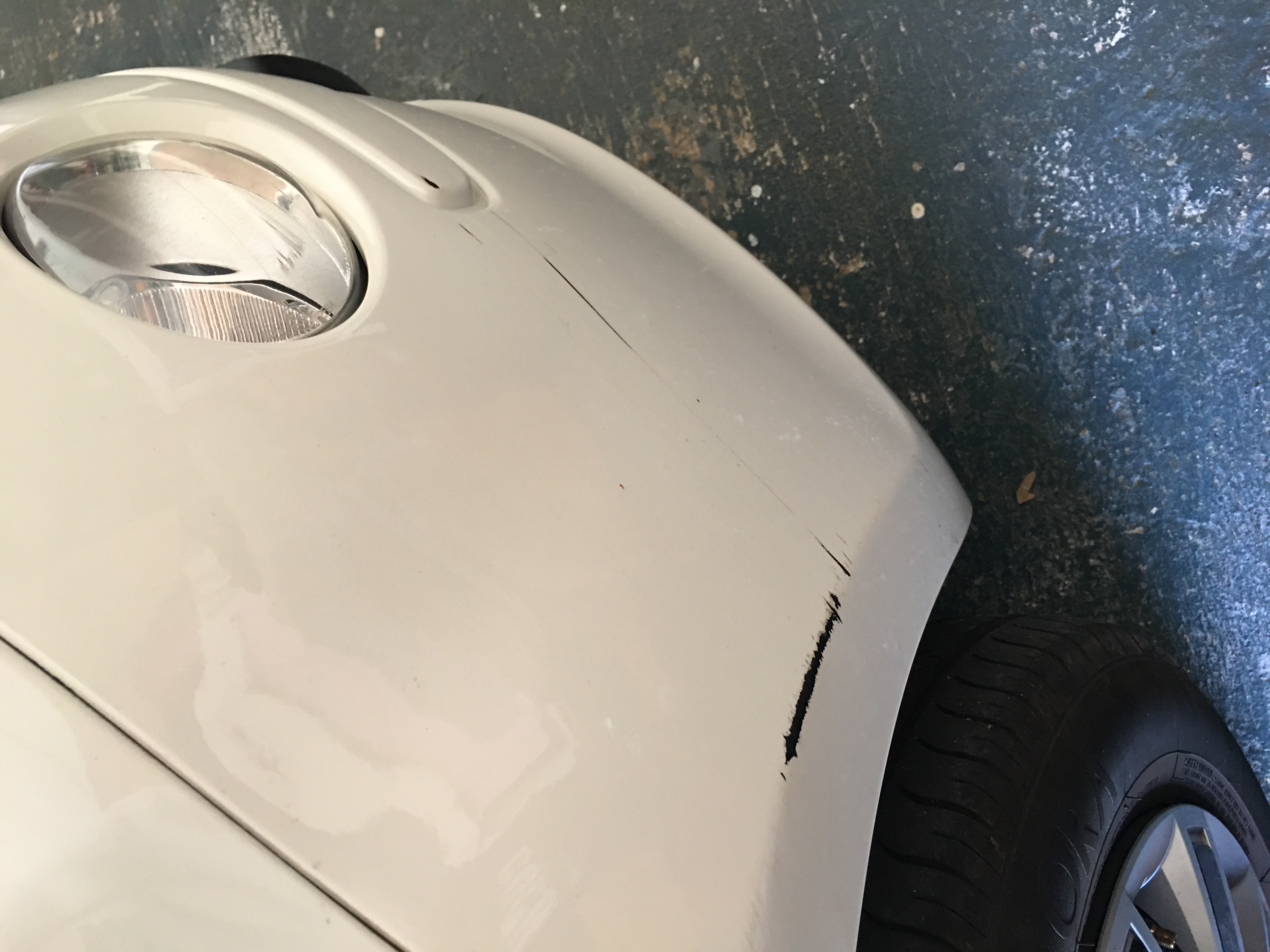

Here are the other sections i need to look at, the rear wheel arch one needs to have the dent pulled out but the paint isnt too bad there
conversely the front bumper has this scrape from the DRL to the side of the arch - im thinking that might have to be a proper job, ie taken back primed and the sprayed etc...
what do you guys n gals think

This is beyond the scope of rectification by touch up stick.
There's some noticeable hairline cracking and deformation in the rear bumper, just below the light unit. It might have been repaired there before. You often see this sort of cracking on plastic bumpers when someone has knocked it when parallel parking.
I had to replace that rear light unit, so yes suspect that was the case and has been touched up previously.
