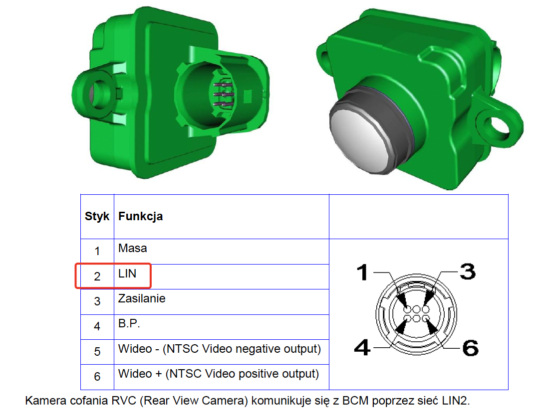

Hi, I recently bought a Fiat 500X and everything seems to be cool, but I don't know where to start solving the problem of a non-working reversing camera, it does not display the image only an error on the radio screen and on the computer two errors U1451-87 and U0422-86.
Where to start, what could be the reason? 🤔 how to reach those plastics in the flap to get to the camera and its plug, maybe I'll start with that?
Model
500X Lounge
Year
2016
I managed to remove this plastic from the flap and remove the blend, when I opened it, the hooks broke, but it's nothing if I fold it, I'll glue it together somehow, but. inside there was a lot of water, everything was wet, I opened the camera and there were also traces of the presence of water on the plate. bath in the washer with isopropanol did not give anything, the same error and lack of image from the camera. I hope that nothing in the radio broke, only something in the camera burned out, etc. the camera that is in this blend is 00520493940 but where to get one, or maybe another one that looks the same but is, for example, with Dodge Challenger 2015-2017 from aliexp will work?
