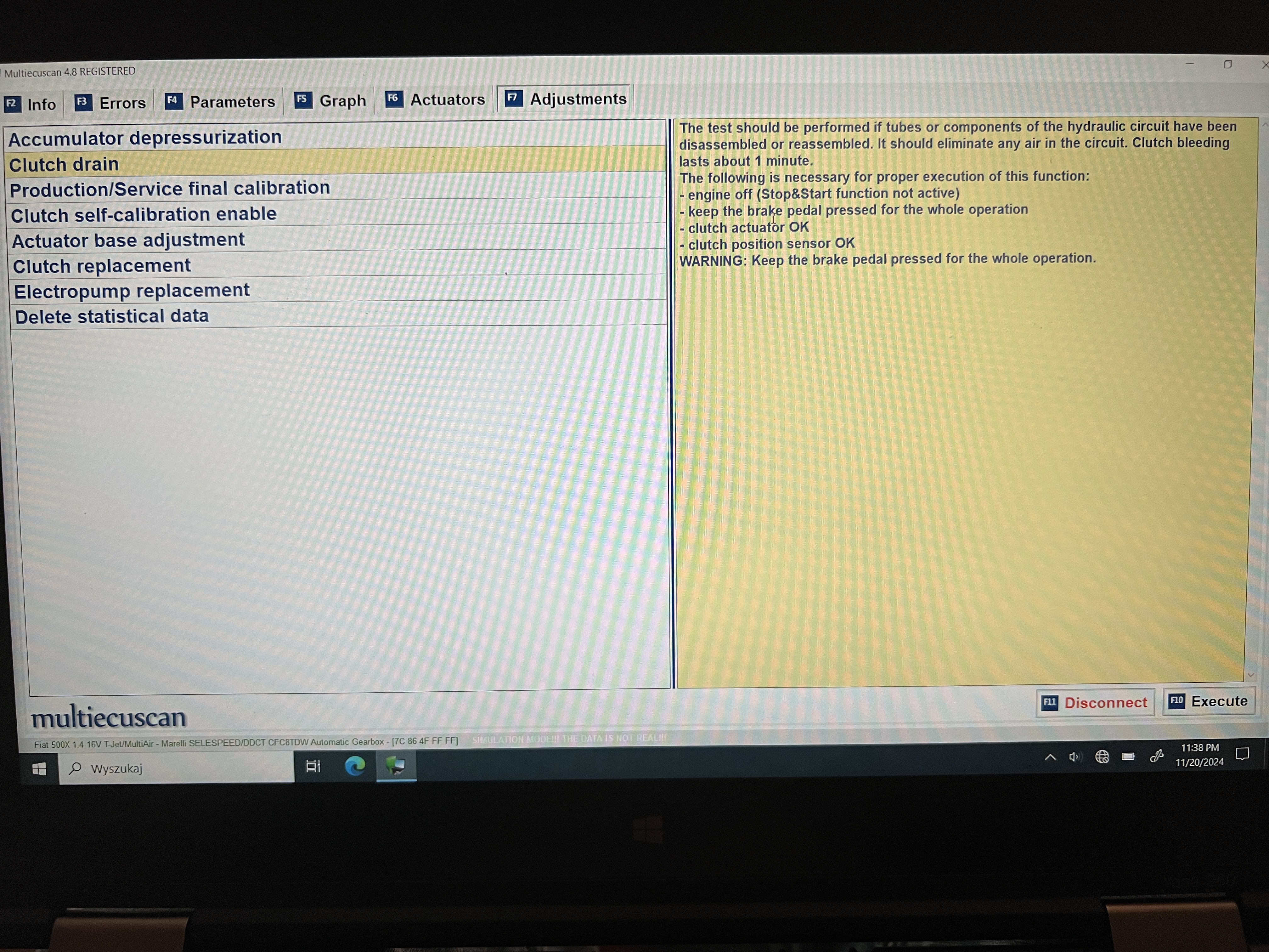

Hi, I would like to change oil in DDCT gearbox and electronic selector. is it easy? just drain and then fill them up with proper oil and quantity or there is a need to do something im multiecuscan? because there are some options there from venting clutch etc. 🤔

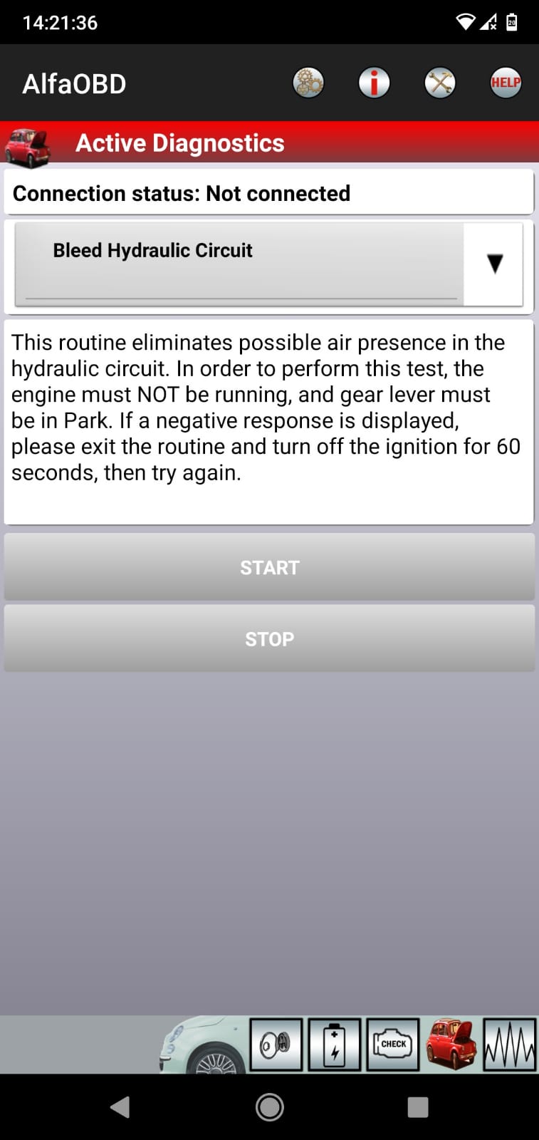

To change the hydraulic (not transmission oil) you need to depressurize hydraulic circuit, disconnect negative terminal. After changing hydraulic you have to bleed hydraulic circuit in AlfaOBD terminology. I haven't done this myself. Contemplated till i sold the car.

I would at least bleed the hydraulic circuit at this stage.
This option? I have only Multiecuscan
I think this is for manual transmisson clutch bleeding. I am not sure.
