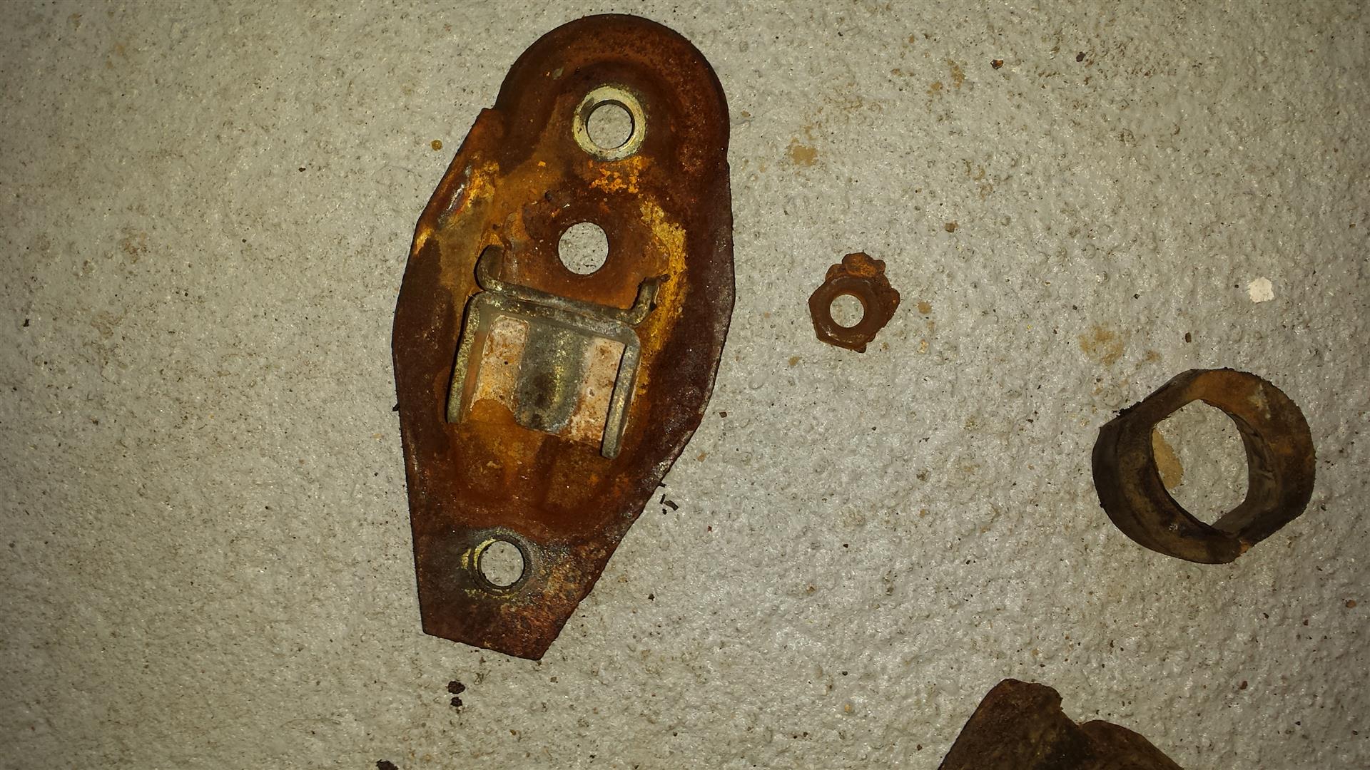

I now have the car in my garage and work has begun in earnest. After getting a new battery (the old unit was dead) and attempting to start the car, the starter cranked really slowly.
I recharged the new battery, stripped and cleaned all live feeds and earths, and finally got the car to start. Unfortunately, it turns out that the alternator is seized since the garage was filled with smoke and the sound of screeching. The drag from the alternator was presumably causing the starter to struggle.
I liberated the alternator today, but in doing so, I noticed that the engine mount was sagging and clearly in poor condition, so off it came. Found some more cowboy work. Some moron has (badly) tack-welded the captive nut, but it parted company during it being tightened and they just left it hanging. Also, the lower front nut was missing entirely.
