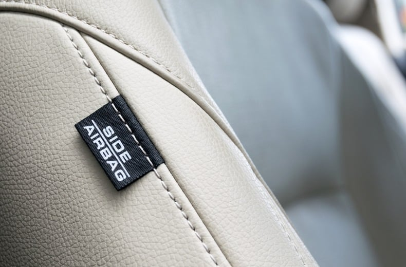

Many makes of car have it written on the seats, but usually when looking under the seats you can see where the wiring plugs go. Often one to the seat occupancy sensor, another to a seat belt tensioner which tightens the stalk in event of an accident these are fairly normal connections so if you see more, then possibly air bags in sides of seats which is less common and used to protect in the event of side impact.
Whatever type you have is usually safe to work on if you follow what I mentioned about disconnecting the cars battery as the airbags need an electrical source to trigger them, often from a capacitor which is why you have to give it time to discharge.

The advice to disconnect the battery and wait applies to any part of the SRS system, which is not just seat airbags. All 4x4 Cross models (such as the OP’s) do have in-seat airbags. Generally options on other versions. The advice also applies to the seat belt pyrotechnic tensioners (that every Panda has at the base of the seatbelt close to the bolts used to mount the seat), and also of course to the various sensors to trigger these as well as the ‘main’ airbags. So no, of course you don’t disconnect the battery to change a bulb, but yes, you really should if removing a seat. That said, for any dismantling task it’s considered good practice.
