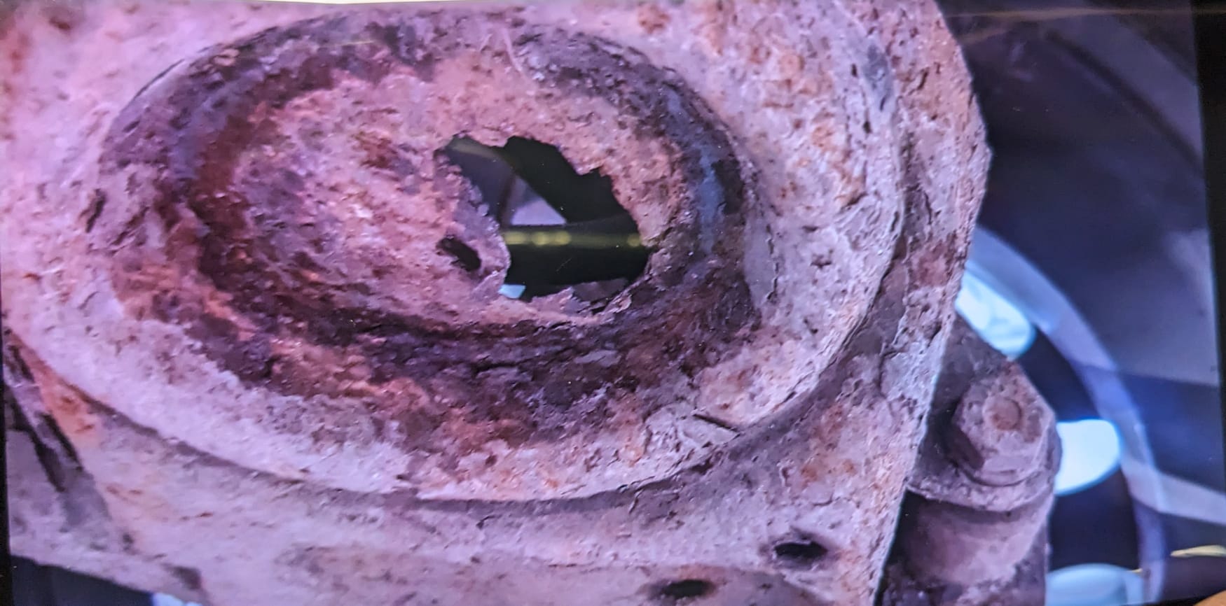

Hi,
I bought a fiat 500 two days ago, the seller (a trader) has gone AWOL and I am left with a car that has failed it's MOT.
I paid £3k for a 2011 fiat 500 and it has a number of major MOT defects
1. Suspension Spring mount corroded (I think rear) please see photo of the issue [5.3.6(a)(ii)]
2. Engine mil inoperative or indicate a malfunction [8.2.1.2(h)]
3. Electronic power steering, system malfunction [2.6(a)]
In your opinion, how much would you think it would cost for a garage to resolve these issues? Am I just throwing good money after bad?

I've looked at the picture of the spring pan again, and it really is in a shocking state.
The rear beam can be replaced, but I'd also be concerned about how much other corrosion there was on the underside of this car. I'd be surprised if it wasn't necessary to replace most if not all of the rear hydraulics; I can't imagine that any of the parts attached to that beam will come loose easily.
I wonder what state the sump is in?
The bill for sorting this car out could start rising pretty steeply once someone has gotten into the job.

If it is just a basic or fairly standard model then it could be a straight forward swap from another car and some new brake pipes if unions do break.
I agree though it looks pretty rough and cost could escalate rapidly. We still don't know about the steering and MIL light issues, does it need a new steering column ? is there anything wrong with the engine ?
If "my nephew/niece" for example had got in this predicament.. I would ask MOT station if plating those spring pans would be acceptable
Probably @£120 job,
but you get your free retest, and the chance to legally drive a 500 for 6+ months
If you hate it.. Or it's a dog.. You haven't spent Lots getting it fixed
A good battery ( and a £15 earth cable) could well sort its other current issues
If the OP wasnt an hour away.. I would offer to give it a proper evaluation

I’d expect to pay £500 maybe more for a new rear axle installed, I would not have it welded
I agree with you Andy in that I don't think welding is the answer. You'd probably get away with welding the spring pans but the axle itself is a "twist beam" so probably not made from simple mild steel and may well be weakened or made brittle by welding. I've mentioned before that Becky will be needing a new rear axle soon, almost certainly this year. So, although I'm hoping to do it myself, I thought I'd ask my local Fiat indy for a quote. Around the £600 mark - providing nothing goes horrendously wrong when removing the old one. Understandably he said it's really all down to how it comes apart and he's reluctant to give a firm price because of this. If it "falls apart" it might well be less but if studs/bolts start snapping off in large numbers it could well be more as he'd charge a job like this at an hourly rate. I've definitely decided I'll either be doing it myself or perhaps, if she passes her MOT in March I may just calling it a day with her, sell her on and start looking for a replacement. I'm very undecided at this moment because I've become "emotionally involved" with her over the years.
As above, if it goes well, then probably about £600 at a good local garage. If it's really bad, probably nearer £900.
I've done a few now (mostly Pandas), and they do vary widely, and I now usually build up a complete unit (with new pipes, cables, shoes, drums etc) to cut down the time spent actually doing the swap.
Although, if I was doing it in these circumstances I would be tempted to get a complete second hand beam (with all brakes, pipes, handbrake cables etc.) from a good supplier (club500italia maybe?) and trade the warm feeling of a brand new beam against the reduced labour costs and risk, as it then becomes a simple quick meccano job (probably plus a couple of brake pipes).
Good solution I think. from all we've been told the car doesn't sound as if it's been "loved" so is almost certainly not a "keeper" anyway.
That was my thinking.
The more is left undisturbed the better.
