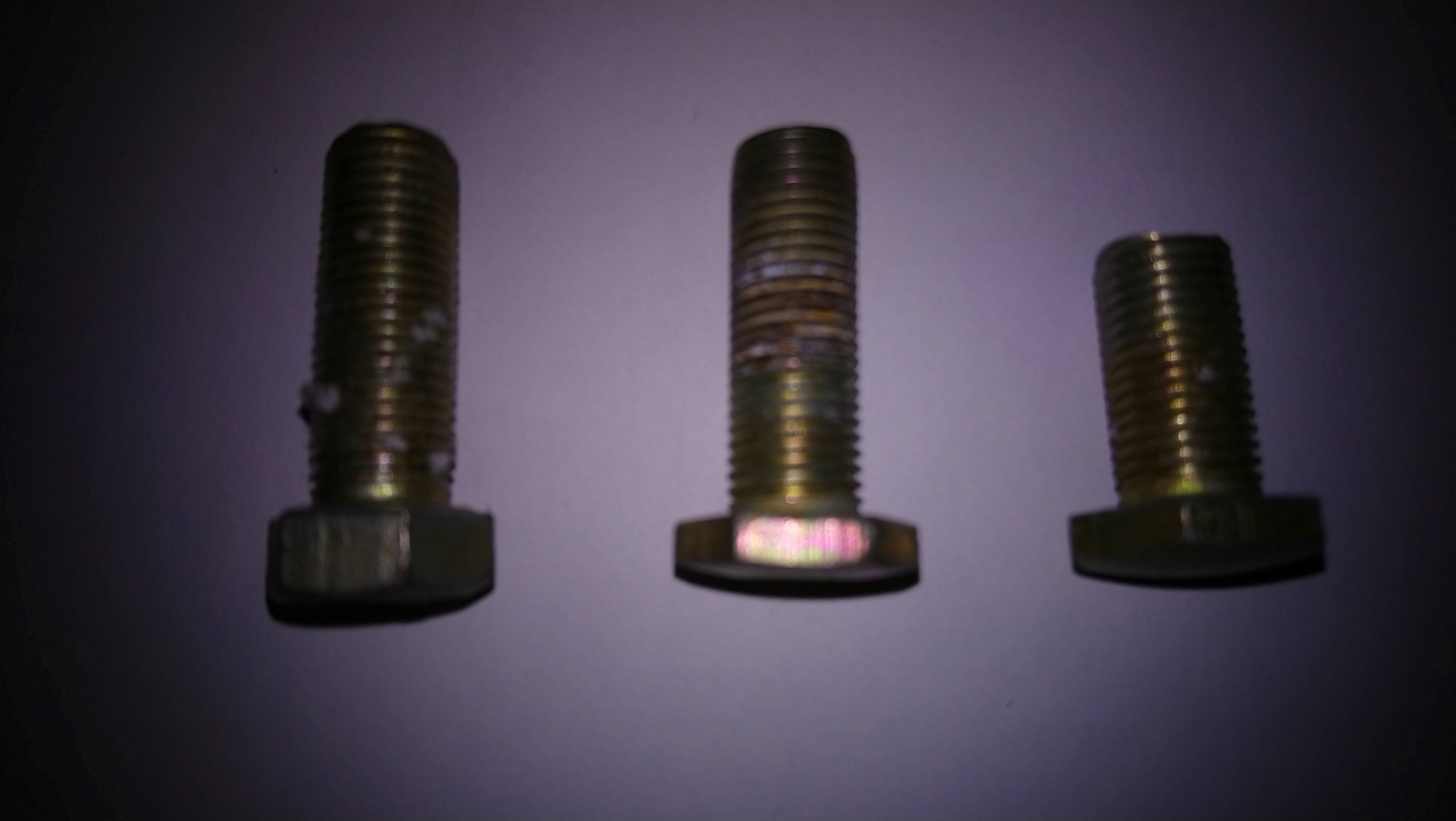

In my ageing stash I have three seat belt bolts.
Two are about 31mm thread length, the other only 22mm.
One long, and the short one, have 11/16" heads. (I think a 17mm spanner fits fine) They have thin heads, as used to be the norm.
The other long one has a normal thick head, and is 16mm spanner size.
All are 7/16" UNF thread, despite the metric head on one.
If any, or all of these are of use to the OP, send me a private message, with your address, and I'll pop it/them in a jiffy bag and post it.
Sorry the pic is poor, that's my best photography, right there.
The thick headed bolt is sticky, as it was wrapped with insulation tape, no idea why, but has now picked up some fluff. If useful, it'll need cleaning.
