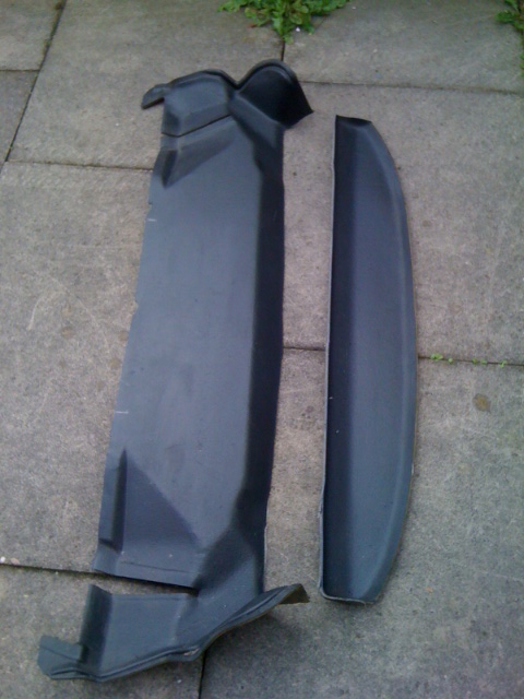

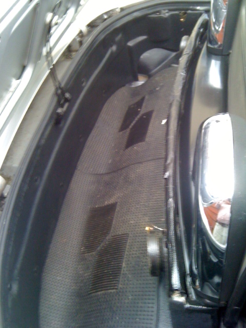

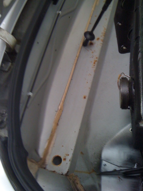

Ok, I have taken some pics and I hope they are self explanatory. You'll see the holes in the shelf. There are no tubes to conduct the water away, but I have poured water in and it all seems to come out under the car. The fuel tank lives under there. I'm pretty certain it all comes out. Don't forget, water shouldn't be in there, so I guess the bungs are to drain it when it gets in??
As you can see, the shelf was rusting, so a quick rub down and a coat of hammerite, and it looks good. Then I replaced the liners, but I cut off the horizontal part of the lower one so that it cannot hold water. In the last pic you can see that I used a couple of old rubber floor mats to cover the painted shelf and these sit just above so won't get wet or hold water.
Until I get my new hood water will still get in. but it won't stay in!
