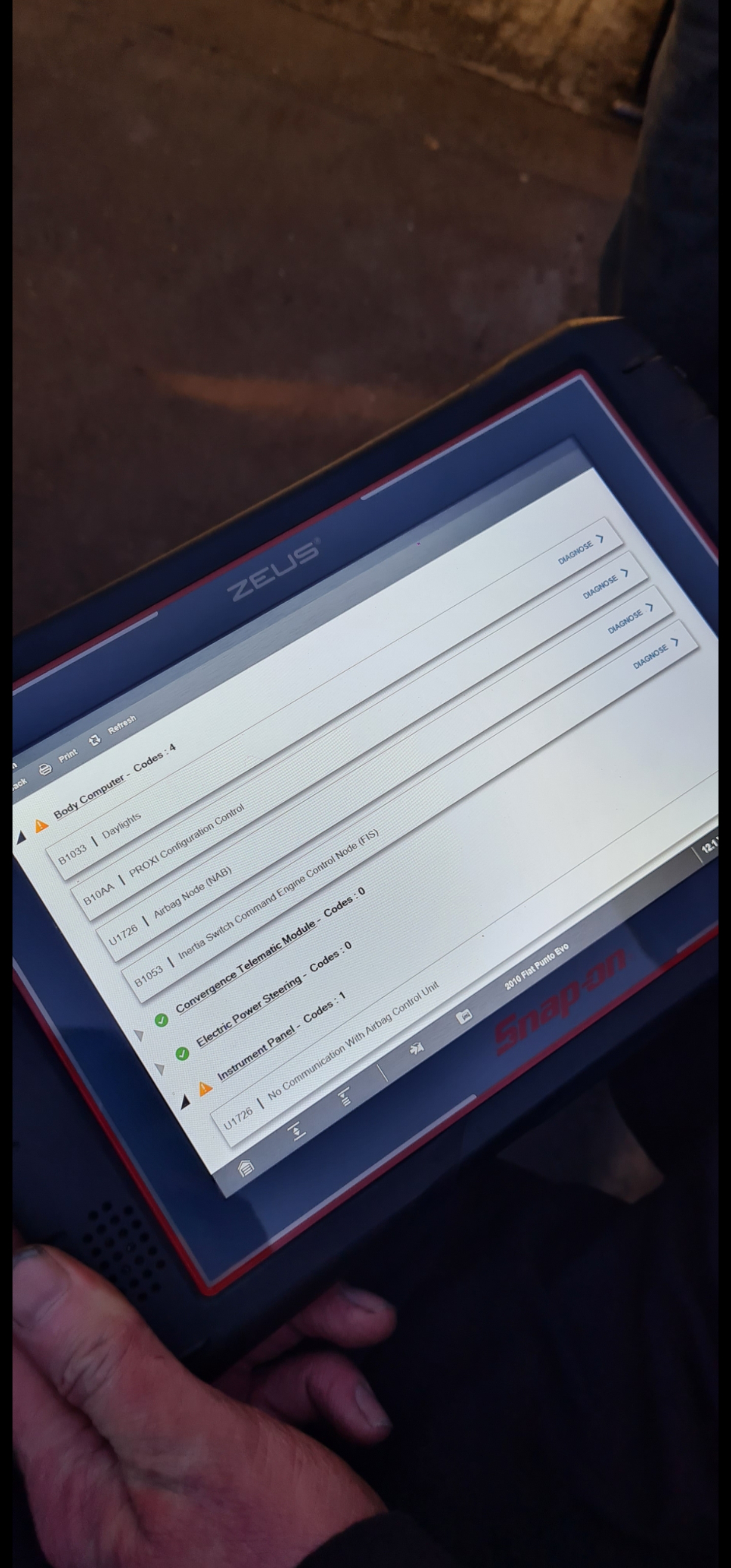

My Punto Evo has come up with Airbag and Seatbelt warning lights on the dashboard as well as "Start & Stop Unavailable", and "Fuel Cutoff Unavailable". I had a scan done on it and got the following error codes:
- B10AA
- U1726
-  B1053
- Ignore the daylight code in the attached image (sorted this)
I had my battery changed recently and made sure it was a stop/start battery as the "Start & Stop Unavailable" message was showing beforehand but I dont remember the warning lights being there before this - could it be this that caused the warning lights?

Hi guys,
Posting on here as I'm hoping someone has had the same thing as me and managed to find a fix.
- B10AA
- U1726
-  B1053
Any assistance would be great on this as garages I've been to have just pushed me away really.
Did the garage run the "proxi alignment" program? It may just have been a case of the battery fitter not following the correct sequence.
Having said that, there are many issues that others here can advise re earthing etc. that can throw up errors related to Stop Start etc.
I did have the U1726 on a daughters 2012 Punto Evo, but that was down to a poorly repaired seat sensor damaging the BCM

GOOD NEWS! Sorry for the late reply but I've only just managed to get this sorted. It was a fault with the Airbag ECU. I ended up taking it out of the car myself and sending it off for repair to a guy on ebay for £95. MUCH better than the £900 that I was quoted by local garages...
