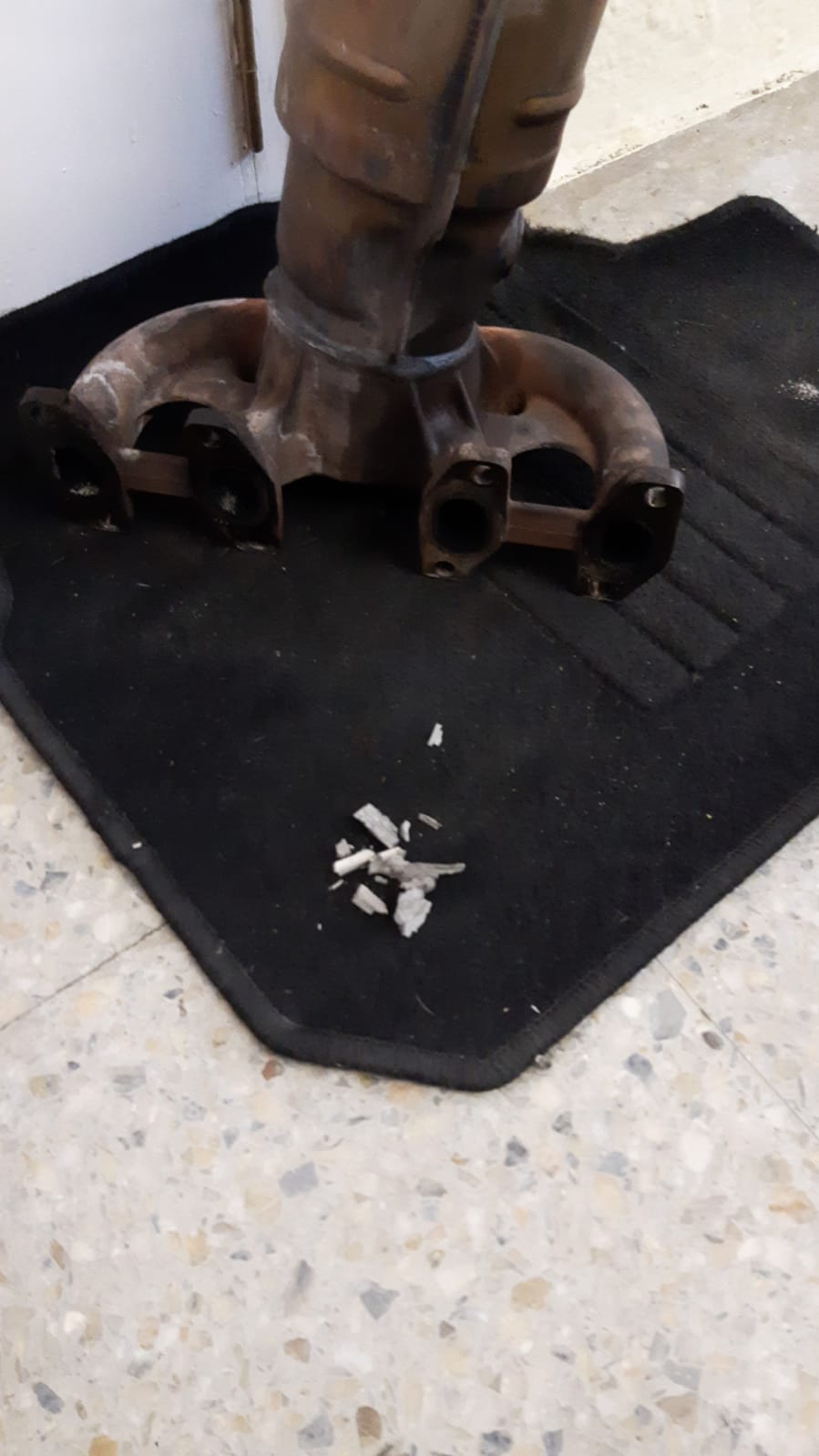

The probes were exchanged for others from another sixty and the same failure occurred.
Injectors also from another sixty.
There is no error in obd2, neither in the device I have nor in the workshop machine.
Talking to someone who has the same car he tells me that the sensor is high in acceleration. They are not expensive, I will exchange them for new ones.
I have bypassed the engine light with the battery light, so it turns on and off at the MOT.
With the probes changed we will look at gases again before taking it.
Thats what I would do, install new sensors. Check wiring and make sure the car is given a good idle and drive so the ECU is allowed to learn the mixtures before having emissions tested again.
The old sensors - I expect the wiring doesnt like being disturbed and they can be very tight to remove and damaged...
The only other posible issue is oxygen getting into manifold with a small leak at exhaust manifold/cat gaskets?
