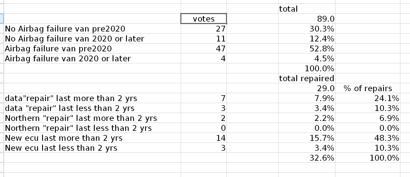

I have an Fiat airbag module with the EEPROM 25LC640A that has the B010200 error, I removed the error between CE0 and DE0 (replaced it with FF's).
When I installed it back, the airbag red light was disappeared at first but appeared again within 10 seconds.
The car reader says it's still error B010200.
Could there be something I missed in my code?
Or could there be some lose wires somewhere in the car?
Does anyone have any clue or schematics? (It's a 2019 Peugeot Boxer L3H3 2.0 BlueHDi 130).
In attachment you can find the file that I writed into the EEPROM.
