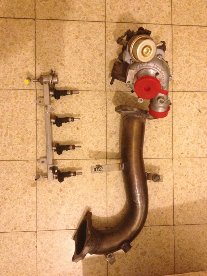

I have an option to buy some parts that were taken off from 500 Abarth:
IHI VL38 turbo with TMC's wastegate.
TMC downpipe.
Do you think/know if these parts fit the Bravo?
Thanks

Got the parts.
Got 3 down pipes: the original (is it the same past that comes in Bravo?), TMC de-cat and the third is unknown brand.
Got the original Abarth fuel injectors.
And of-course IHI VL38 turbo with TMC wastegate.
I'm looking for the right workshop to assemble these parts.

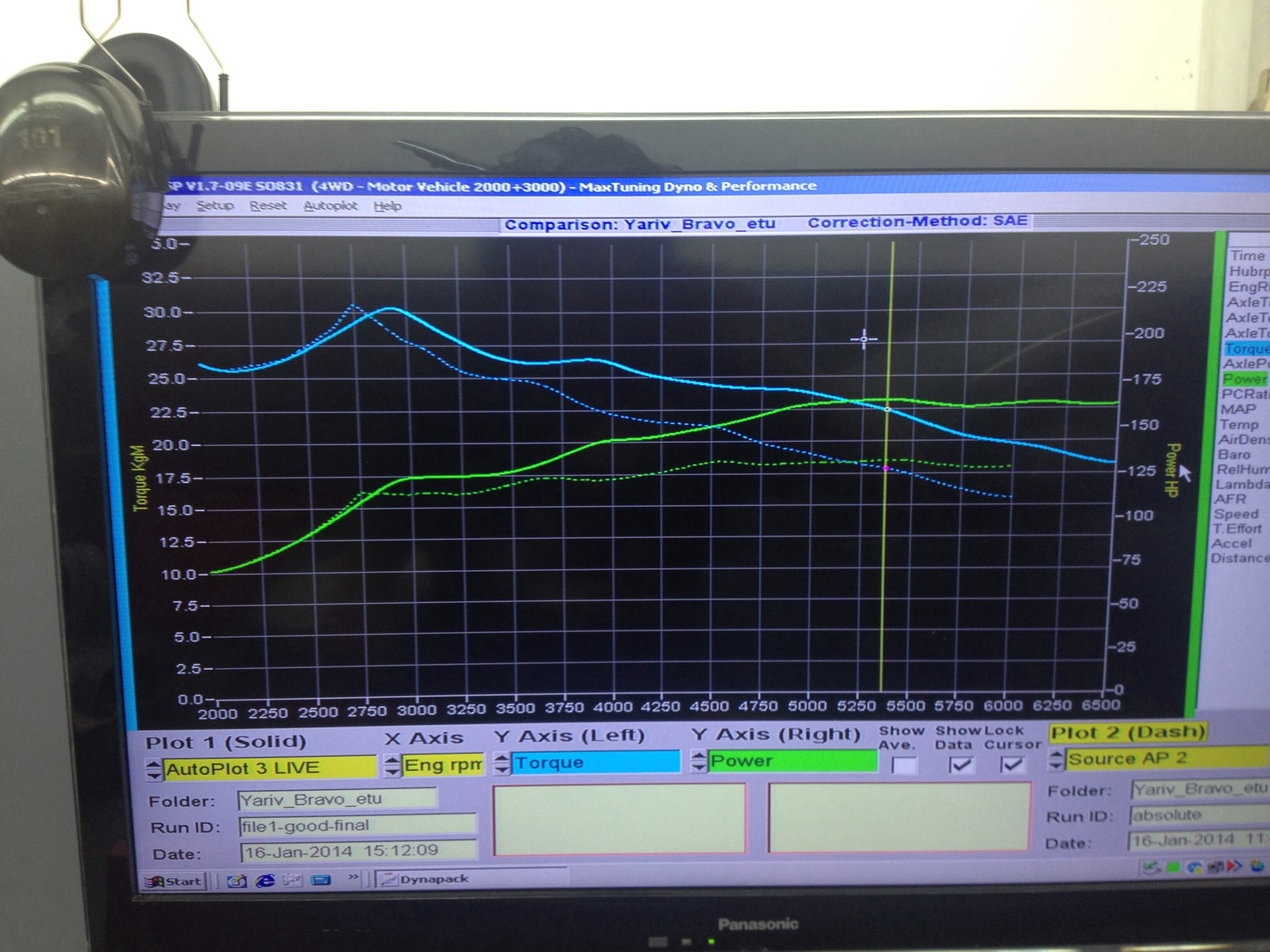

haven't post here for long time.
I just finished my last remap.
My setup for the remap:
IHI VL38 - an Abarth 500 turbo
4 bar fuel pressure regulator.
Full custom pipe : 2.5" of downpipe, central and cat back.
Using "Max Tuning" dyno and software from etuners.gr (Stelios) :worship: we have succeed to achieve the following results.
http://www.etuners.gr/en/index.php?s=1
AFAIK Fiat (and most European car makers) advertise the power at the wheels..so that would be 120 at the wheels.
Still a very good improvement. what petrol do you now run in it? is it still ok with 95 octane?
