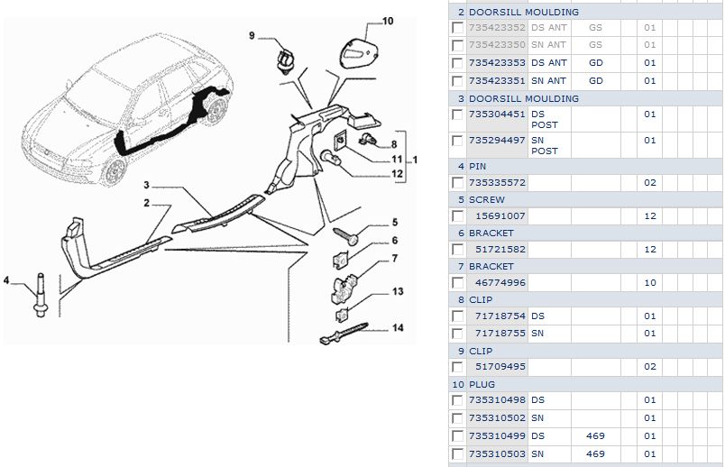

The clips are different for right and left. In Phil's link to ePER above:
http://eper.fiatforum.com/eper/navi?...OD=0&DRW_NUM=5
It shows two part numbers for item 7, i.e.
71719952 DS = Destro, Italian for Right.
71719953 SN = Sinistro, Italian for Left.
