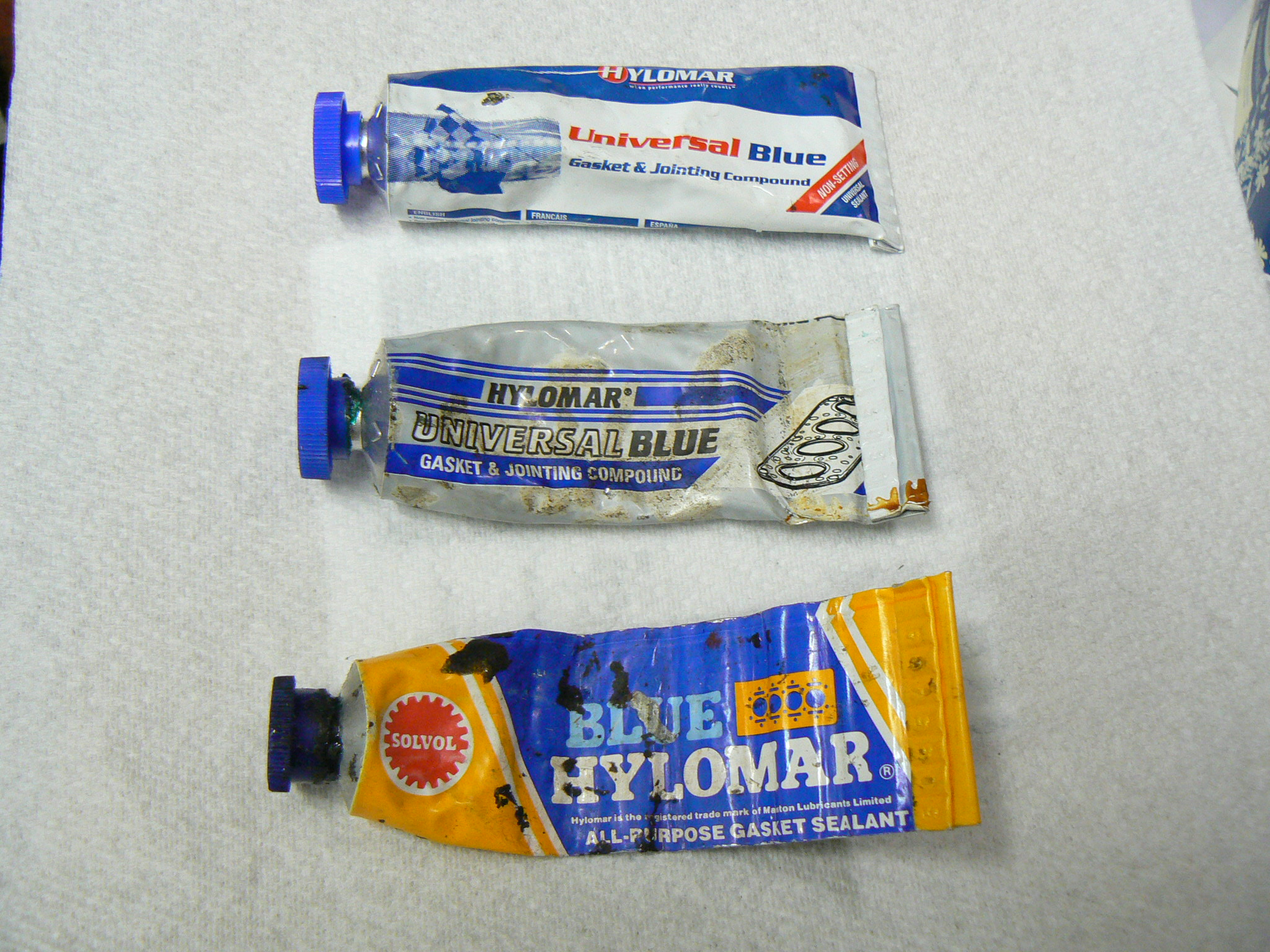

Back in 2005, I bought a syringe type pack of Loctite 518 anaerobic sealant. Not cheap but it's only just running out. It's fantastic stuff and can be used as a gasket replacer, gasket glue and even to support for O-ring joints. Ive never bought any of the old types ever again.
The original Hylomar was developed by Rolls Royce I believe used on WW2 Merlins. They now have a full range including the anaerobic gasket replacers.
Same "story" I heard. Good stuff though, I used to use it a lot. In fact, I've just had a look in my sealants box and guess what?
I don't know how old the oldest one is. In fact I probably should throw the two nearly empty tubes in the bin - must remember I've got that nearly full tube though, I could have used it on the thermostat gasket, possibly better than the silicone sealant I actually used.
