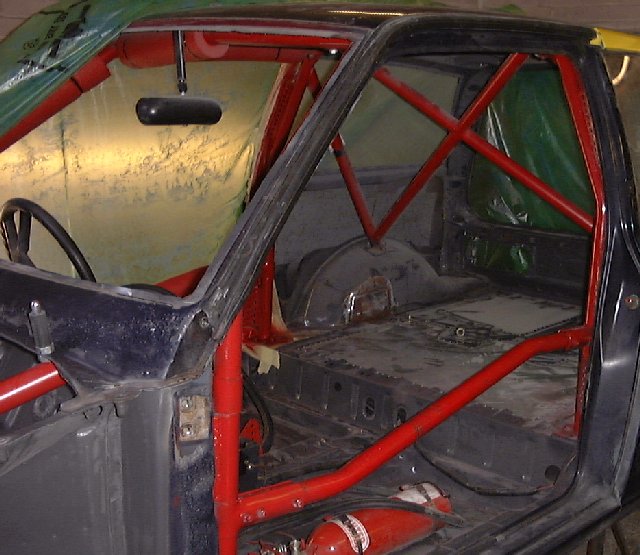

Unfortunately the photos that I have of the rear axle are a bit rubbish as the car was sitting on flat tires when I shaw it. However, I do have a selection of photos of the car from when it was built about 15 years ago...
Side view before it was converted to LHD. (all Trevor's cars are left hookers)
The engine is from a y10 gtie running a massive turbo. Unfortunately it died whilst going round Goodwood so will come to me with an empty engine bay.
Hope these give you some ideas (y)

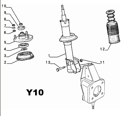

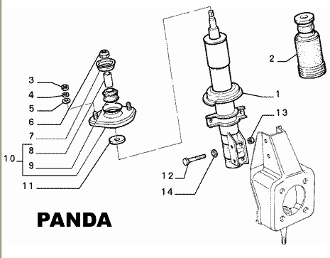

Unfortunately the age old problem is that the front shocks and steering racks on Y10s are different from Pandas so they won't fit. I haven't tried myself but I am sure there are a few on here that have tried and unfortunately failed (n)
Y10 has got an arm welded to the bottom of the strut and the Panda has a bracket half way up strut. I think this basically covers it:
Cheers Lewey
Now looking back at the pictures Dave put up can see the diffrences :doh:

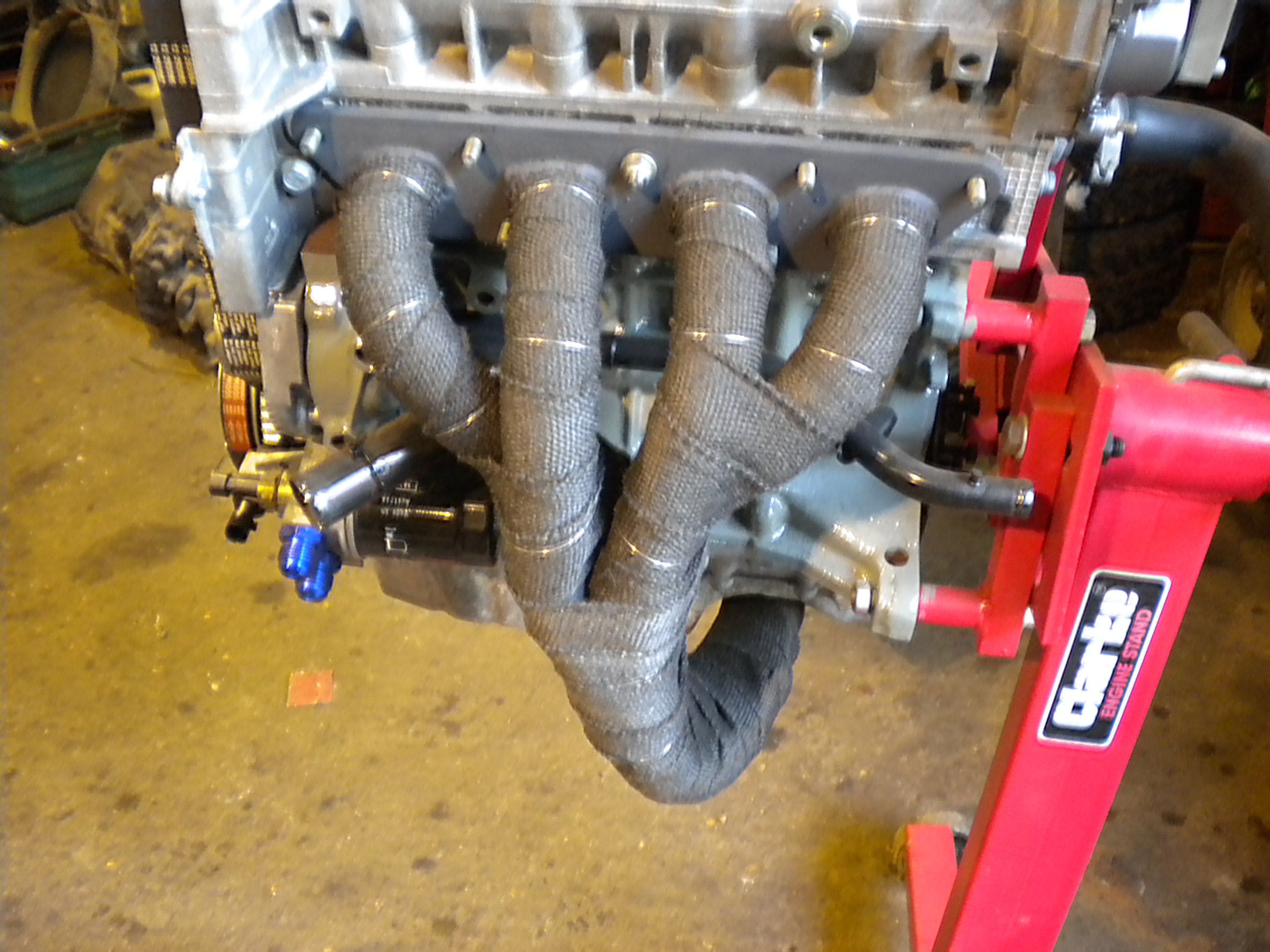

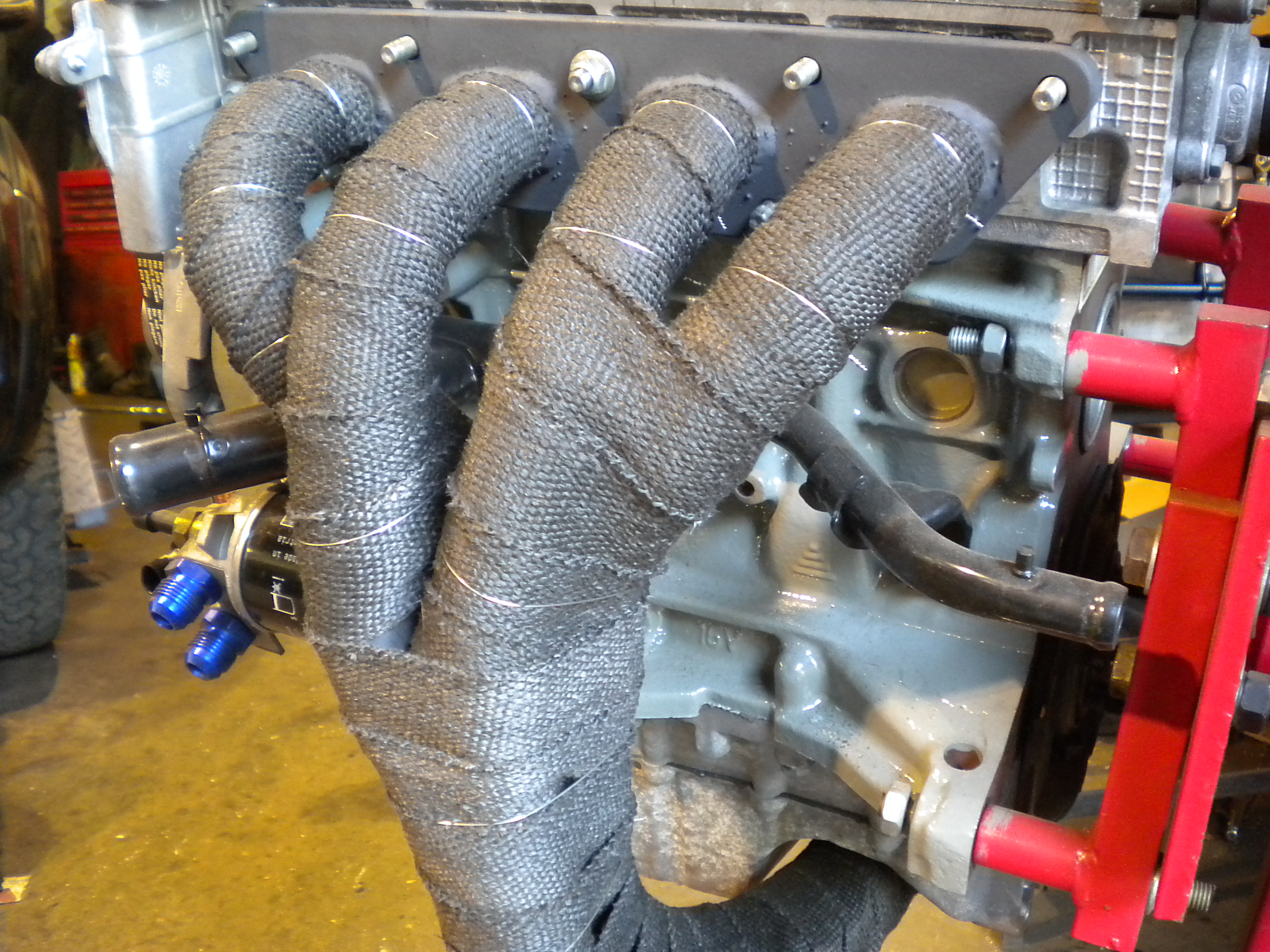

Heat wraped the exhaust manifold think it looks alot more profesional and helps with under bonnet temps :)
Anyone wanting to heat wrap there exhaust would recommend firstly having the manifold off the car as don't think it would be possible to wrap on the car well not easily anyway.
Alot of people recommend wetting the wrap but I have found the best way is dry however do wear gloves as it's itchy stuff. I have used c.v boot clips in the past but used stainless wire this time that worked well but very easy to overtighten and break you've been warned:D
You need to set aside atleast a good hour and a half to wrap a four branch manifold it's not hard just time consuming and take your time you'll be fine (y)

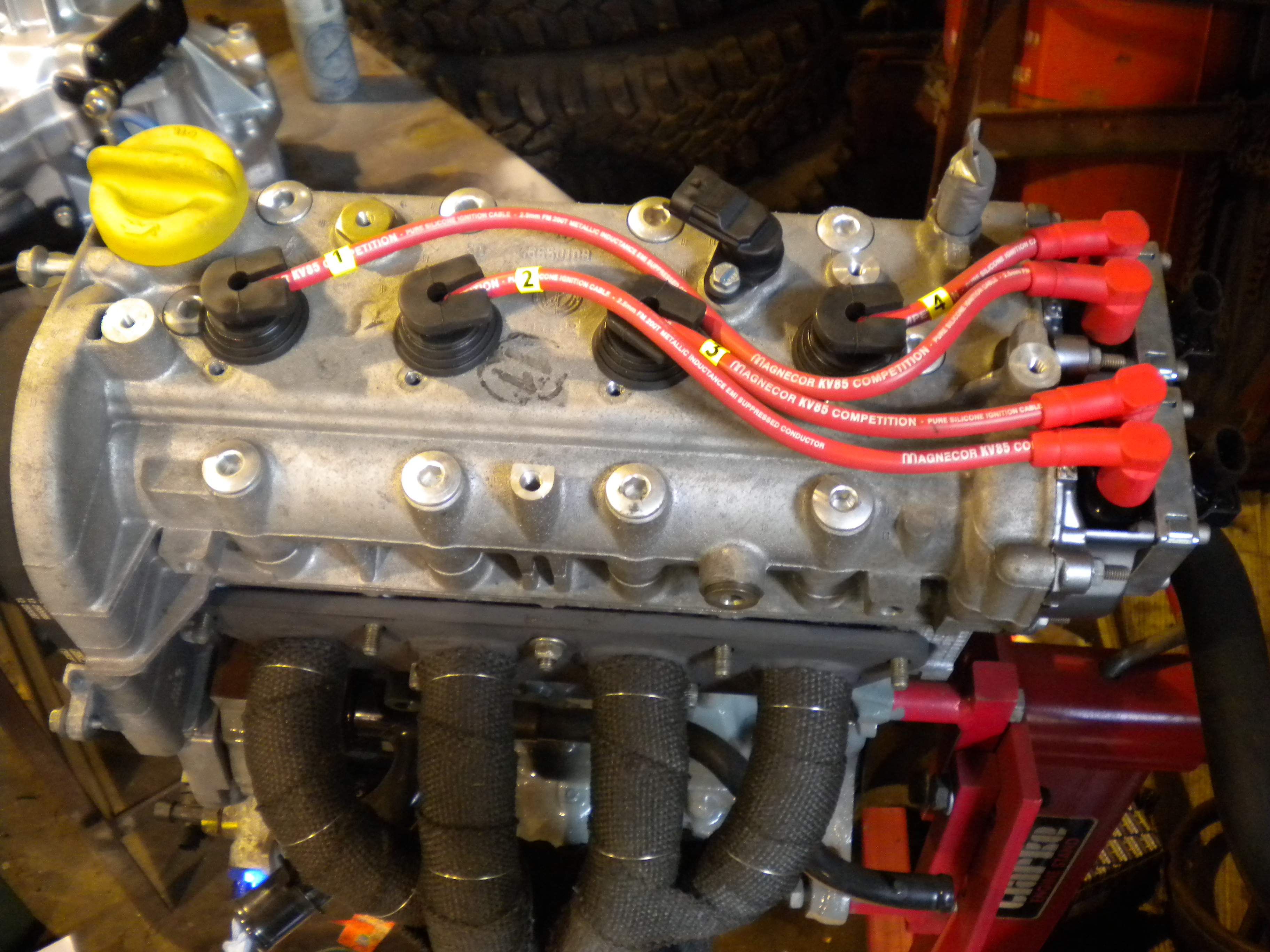

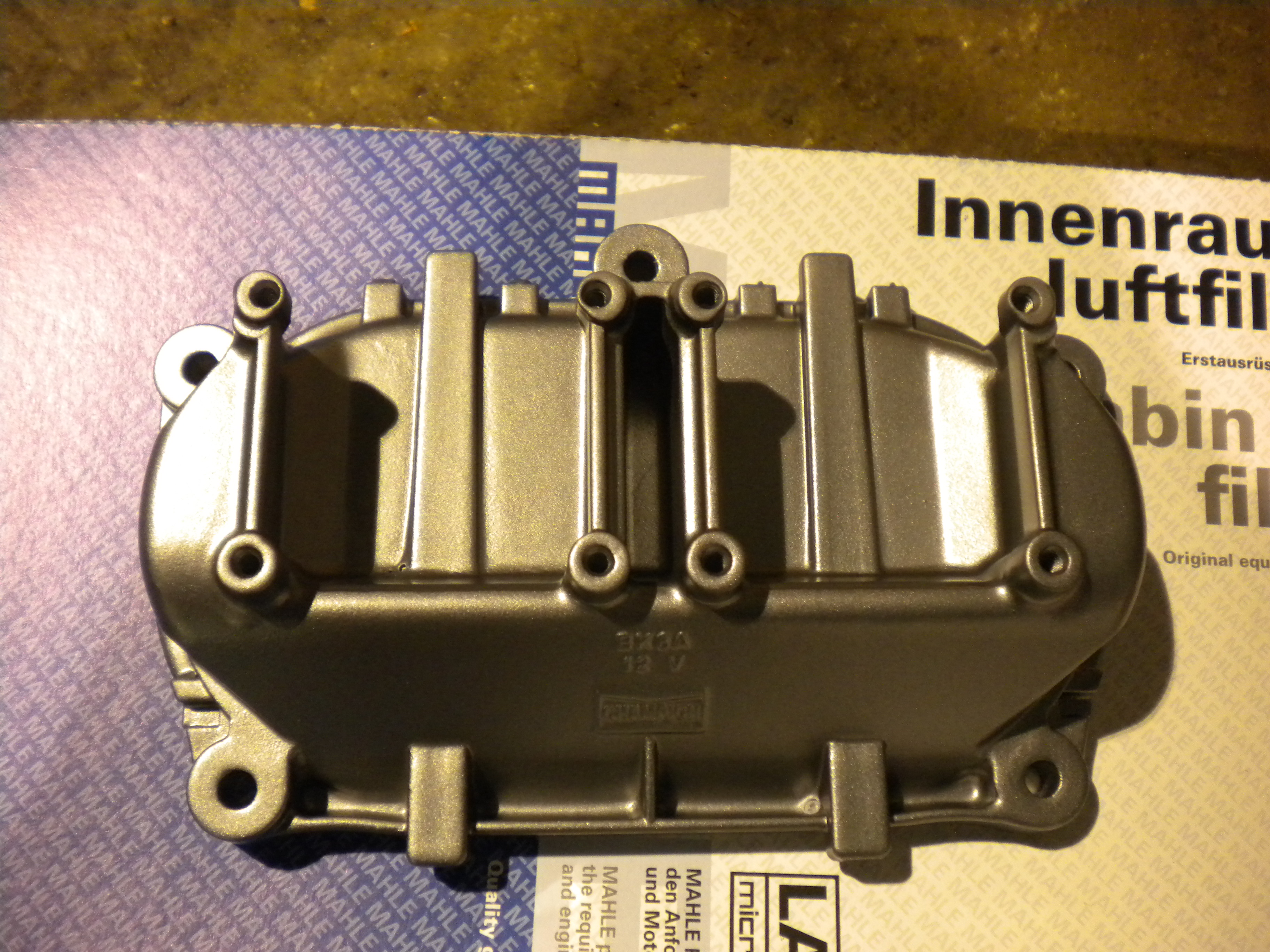

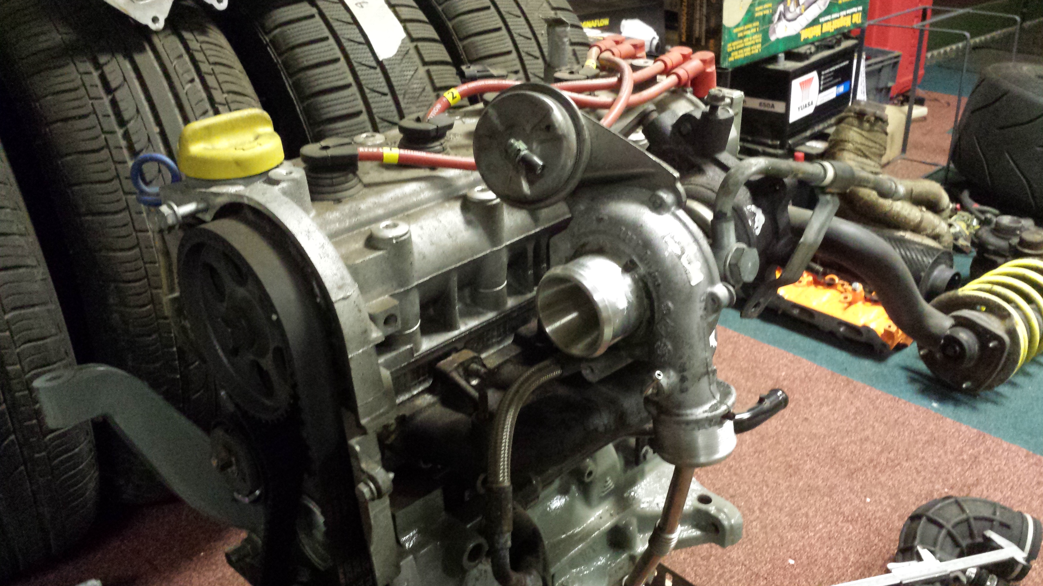

Also found time to paint spare 1.2 16 valve cam gear cover as have decided to convert the 1.4 from individual coils too a wasted spark system as used by the older 1.2 16v punto engine . Fitted painted cam gear cover along with new coils and a set of 8.5mm performance plug leads another step closer

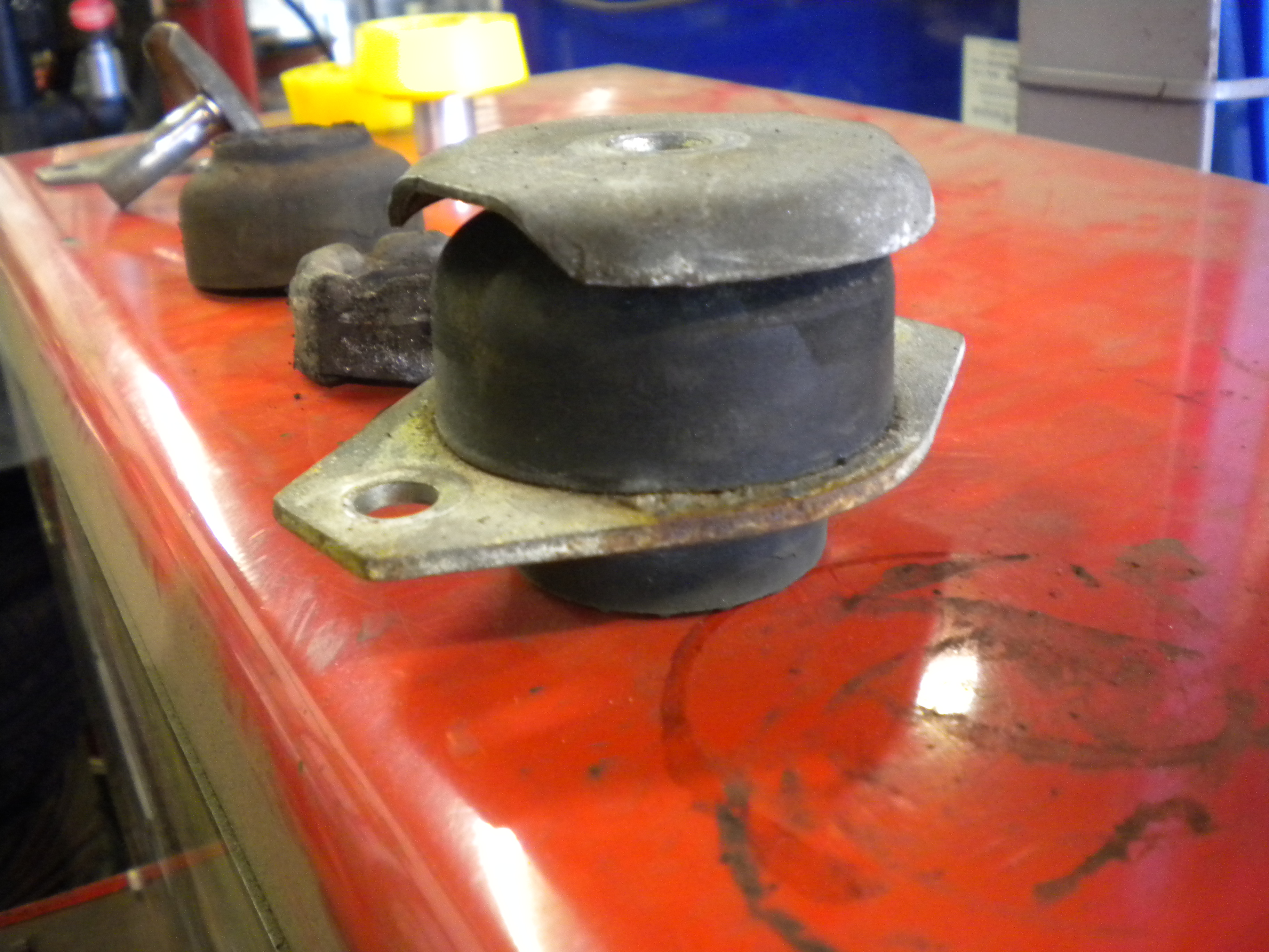

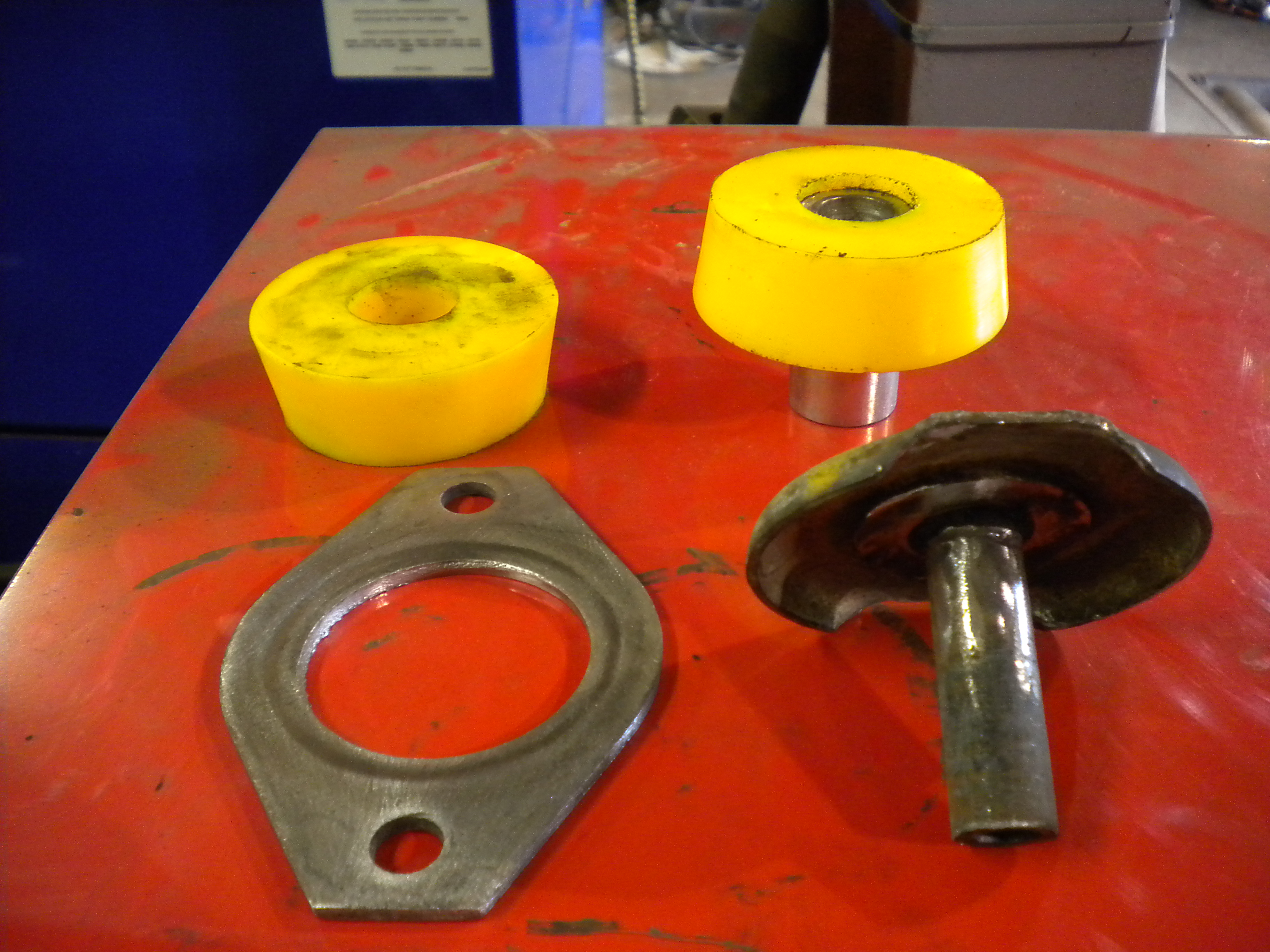

Next job on the list was poly engine mounts obvouisly you can't just buy a set for a Panda well not that I can find . So decided to cut up the original mount and make my own using a Landrover rear radius arm poly bush still need to paint the brackets and bond the bushes to the metal parts isn't exactly the same size about 5mm deeper but shouldn't cause a problem .
However will need to either enlarge the hole on the mounting brackets as the bottom bush is a bigger diameter or will need to work out a diffrent lower bush:confused:

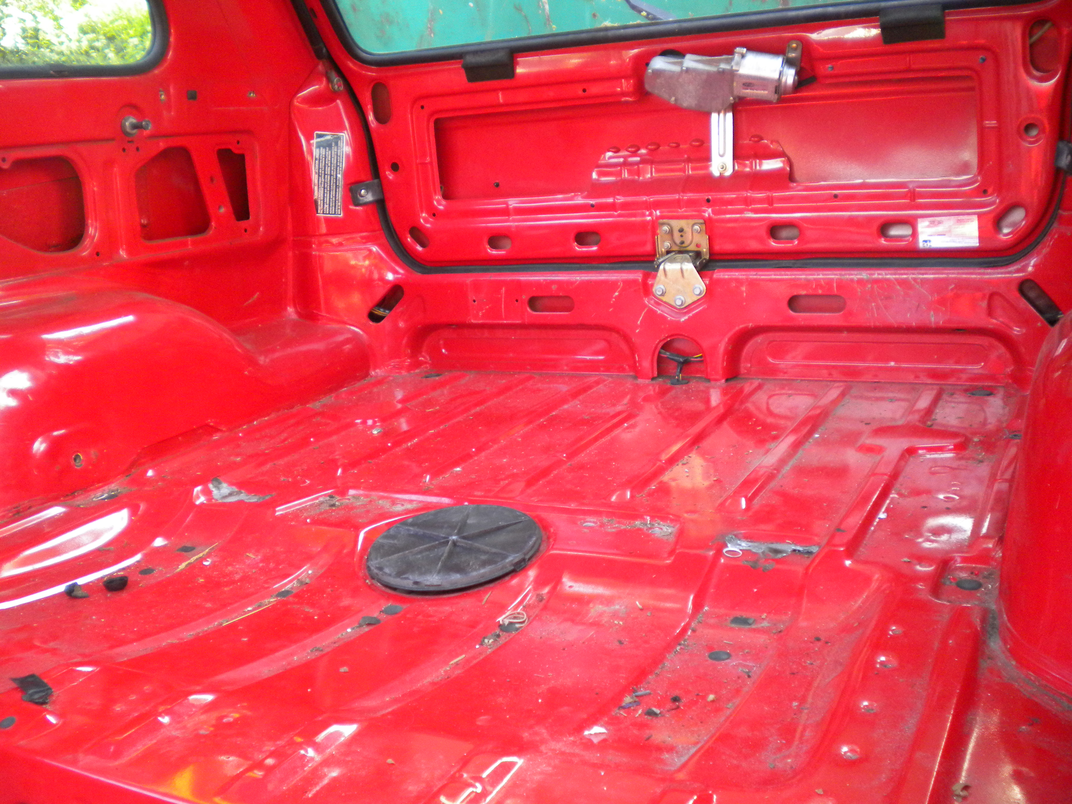

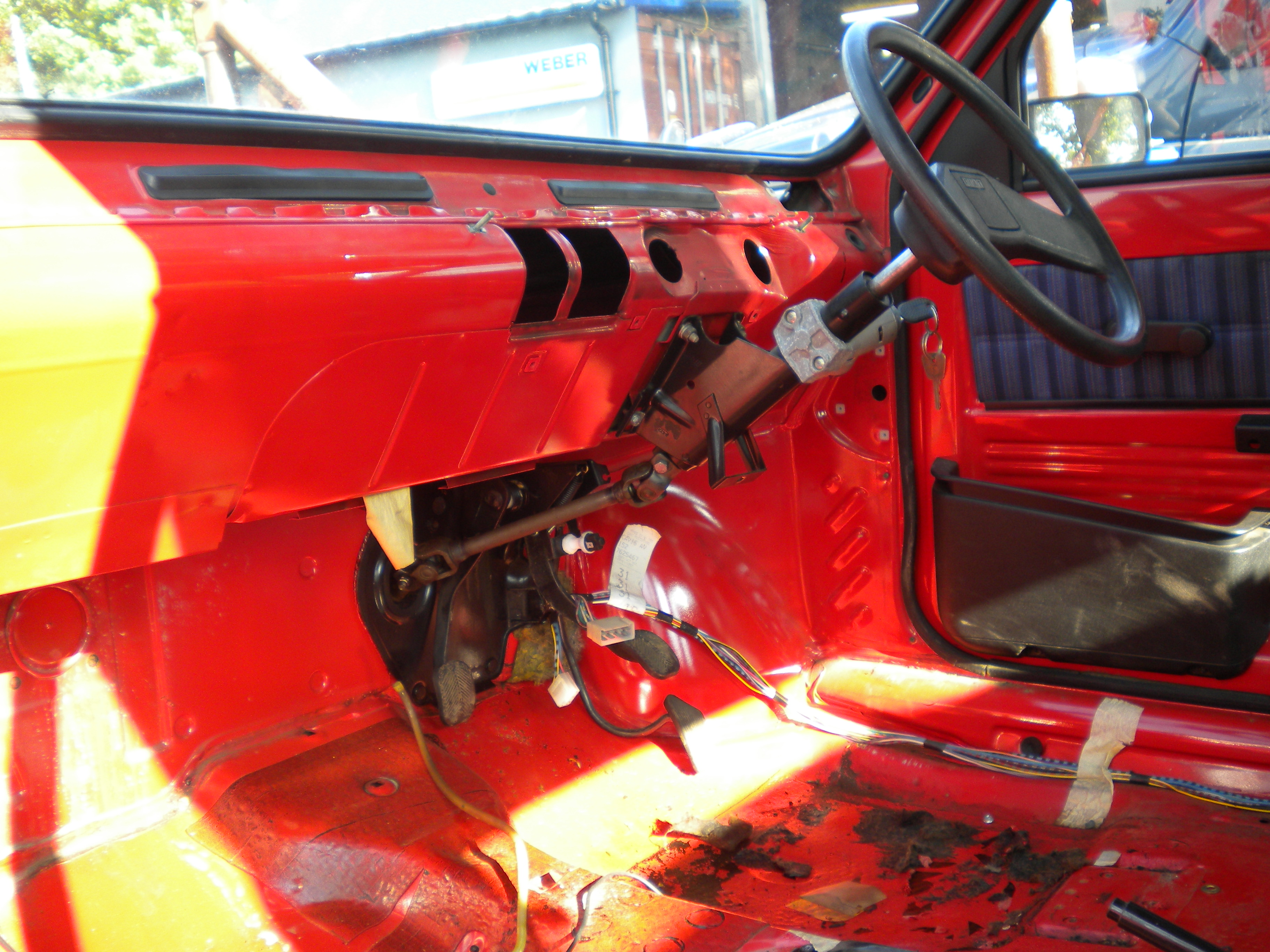

Rest of the pictures show the shell now down to almost a bare shell will be stripped bare in preperation for the fabrication and paint work next job is to make a homemade car spit and get it in the shed:slayer:

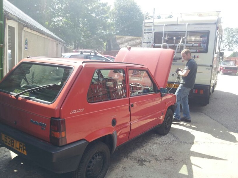

Hi Mike,
Since you have been a bit busy on your holidays.
I thought I would share a few pictures from them that I thought everyone might appreciate on here.
As I am sure that it is not often that you see a Panda on tow!(y)
Hope everyone appreciates the retro setup!:D

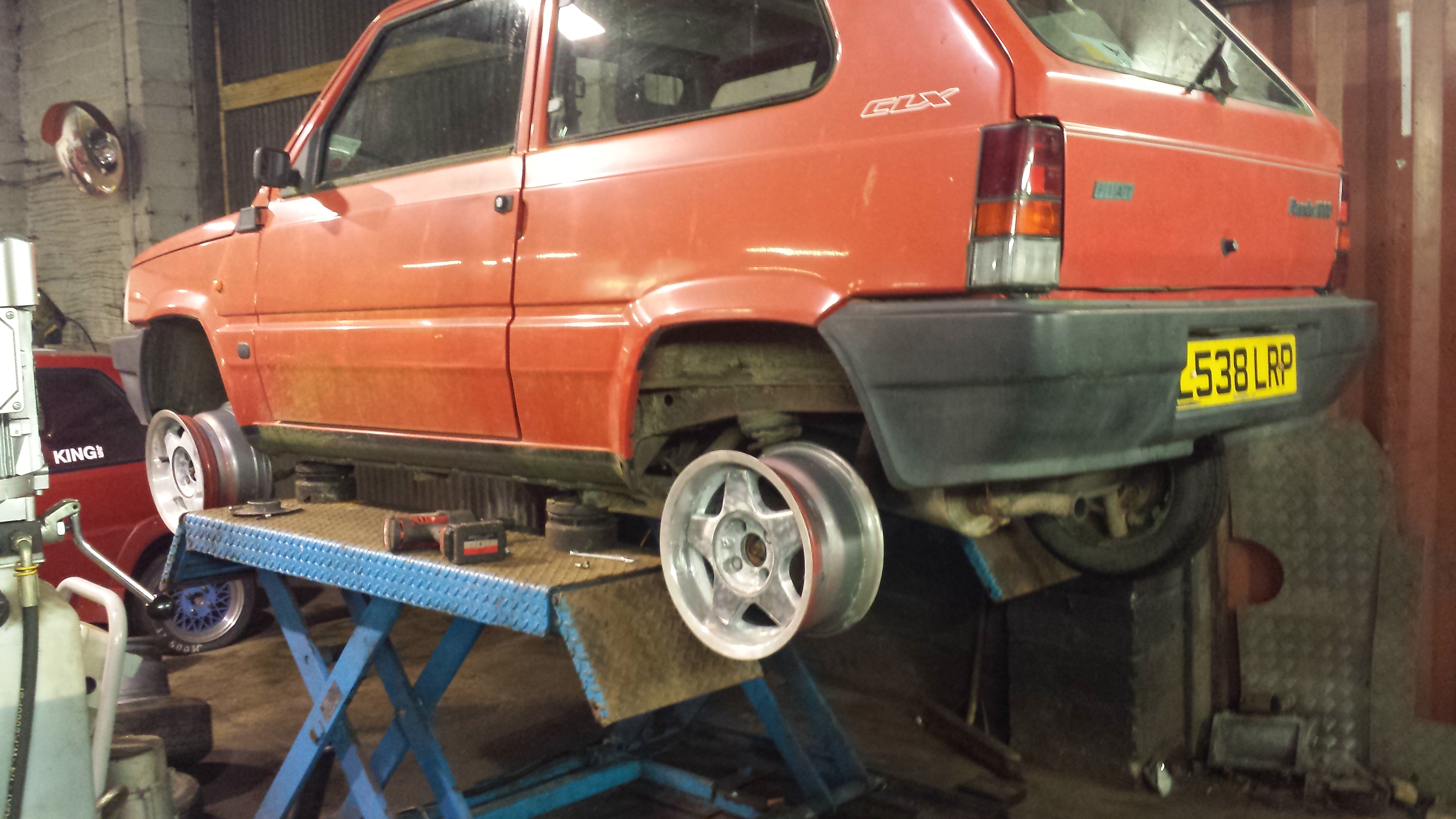

Well it's been a good couple years but im back onto this project . Which has changed slightly now as the original shell I was using ended up under a tree!! Will get pics of it so that put a slight dampener on the project and progress stopped as I was gutted. However I have now decided its time to use the parts to convert the panda clx as seen being towed in the last pictures. This will now be a road car using the same 1.4 16v but with a t-jet vl37 turbo from a 2009 bravo. It will be running low boost due to the higher compression to start with .

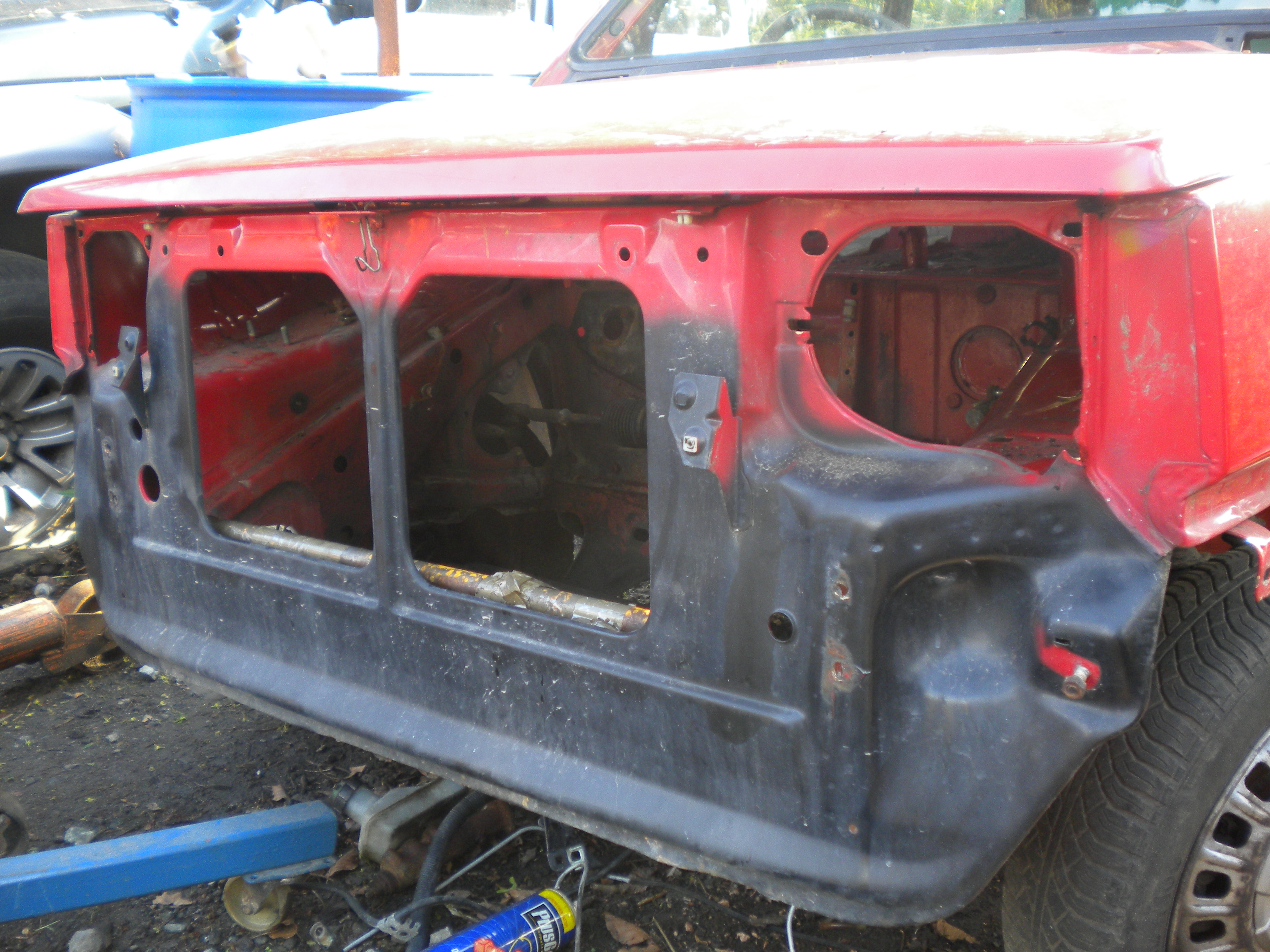

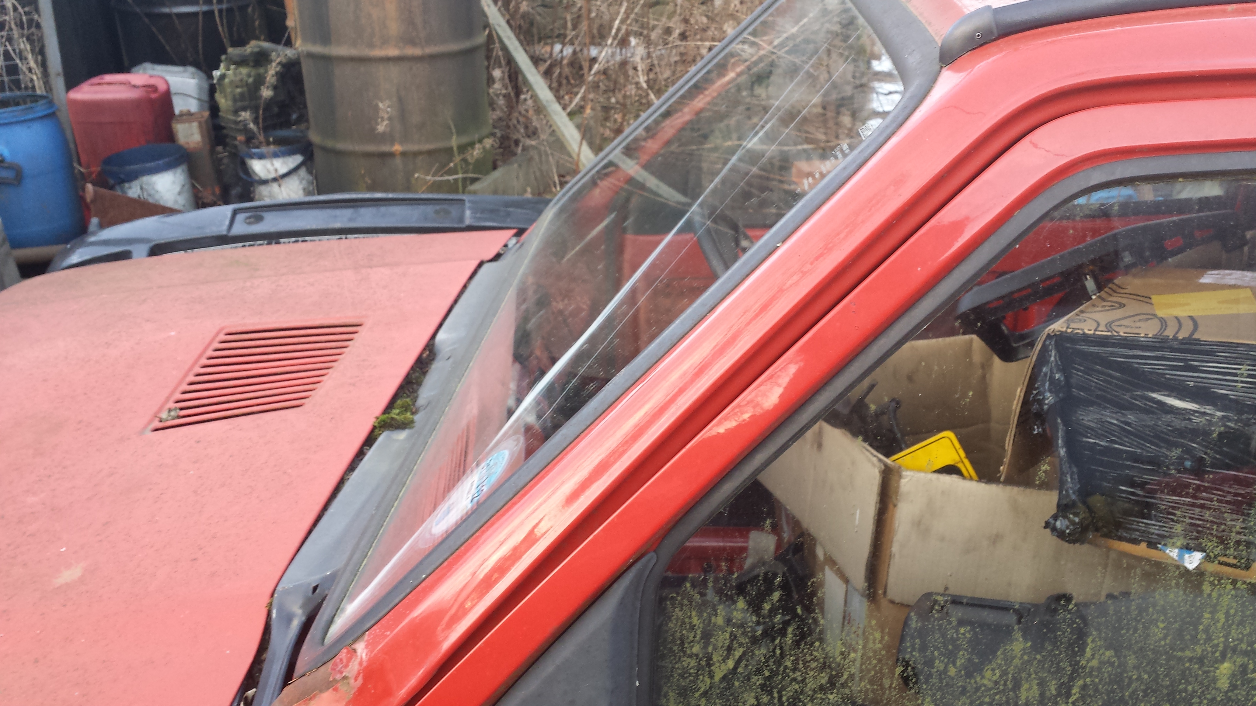

Well here are the pics of the first shell which the tree landed on �?????�
It actually kinked the roof above the b pillar and broke the windscreen

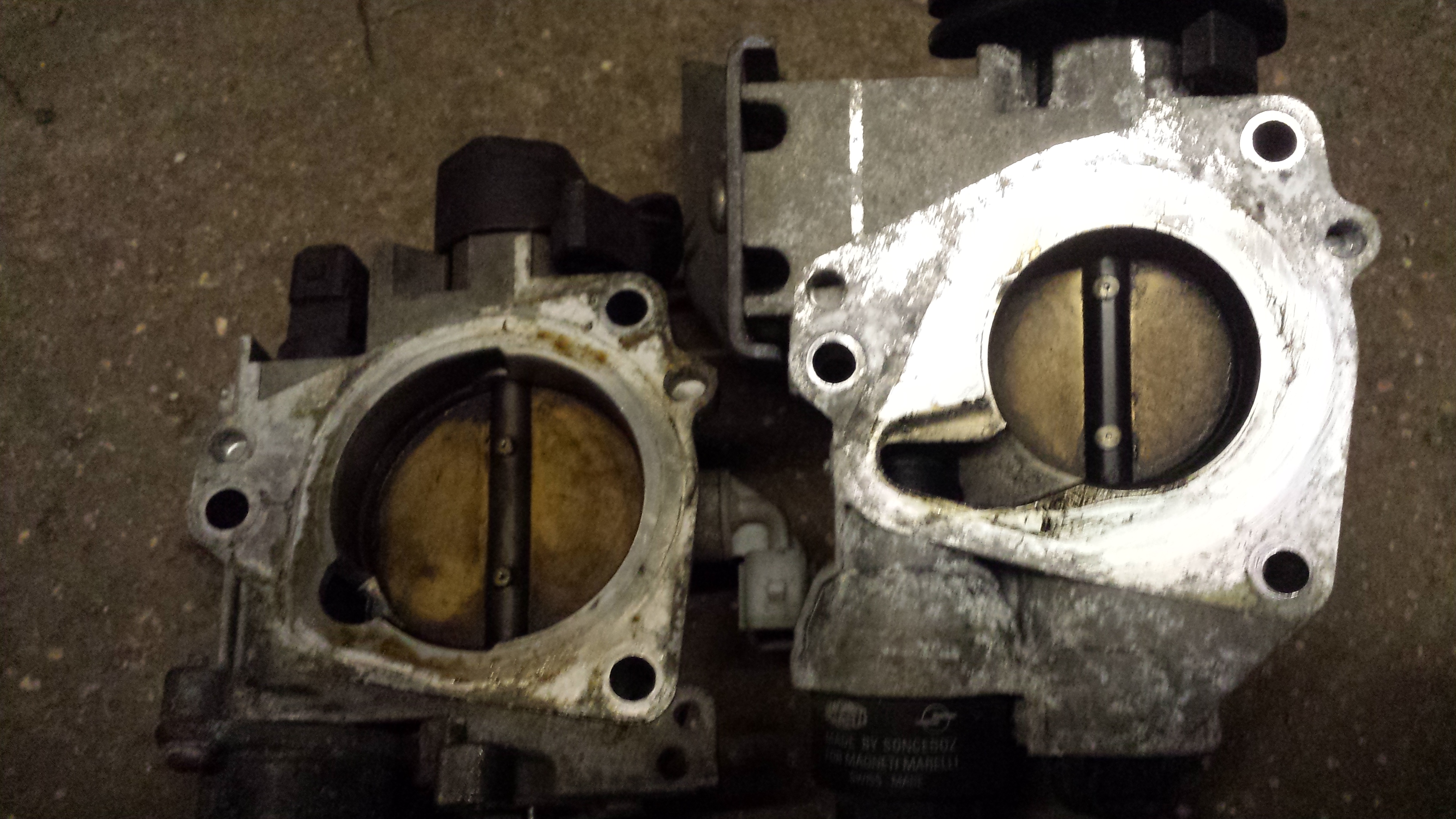

Also had time today to look over the 1.2 16v manifold to see what kind of throttle body I could use as the original 1.2 is tiny!
I searched previous threads which people seem to use larger fiat throttle bodies with custom adapter plates , which I understand when wanting to use the original wiring. However I by luck stumbled across a direct bolt on larger body which if anyone is interested comes from a peugeot 106 gti☺ It uses the same 3 bolt pattern of the mk1 punto 16v manifolds which is handy. I will be making my own wiring loom so shouldn't cause any issues

what size is the pug TB then?? There is a 36mm TB that is on a older shape bravo thats direct swap, actually looks exactly same as the 1.2 TB just 36mm instead - loads on this in cento section.
oil filter housing, i presume you mean does a tjet one fit a normal na 16v engine? not tried but i would bet money that it does.
Ah ok , the pug tb is around 50mm so a big difference just need to make a throttle cable mount but that shouldn't be a problem.
