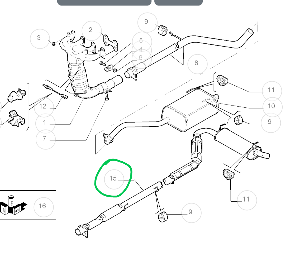

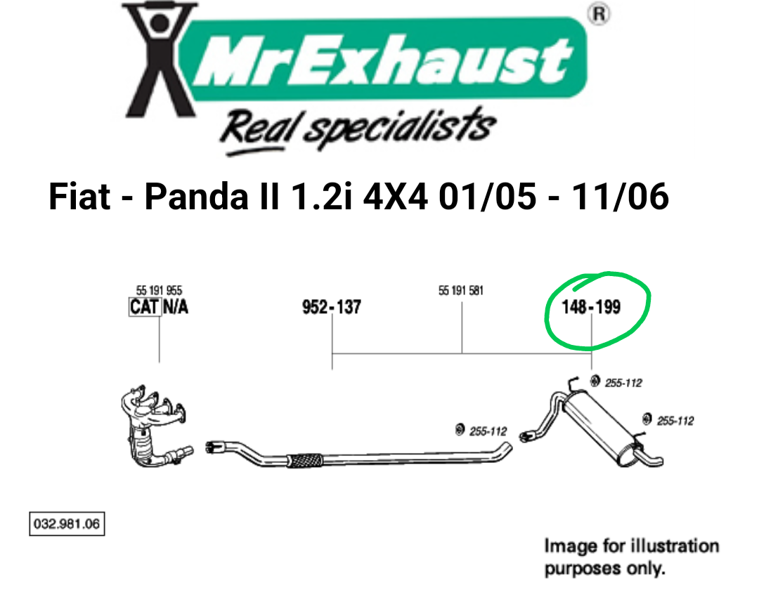

Hi I am new to the forum having just purchased a 2006 Panda Climbing. Looking forward to getting a few bits sorted and taking it out in the wild on Irish roads. I am wondering does anyone have a parts list for these cars so I can identify part numbers. For now I am on the hunt for a full exhaust including all pipes and back box. I can find a Faurecia pipe kit with flexi but still searching for the correct back box. All the ones I see online look too small. Any help would be appreciated. Thanks
55191581 makes no difference but this is the part number for the whole system, not the back box
The back box not available seperate on the drawing
Which is why online sources are using the wrong number
The bosal number is correct though
