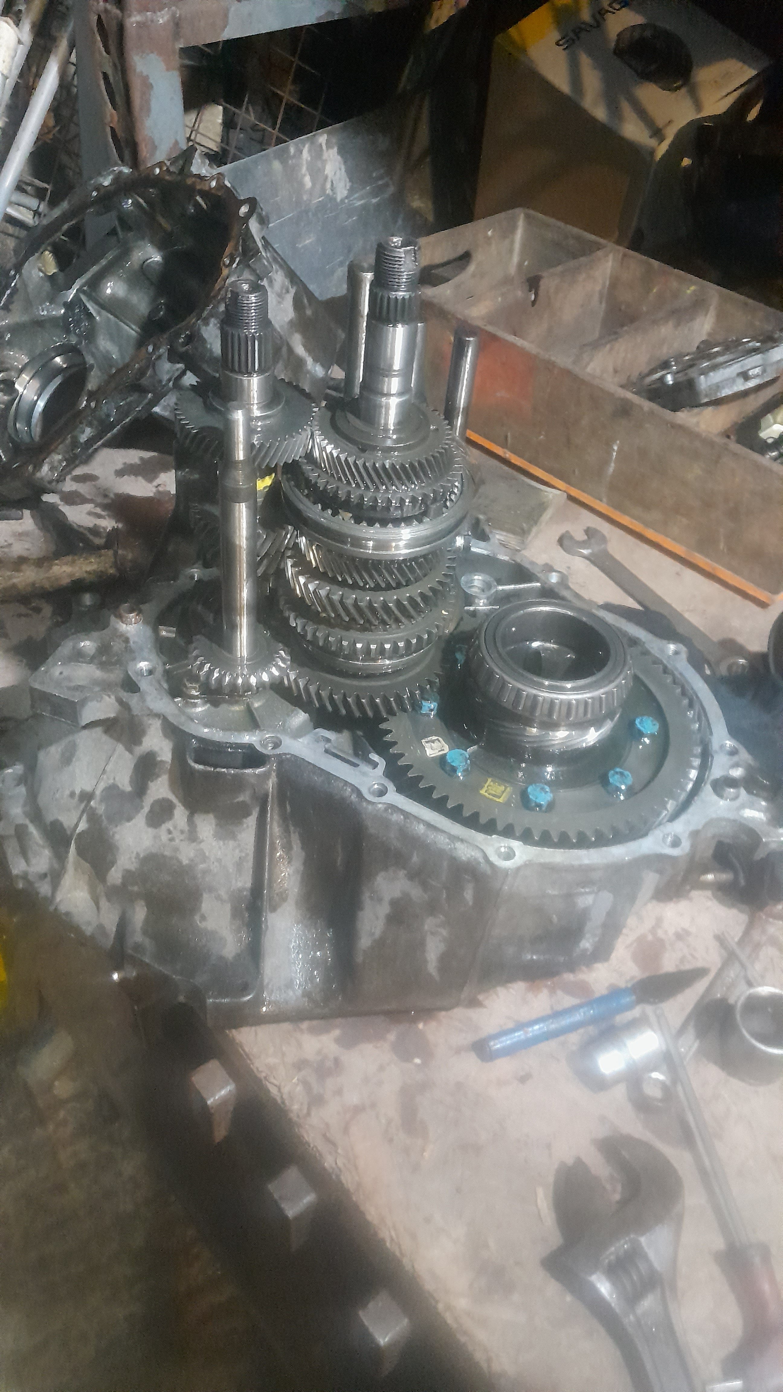

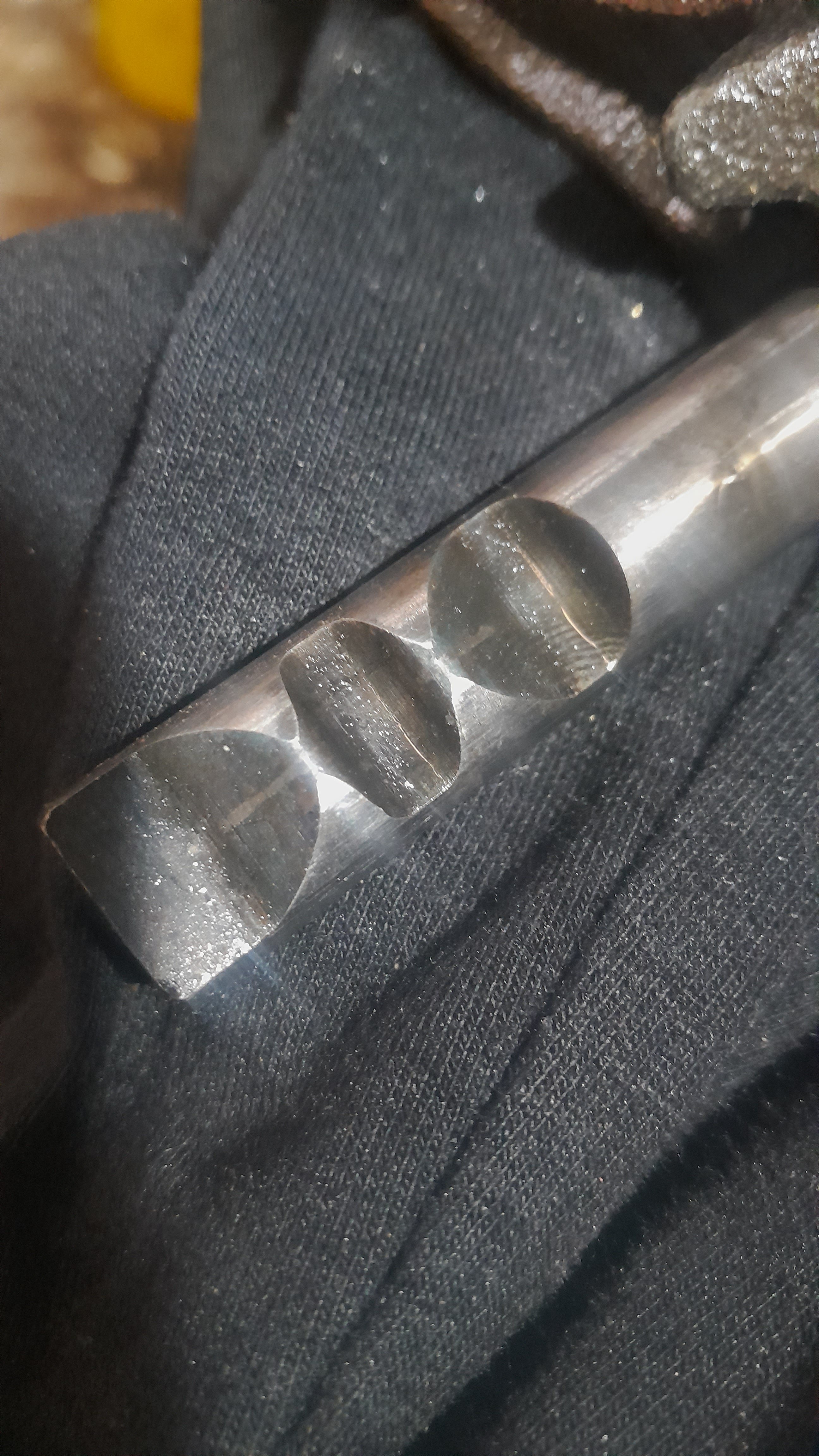

5 years later and i have taken the gear box apart cant find any obvious causes for the clunkyness. The reverse gear is a bit beat up. Some wear on the selector rod indents. Bearings all feel a bit lose in there mounts maybe they are ment to be like that.
Everything seams in decent condition. i had the box out any way to change the clutch
so i had a fwd 4speed box with low miles on hand. i striped it down today to se how the internals compared to the 4x4 5 speed box.
all the bearings are the same, 2 otof 3 selector shafts are the same, gears and syncro for 1,2,3,4, and reverse are all interchangeable, the gear casing and gaskets are the same.
bell housing, input shaft, main shaft, differential and 5th gear parts are different.
the Haynes manual instructions for the fwd are are good enough to work on the 4wd box.
when i had the the parts of both boxes in front of me i could see that the points of the 3rd /4th syncro mesh were worn so i have swapped them out.
i dont think iam going to buy any new parts for the gear box as i am to much of a skinflint and i cant find cheap parts on ebay , maybe in input shaft seal and some oil
