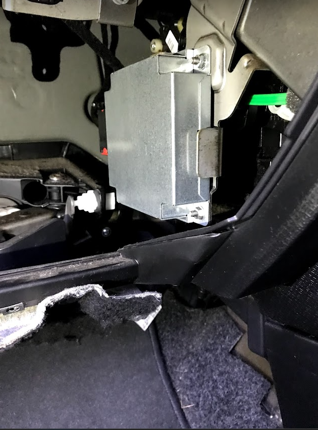

For Pandas here's the radio interface for the head unit; it sits on the centre console - this is with the gloove box removed. I am sure the 2nd hand head unit will power up but until the BCM or ECU has been programmed to recognise it that's as far as you can get (my understanding at least). It can be overcome but you need to "speak" with the BCM/ECU and introduce the new unit via the CanBus system.
