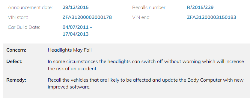

Yes! we had this problem with our 2012 model after is was around three years old...
Driving at night. on turning left ( indicating of course) as the stalk re-centred, the headlights would go off! This would only happen on left turns! Something of a safety issue you'd agree?
Soon after, I saw a recall was raised to fix this, it involved a software update at the main dealer.
The software update was carried out, but on driving home, the headlights suddenly came on and stayed on until the ignition was switched off.
Contacted the main dealer who said they would look into it. They called back and said that a new indicator stalk was now required and they had ordered the part. On replacement of the stalk, no issues ever reappeared.

Not too sure about the stalk assembly. In my case replacing it didn't solve the "headlights always on" issue, it was the second dealer software/firmware update that sorted it. I wonder if the stalk replacement became a bit of a smokescreen to cover up the dodgy initial update of what was ultimately a body computer firmware error on the earliest 2012 on Pandas....
