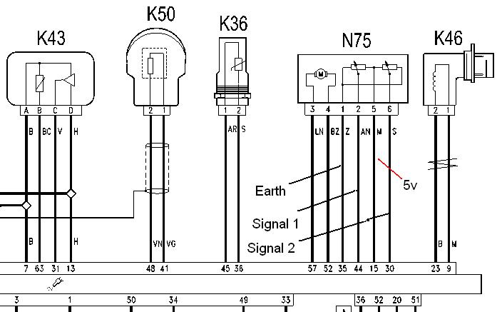

Is it the 5v reference being supplied by the ecu?
Is the 5v getting to the throttle valve?
Is there a poor connection at the throttle valve?

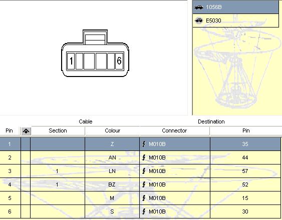

Is something else interfering with the 5v supply eg aircon linear pressure switch, MAP sensor circuit or anything else on the 5v supply

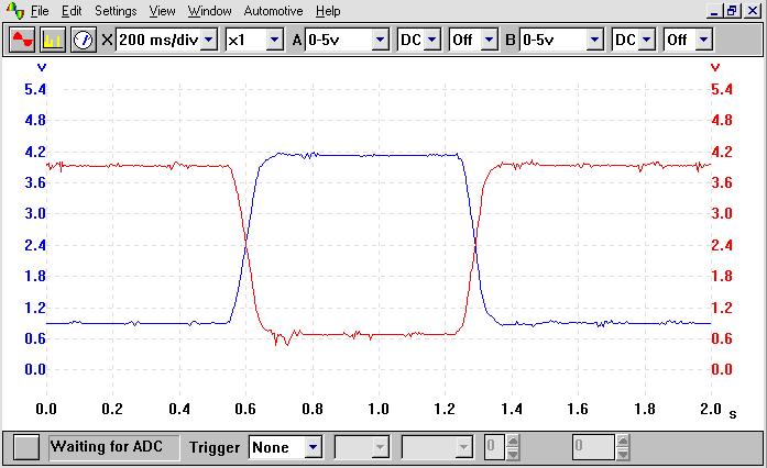

Is the feedback from the 2 Throttle body potentiometers smooth and consistent as the throttle valve opens and closes ?
Is the feedback voltage getting back the ECU?

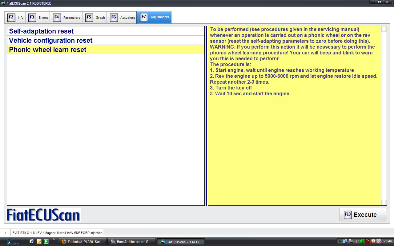

I have changed a throttle body with Self-adaptation reset, Phonic wheel learn reset.
Did you mean you have changed the whole throttle body? You don't have a phonic wheel on a 1.6 so do you mean a throttle valve relearn?

Yes I have changed whole throttle body. FiatEcuScan, there is no function "throttle valve relearn"

Also I made manual procedure of hrottle valve relearn:
Turn the ignition key to ON position (engine off)
Wait 60 seconds, the time required for the control unit to check the throttle body's internal spring and the butterfly's maximum/minimum angles.
Turn the ignition key to the OFF position
Wait 10 seconds, the time required for the control unit to save the learnt values in EPROM.
