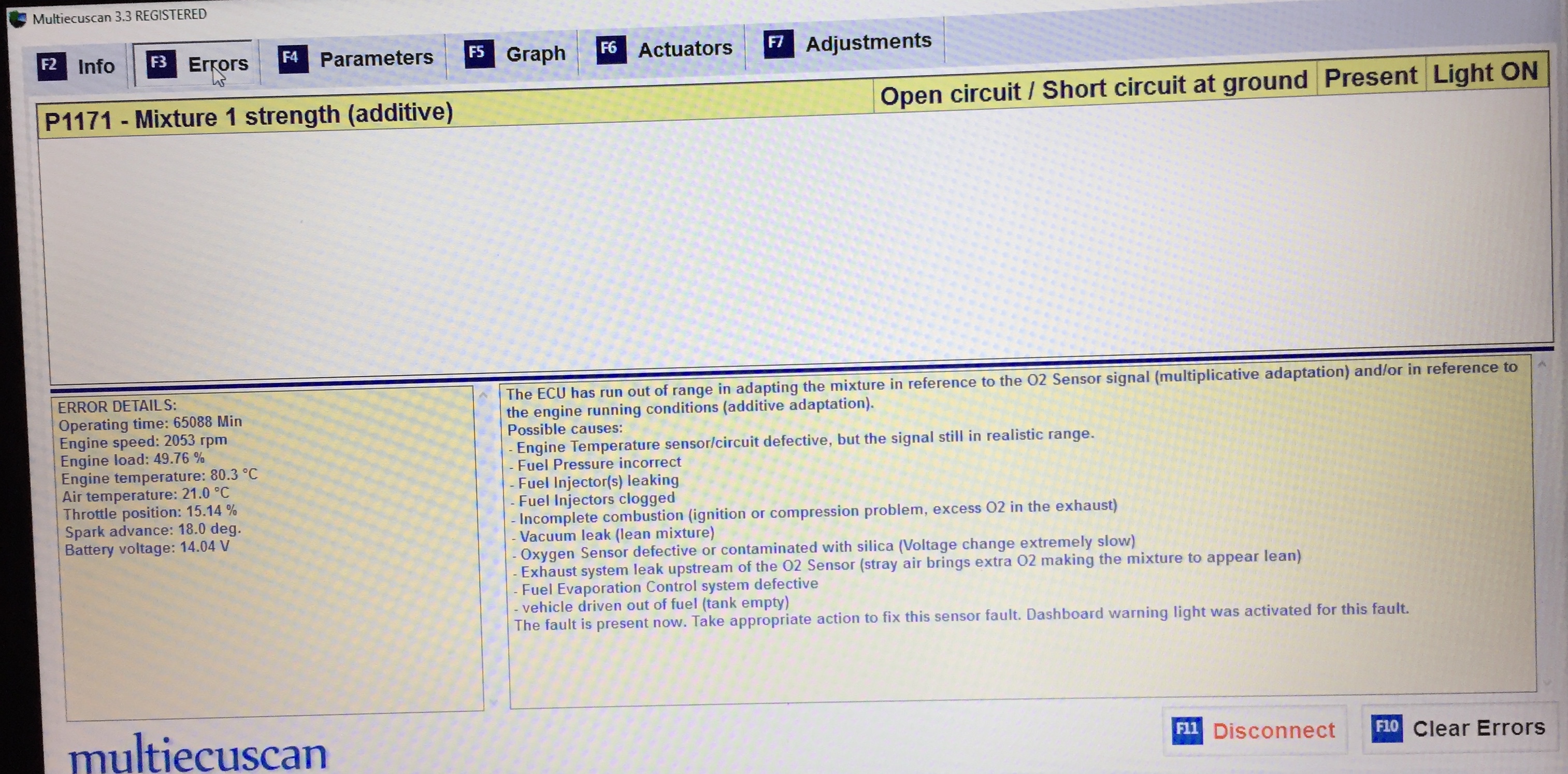

Just found a page of MES highly recommended buying if you haven't got already. Looks like it's worth testing your injectors
Thanks for that Owen, I have heard if MES before, This list is very helpful. I am looking towards injector issue, I am bringing the car to a friend of mine soon who is a master diagnostic tech for VW, hopefully he can shed some light on it, The car is going in for its NCT (irish mot) today. I will knock the light of and go from there, I will update as I go along.
