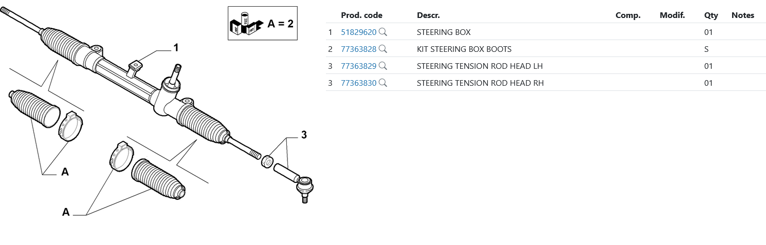

Guys, can you help me?
RHD 2008 1.4 8v.
Just had a MOT. I had the mechanic check my front end to look for anything loose that can be the knocking.
So far I've changed, drops link, front shocks, top bearing, all 3 engine mounts.
The mechanic says the passenger side 'Out tie rod' feels loose, so likely the culprit.
Was looking at ePer for the part number, but don't know my Left to Right.
Would someone be able to confirm which part number I need? LH 77363829 or RH 77363830. Do they read the parts from sitting inside the car or standing in front of the car?
Thanks
Re: left/ right
You read a car from behind.
Thanks. So that would be 'Left' for passenger side for me.
*I checked the engine mount naming convention, and it appears the mount under the battery is 'Left'. 👍🏻
Anyone recommend a tie rod brand or they all about the same? I was thinking toget the 113mm Febi Bilstein part, paying a little more.
