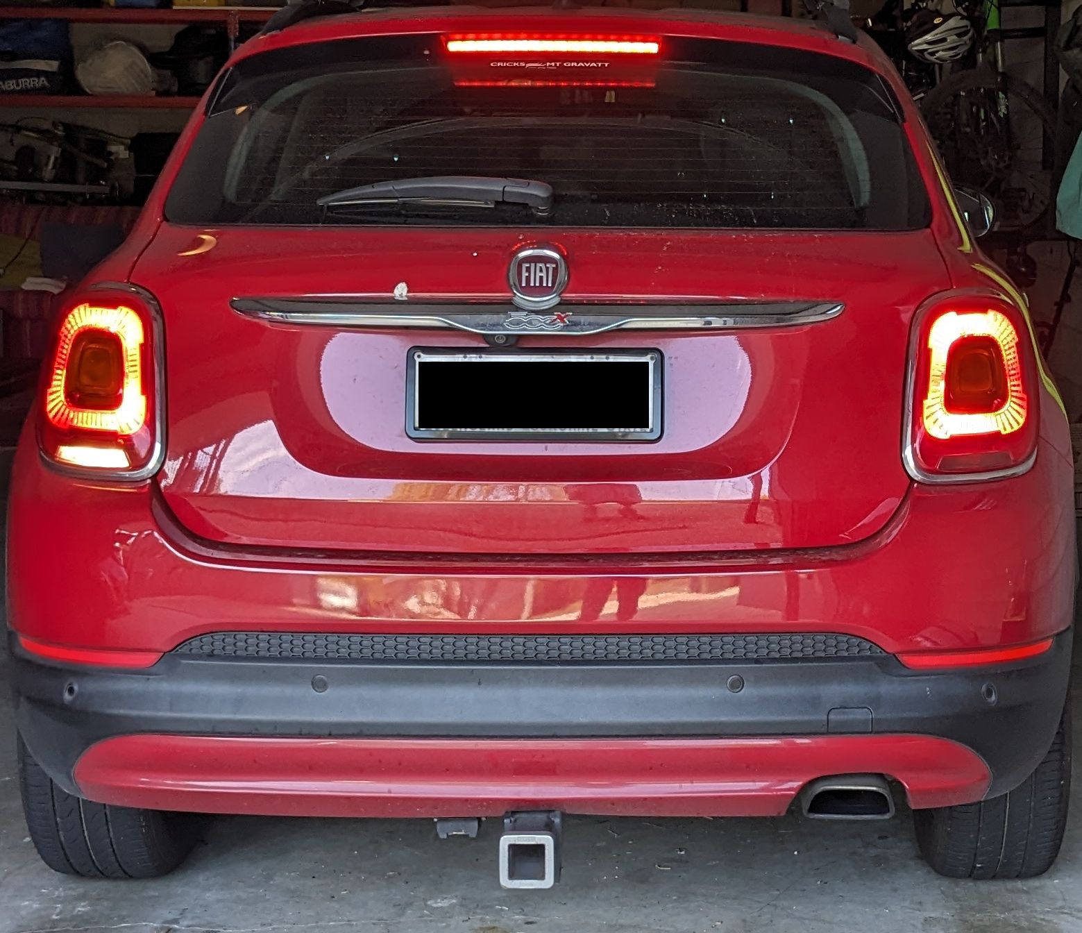

As you can see, the driver side reverse light isn't turning on.
The bulb is fine.
There's no CEL.
The rest of the lights on driver side taillight cluster work fine.
The passenger taillight cluster is fine.

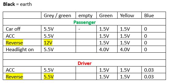

Using a multimeter, looks like the driver side reverse wire (grey/green) does not get activated when reverse gear is selected.
Any suggestions where I should hunt next would be welcome!
Also, surprising that Blue on driver side isn't reading a perfect 0V. I'm consistently getting 0.03V.
Could this be due to my neutral wire repair job?

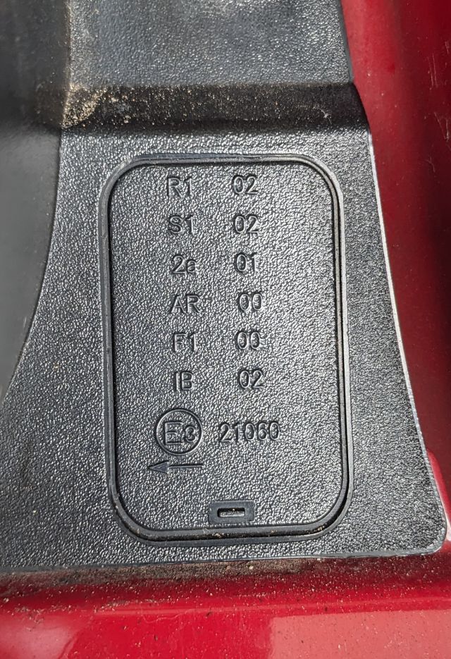

These codes are imprinted on the taillight , what do they mean?
The bulb is fine.
There's no CEL.

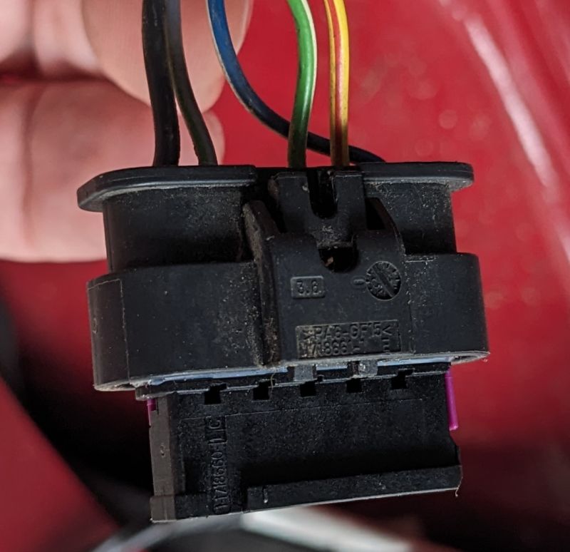

This connection plug is the likely problem. The contacts inside will be faulty , broken or rusted.
Ignore the 0.03V, it's just background reading error

The connector is fine (except for the earth). There is no rust. All pins are shiny. Just no power getting to the reverse light wire....
