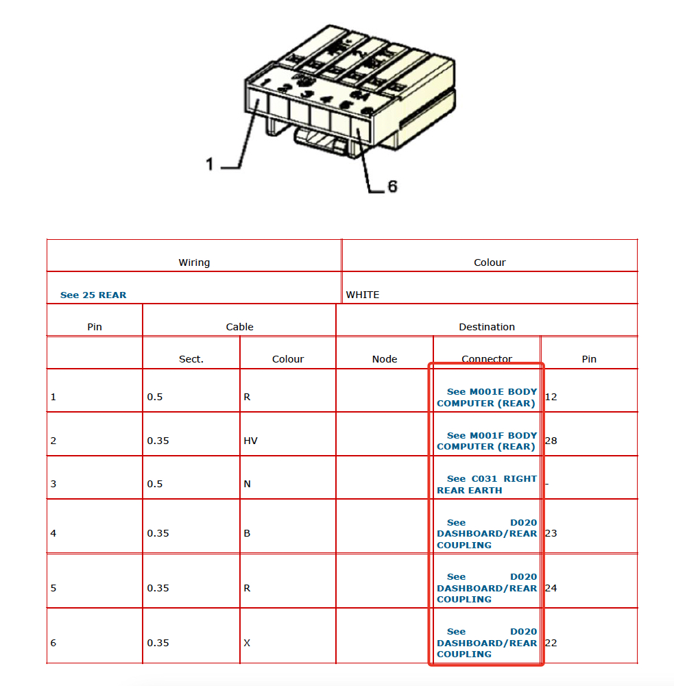

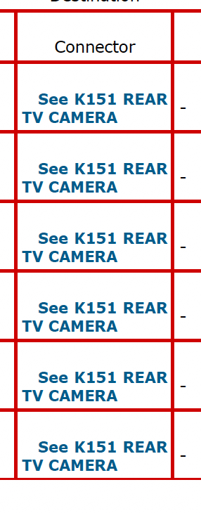

I am looking for a electrical diagram of cables that are attached on the trunk lid, especially diagram for reverse camera socket. This it that cable:
problem that I have is that I changed camera
See attached info
hi, thank you! :)

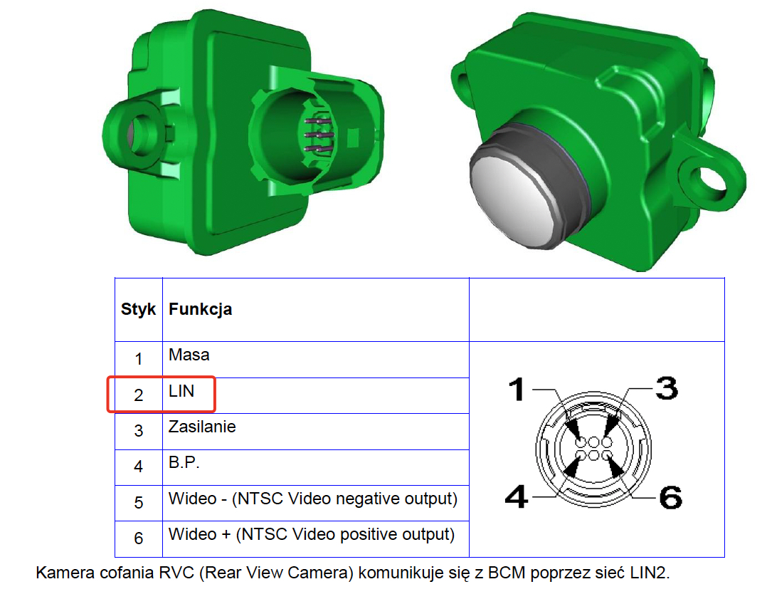

what I can see is that pins on this socket from pdf and mine photo are mirrored, take a look, why? mine is original like that 🤔 can you also send me pdf's of that destination connectors diagrams?
and maybe some color explanation ;) R is red but what about others :D

i have a problem that while connecting LIN pin from camera it's not working, otherwise camera is working but without the lines
morę in this thread https://www.fiatforum.com/threads/reverse-camera-not-working.512411/
don't know if it's camera problem, because it's from different car / model or something is burned somewhere else, the cable that was connected to old camera was burned on pin 2, camera was also not working because of water damage and now I am trying to fix it

The camera connects to LIN2 circuit and not the LIN1.

ok but when I connect that LIN pin no. 2 into camera it stops working with info Camera System not available 🤔 I wonder if it's camera fault that it's from Dodge and sending some different signals or maybe something is burned in body computer or something
