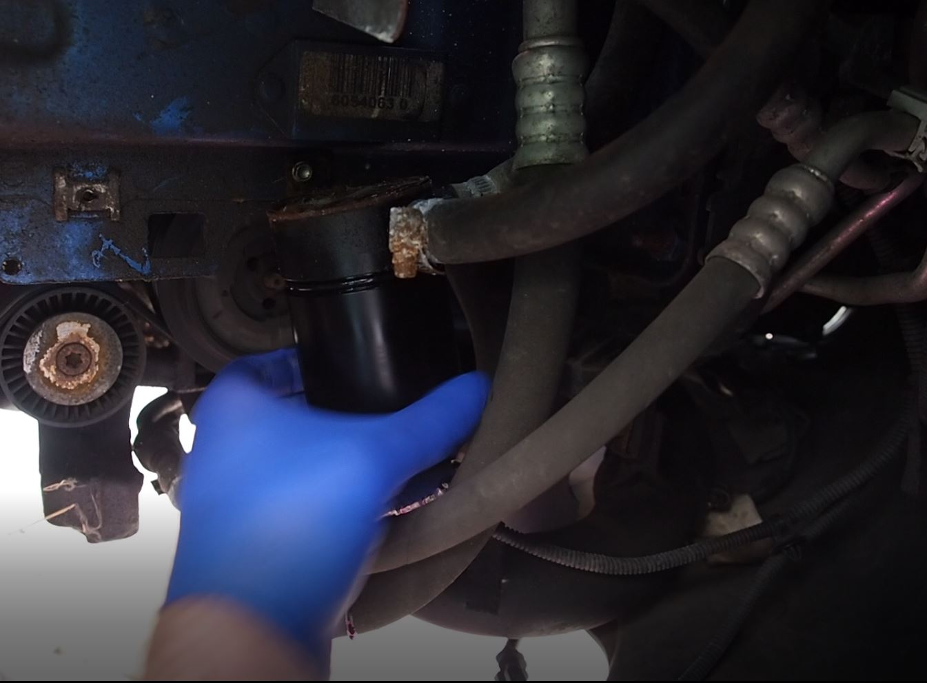

Mine was mounted on the outside of the chassis leg (drivers side here in the UK) see picture below. The pipes to it were at least 25mm if not bigger ( forget now but they were pretty large) obviously the smaller the pipe the higher the chances of it clogging up.
It probably gave a little benifit to my diesel as after 170k+ miles, there was a lot of oil mist in the gases from the crank case. The can was about the size of a normal coke can and it had filled up within about 6 months, and bearing in mind this was not my main car so i was quite shocked by how much had accumulated.
If it were just oil in the can then it wouldn't be that much of an issue, but there is a lot of moisture as well so what accumulated in the can is a grey emulsion of oil and water. I didn't notice any change in the running of the car, and it was a pain in the arse to empty it and check it, so had I kept the car I would have probably just removed it again.
The only catch cans that are probably worth it are the fancy ones that separate the oil out and then funnel it back into the sump.

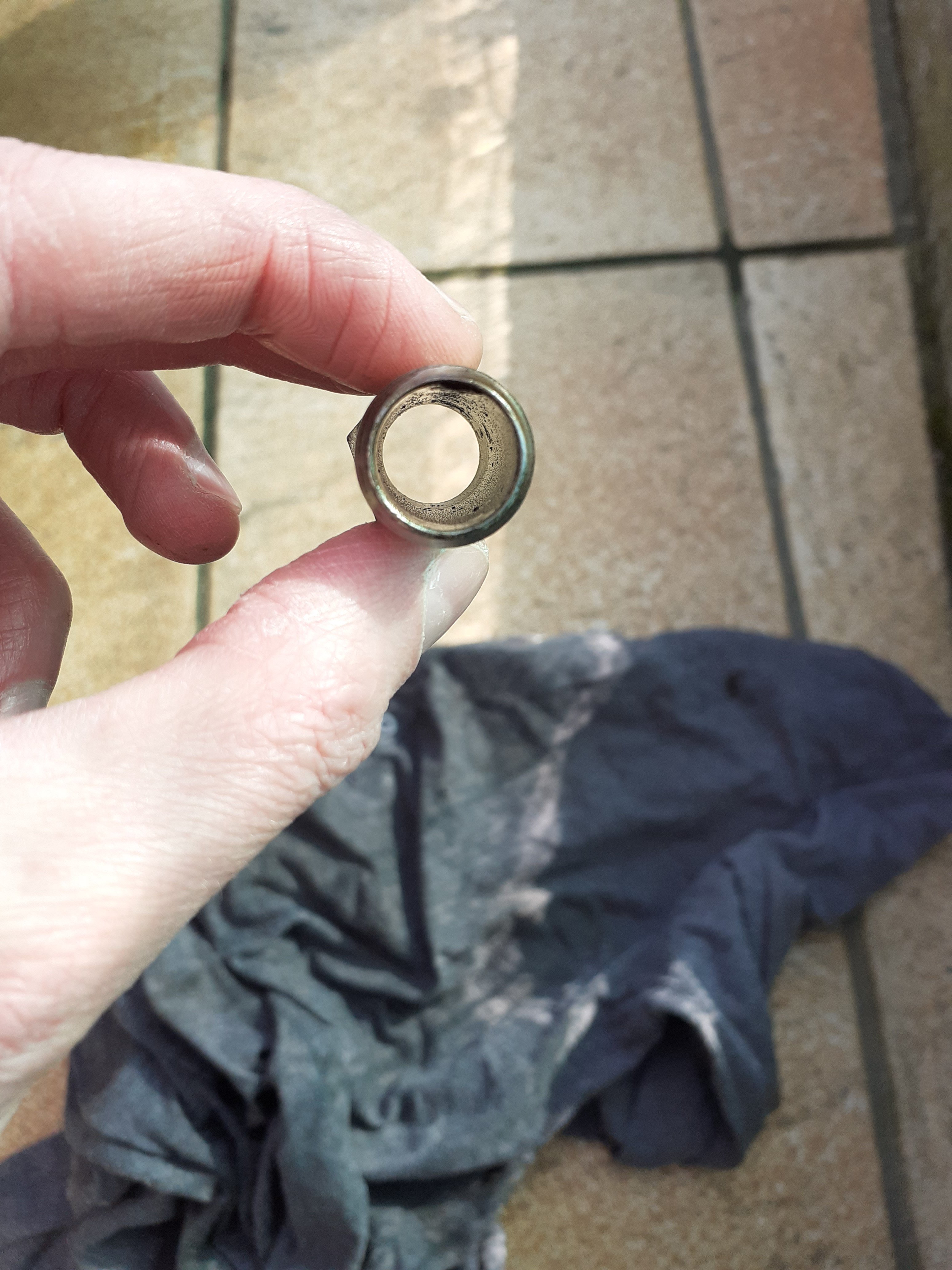

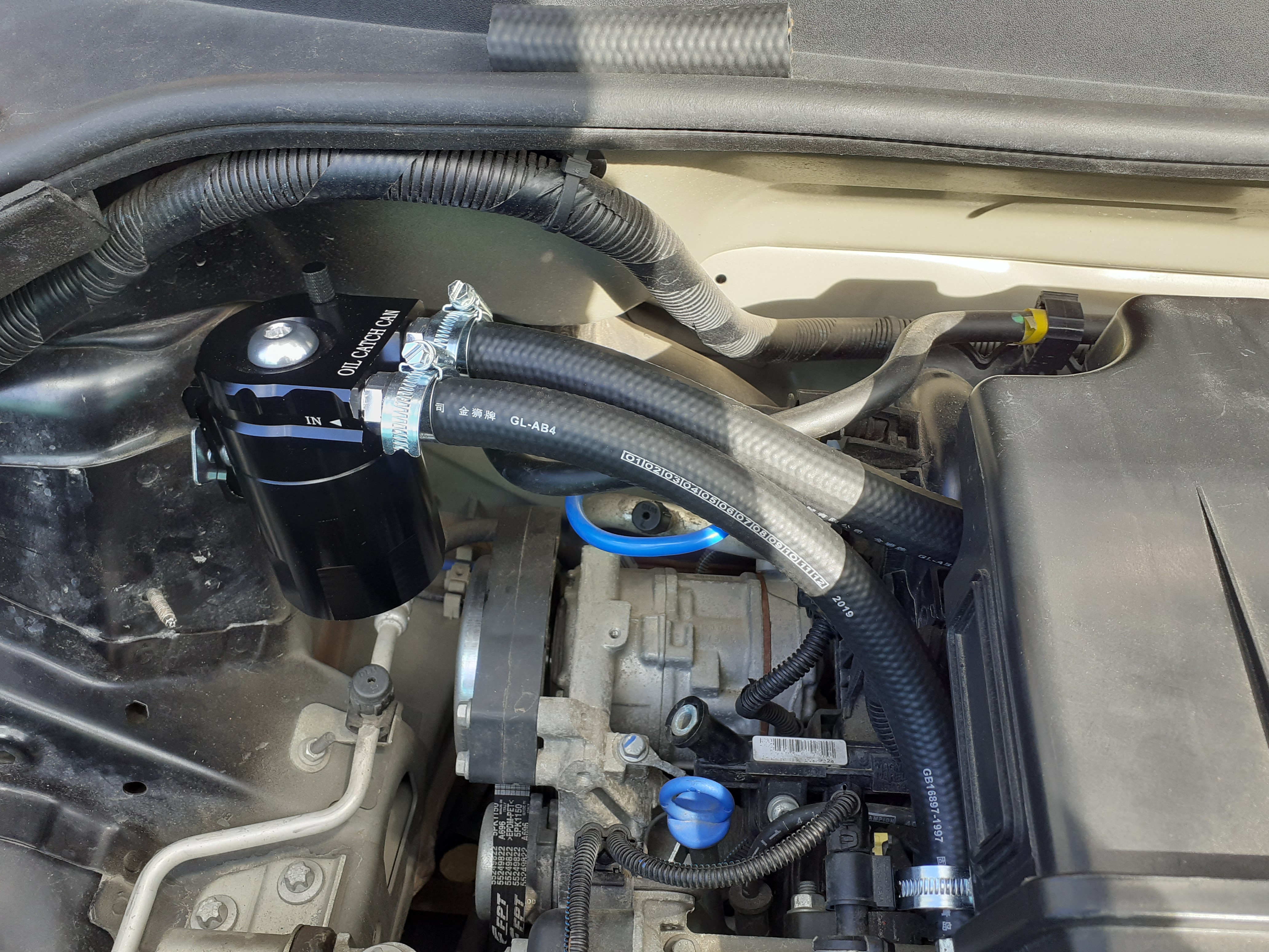

So! Its installed! I used 16mm inner diameter hoses and they fit perfect. But I wanted to clean my pcv valve since I'm working on the engine, and I came across something strange, there is no valve!?its open on the inside.Or is it supposed te be like this on puntos 3 1.2 gasoline engines? ( check the fotos)
See my previous comment, I’m not sure what you were expecting, why would there be a valve in there. As I previously said the only thing that should be in there is something for the oil to condense on but there is no valve
Yea a valve, PCV that opens when the pressure is high. But on my fotos it's not a valve it just a threaded open metal tube that was connected straight on the intake with a hose. I read somewhere that there are cars that don't use pcv valve but open breather pipe like mine in the picture. I never seen this before, most cars we worked on have pcv valves with little spring/ ball inside that open when it's under presure front the crankcase. So I wonder, since we all are fiat drivers, if anyone seen this on a fiat. Anyway. Been couple of days since the can is on, TB cleaned, and I can say that the engine is going smoother, it also accelerates faster under 3000 rpm. I know how my car feels, and it runs better. Might be the catch can, or might be all the factors combined ( catch can, cleaned TB, cold air feed, cleaned MAP sensor etc.) . Hey at least I wil keep most of the junk out of my engine now 👍
None turbo cars don't usually need a valve I. The system then tend to have a basic breather pipe
