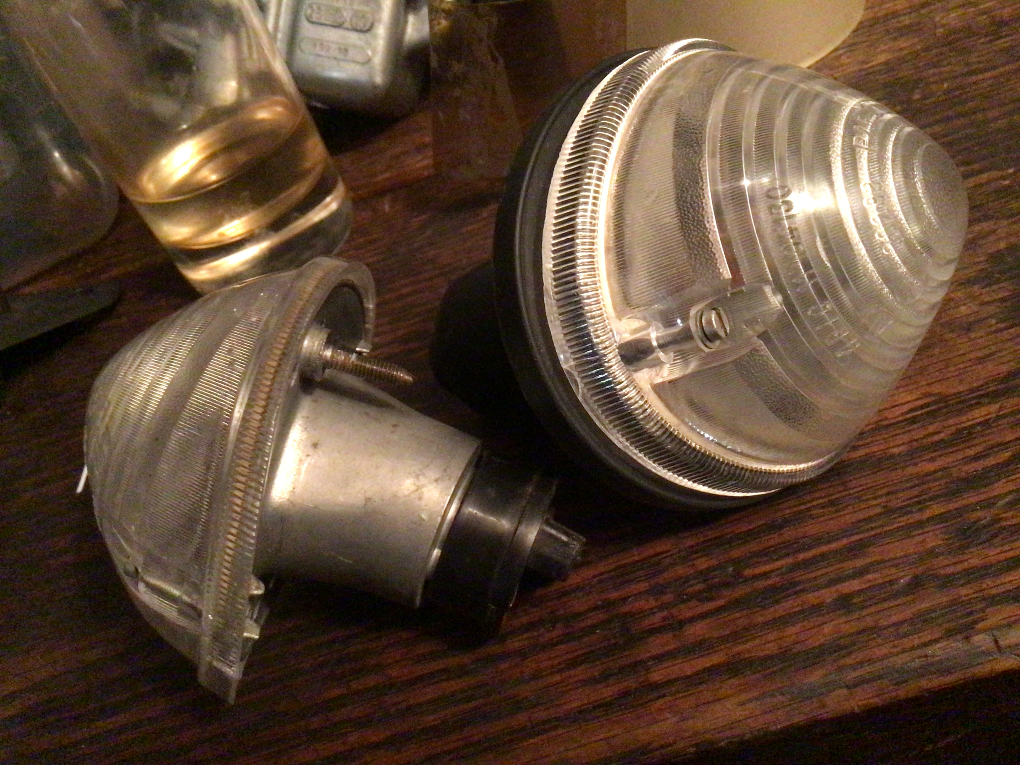

I bought a collection of spare parts last week which included these new top quality front indicators with backs made of metal & high density plastic with brass contacts. They take a single filament bulb. I could sell them without the lenses.

Foot note to this is that Noah500 went down the Ricambio route so I still have these front indicators which are correct UK specification and take a single filament bulb. Either an orange bulb with a clear lens to retain the Italian look or a standard bulb with an orange lens. Whilst I was at it I got out my box of other indicators for closer inspection. First thing I noticed that there were two different styles of lense, the older ones being closer to the N/D design. Secondly the plastic back ones, just like the metal ones had either bulb holders for single or twin filament bulbs. So I also managed to put together a pair of single filament plastic back ones if anybody needs some. Because of the way the bulb retaining pins are arranged you can’t fit single filament bulbs in twin filament bulb holders. I also carried out a close inspection of all of the ones available on line and eBay and they are all European spec for twin filament bulbs so if you have good UK spec units I suggest that you look after them :)
