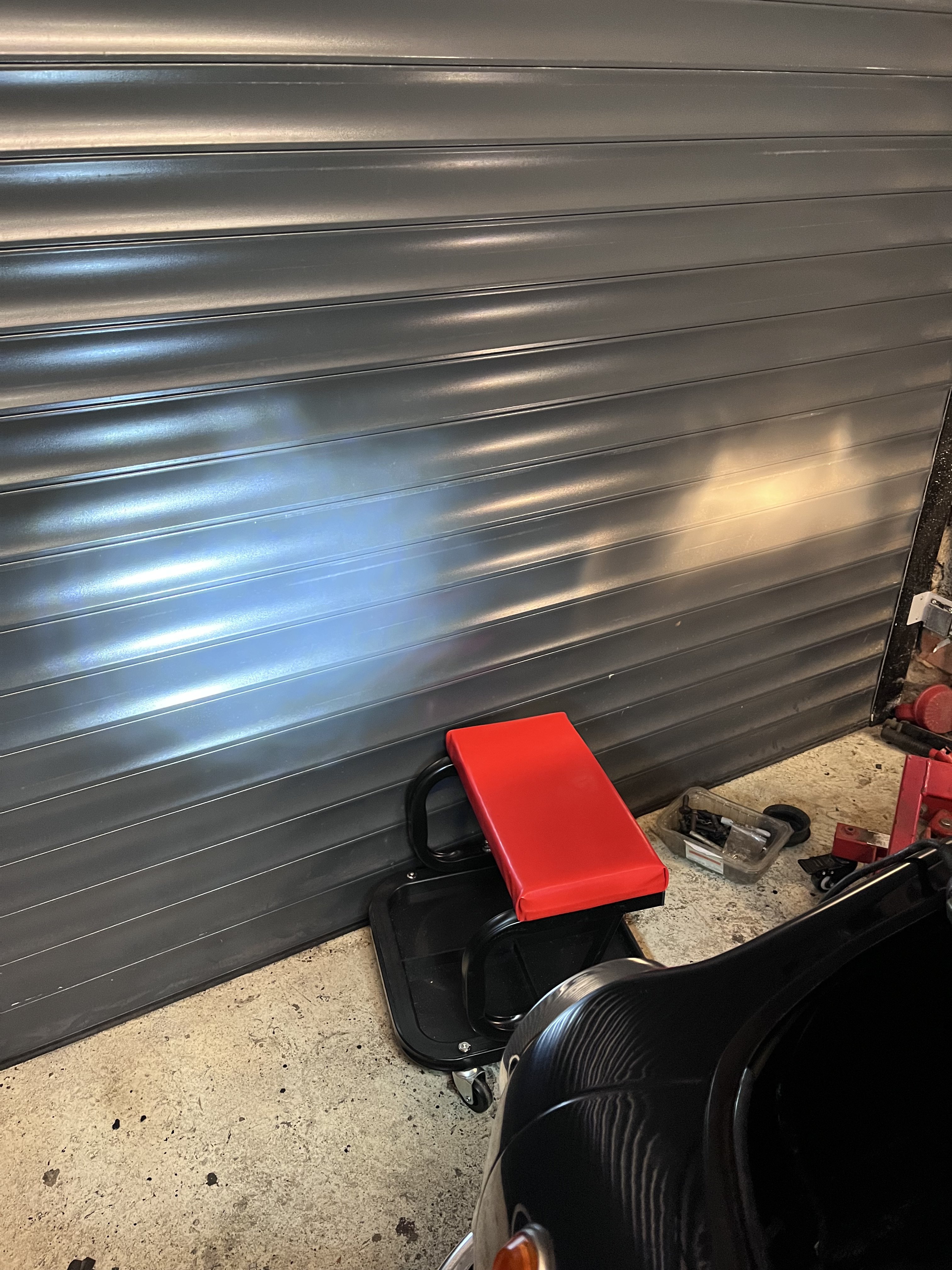

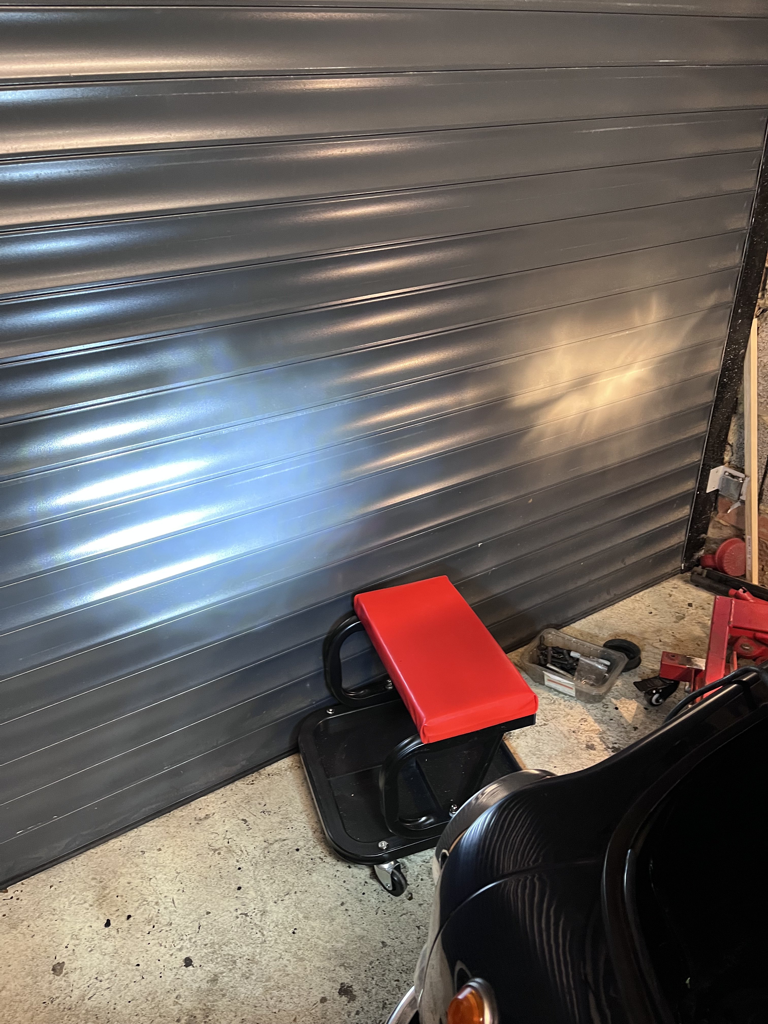

They give a bowl shaped patternView attachment 457307
If that is on Dip Beam then it isn't giving correct beam pattern compared with a standard 410 bulb.
It is easier to see on a smooth surface and perhaps a little closer.
Note this beam pattern is for cars driving on the opposite (wrong side;)) of the road compared to the UK and so the slope up will be to the left hand side.

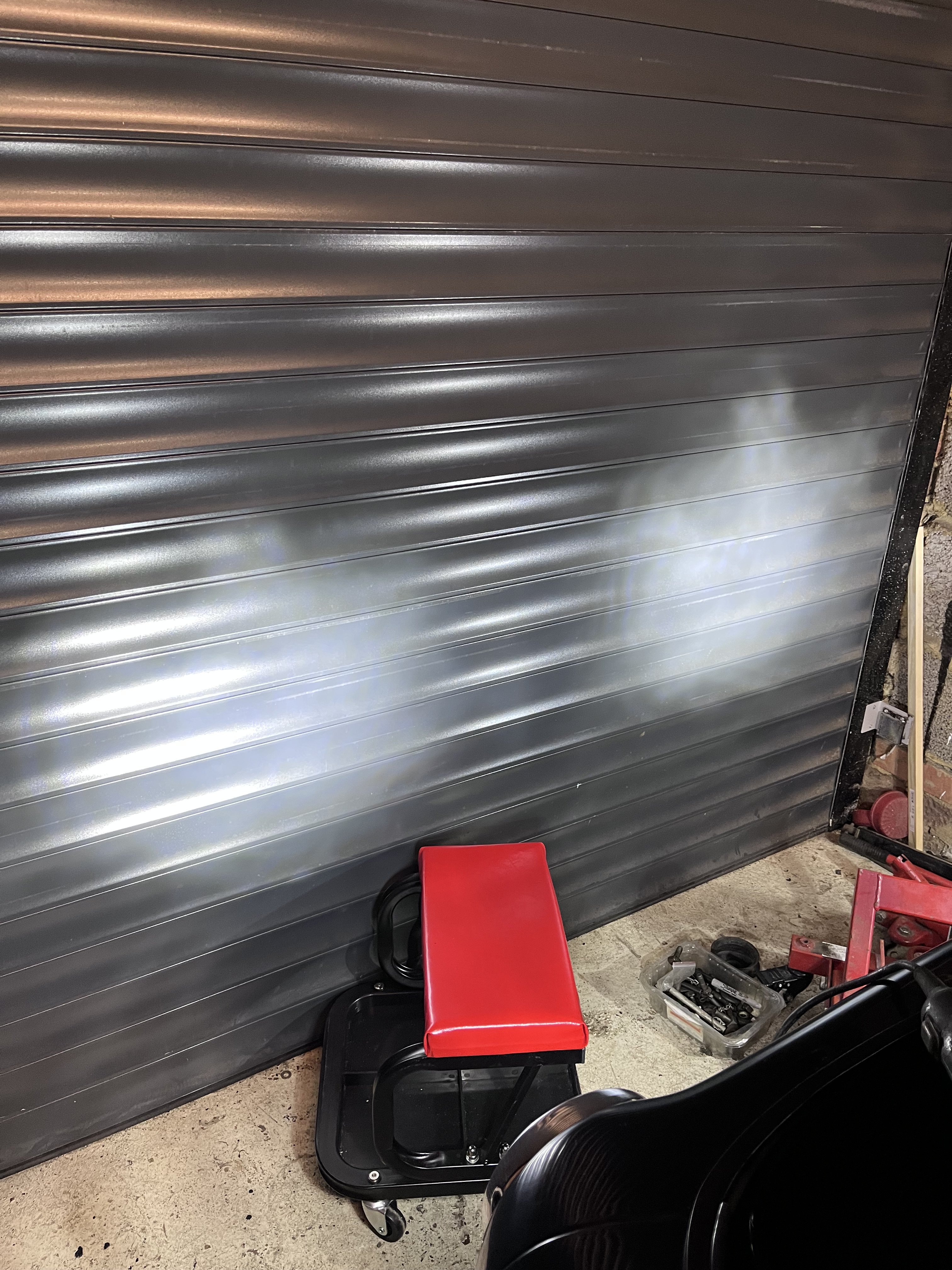

This is the original and an LED bulb as a comparison on dip and on main beam IMG_8648.jpegIMG_8649.jpeg
This is the original and an LED bulb as a comparison on dip and on main beam View attachment 457429View attachment 457430
I am assuming the left hand pattern is the new LED bulb, but in fairness neither is very well defined.
You may find having a piece of smooth board approx 18 inches from head light square on and not at an angle will hopefully give a clearer beam pattern on dip beam something like the photo I put up earlier, although bear in mind that was for a right hand dip for European driving, but the flat line and up sweep should be clear.
This is an English driving dip beam pattern with the up sweep illuminating the pedestrians at side of road and not dazzling oncoming motorists when on dip beam.
