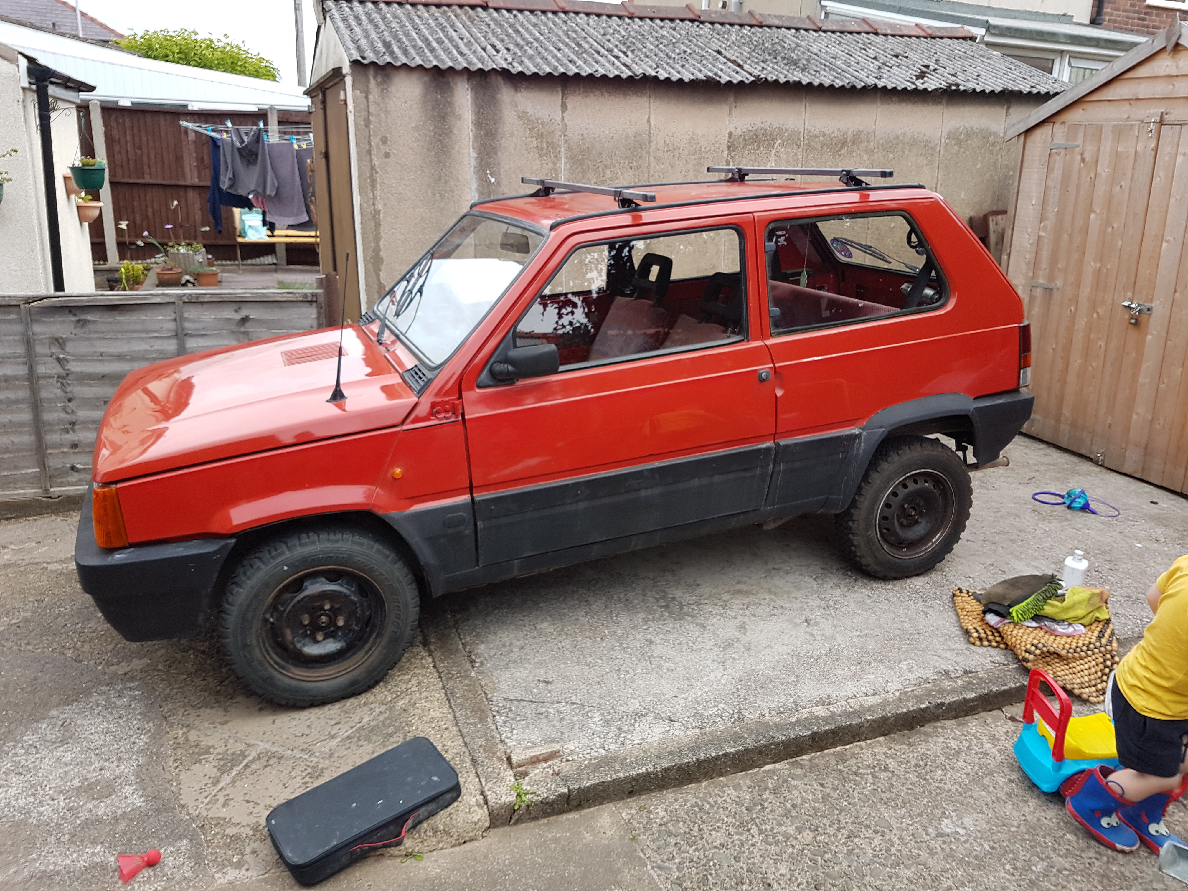

When you've posted 5 times we will have a few photos of the current jobs and highly polished vehicle !!!
Ha Ha!
Picture attached still a lot to do for me to be happy I will get there!
