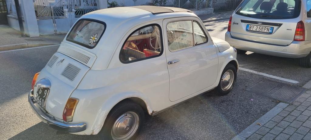

Hello all! I am new to the forum and will appreciate any insight and tip. I learned to drive in my grandma's 1969 fiat 500F (the blue one pictured). Last week I bought a 1965 fiat 500F ottobulloni - the white one pictured - and will have it restored in Italy by my trusted mechanic before driving it back to London, and I need tips on what to do with the car! It has to be utilisable as a daily, though originality will always be appreciated - should I go down the 'restomod' route or keep it as faithful to the original as possible? I always wanted a 'blu medio' car, and though I wanted an F I love the seat covers from the L model. My question is should I keep it as it came from the factory and repaint it white with the period correct F red and cream interior, or should I make the car as I would like it: blu medio with a red L interior, red roof and knee guard, new seatbelts and painted wheels with whitewall tyres? Disc brakes at the front and updated suspensions and a synchromesh gearbox? I am a bit torn! What would have the most value on the resale market in the UK? Open to suggestions for other colour schemes too! I essentially have a blank canvas, as the car I bought, though it runs and drives, will be stripped to the metal and meticulously restored to remove all rust and ensure reliability (as i'll drive it up to the UK from italy over 5 days when it's ready in 5/6 months or so!)

Thank you for the reply and welcome! Resale value wise I only cared to try not to lose too much money on the project 😅
I would do the drive from Italy up to the UK, then drive it every other day in London. I was looking at one that had a 126 engine already fitted in it, but I think it's best for me to keep the original engine with matching numbers and have it fettered with a little by my mechanic - he's a 500 specialist and my grandma's '69 F with the same engine (but rebuilt by my mechanic) has about 22hp and comfortable sits at 100km/h. I think i'll do it in light 'blu medio' with a red L interior then, and paint the wheels and go for a red roof. I never had an issue with the drum brakes being weak - is the disc conversion worth it? Cheers :)
