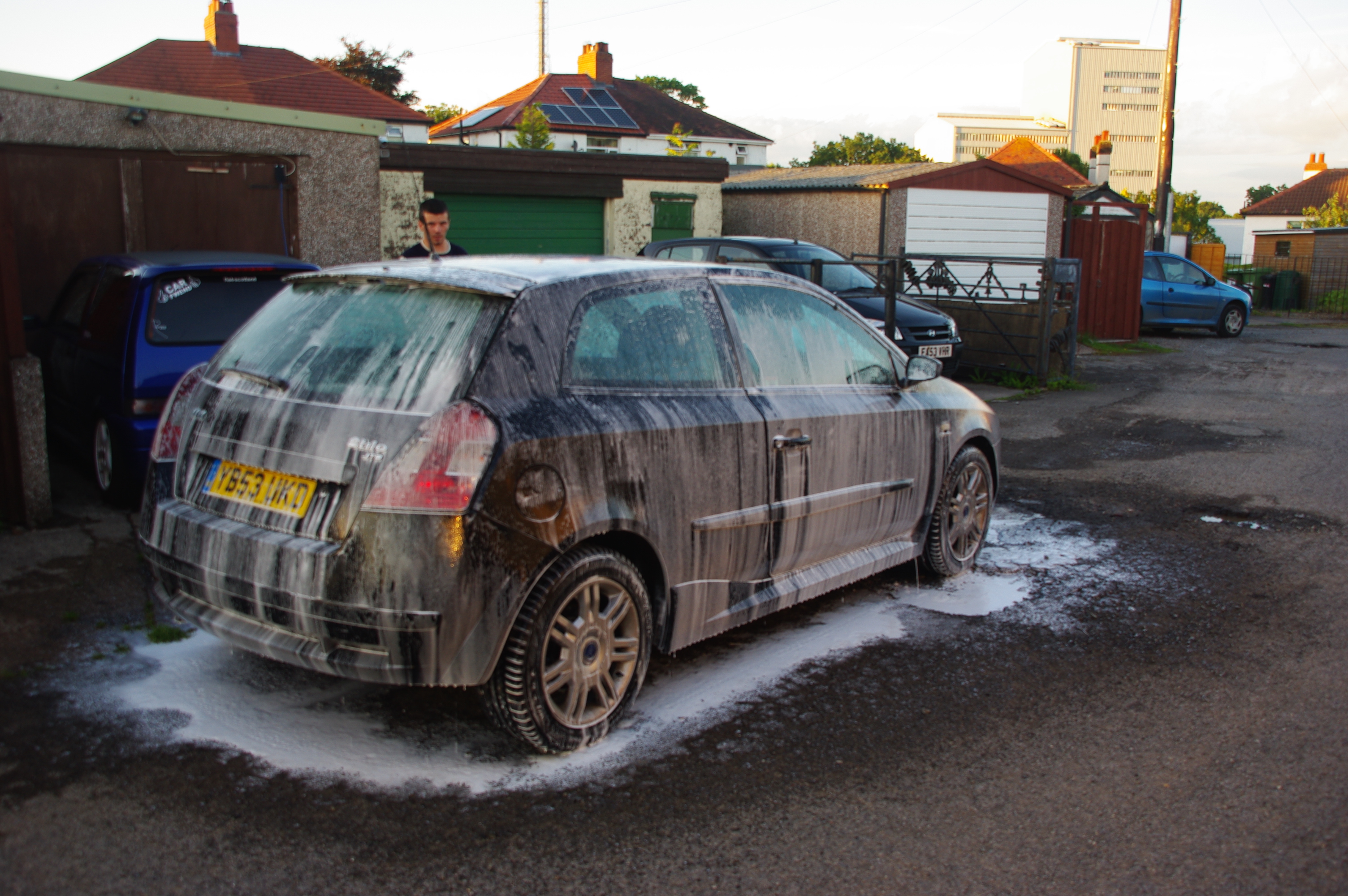

Well since the 306 was missbehaveing , i think it ran out of cheese ...
so i got told about this Stilo for sale of a Good friend of mine and hes legend of a dad was selling it so had a test dive and said i want it if the insurance was cheep enough so a quick call and it was a massive £4 more .. so went for the car today the car will be used for my work horse (y)
pics
