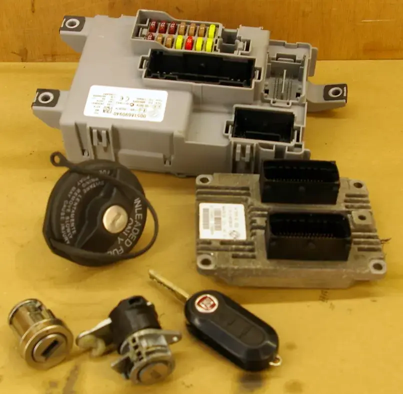

3. You can buy whole set of modules: ECU + Body + key + door lock + ignition switch + fuel cap. So called "starter kit".

Thanx this is the best answer IL look for an entire lock set thanx my guy IL give an update when I do get one
