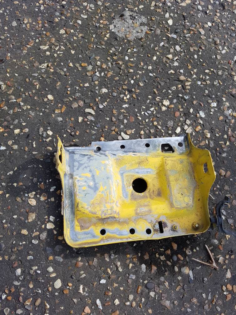

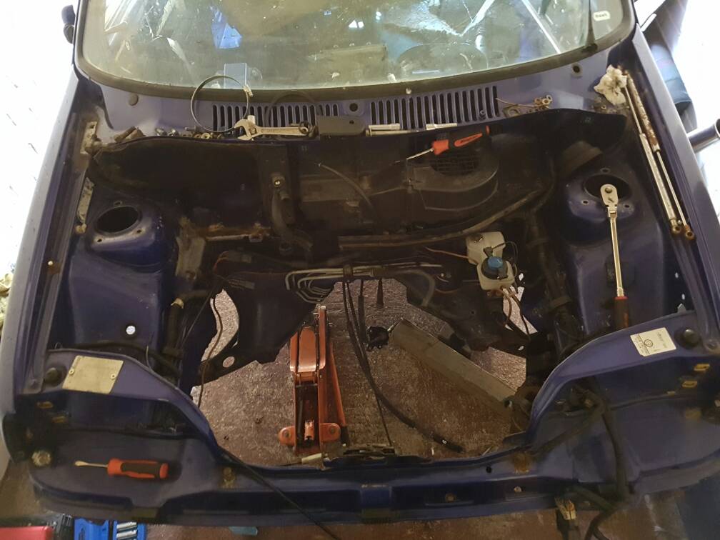

Well.. this weekend i finally got around to relocating the battery or more... removing the front battery and re wiring the ignition to run from the rear battery... so.. 6 spot welds drilled out and a short sharp tug of the tray and it was out...
What i then found i wasnt ready for... it took maybe a 2 hour job of wiring in the ignition, starter and alternator to a full afternoon of repairs and welding... so... here it is..

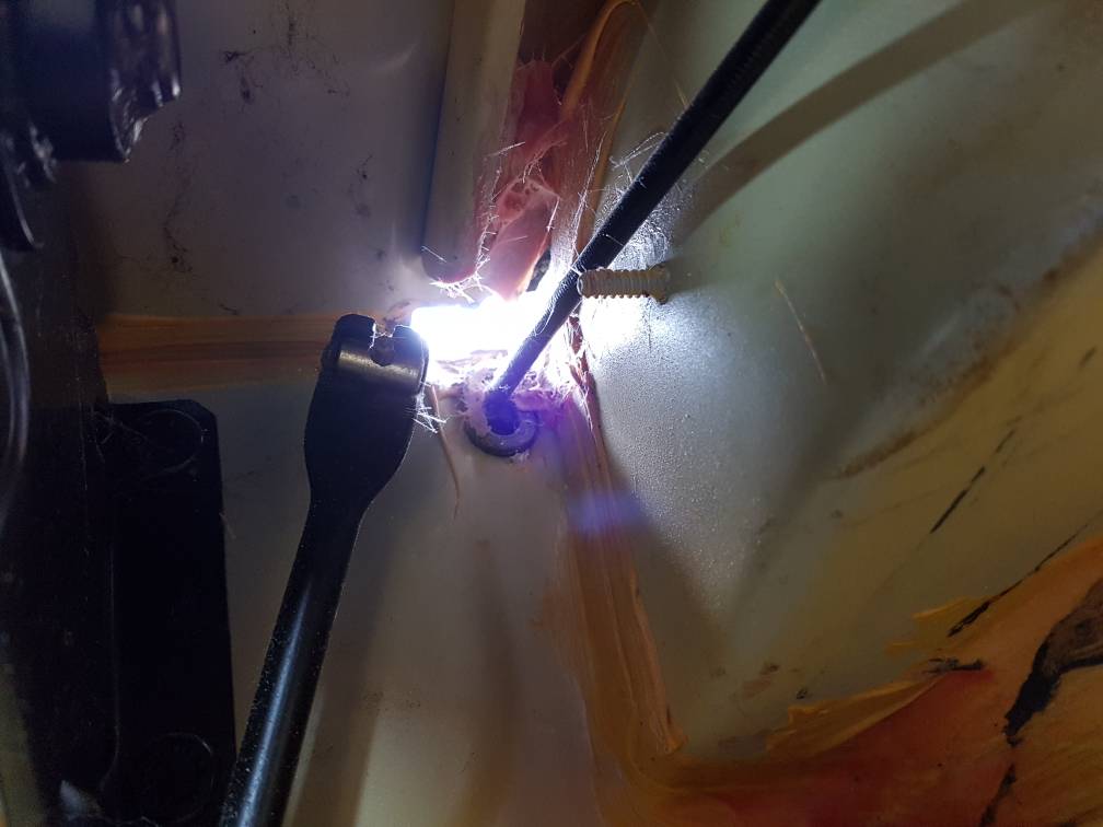

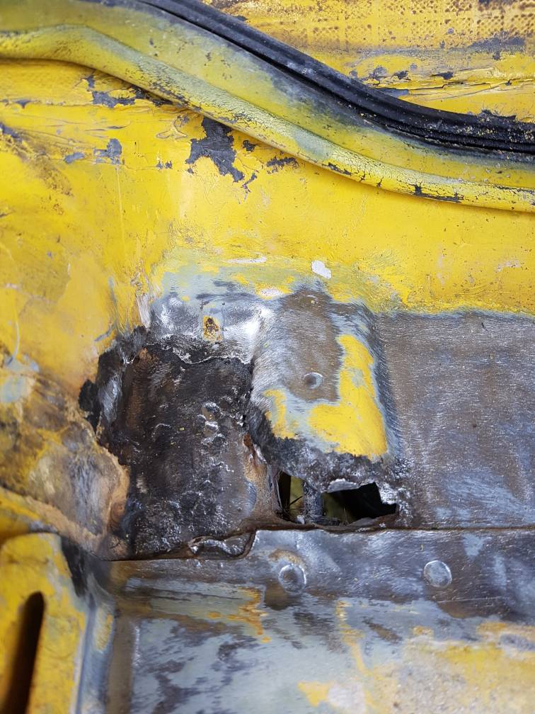

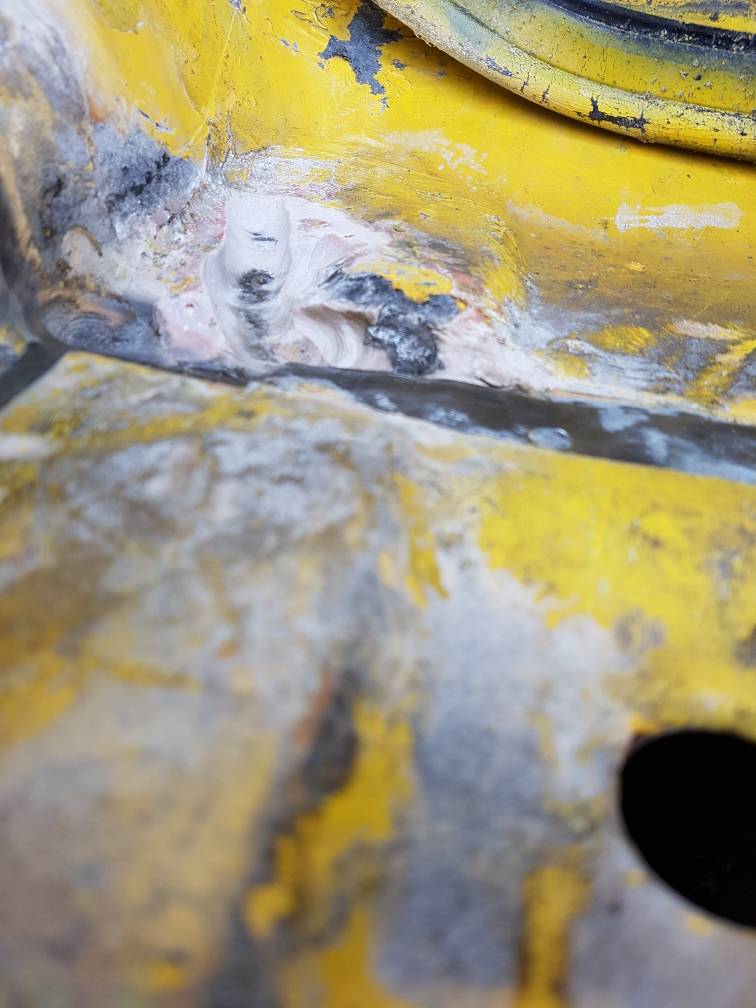

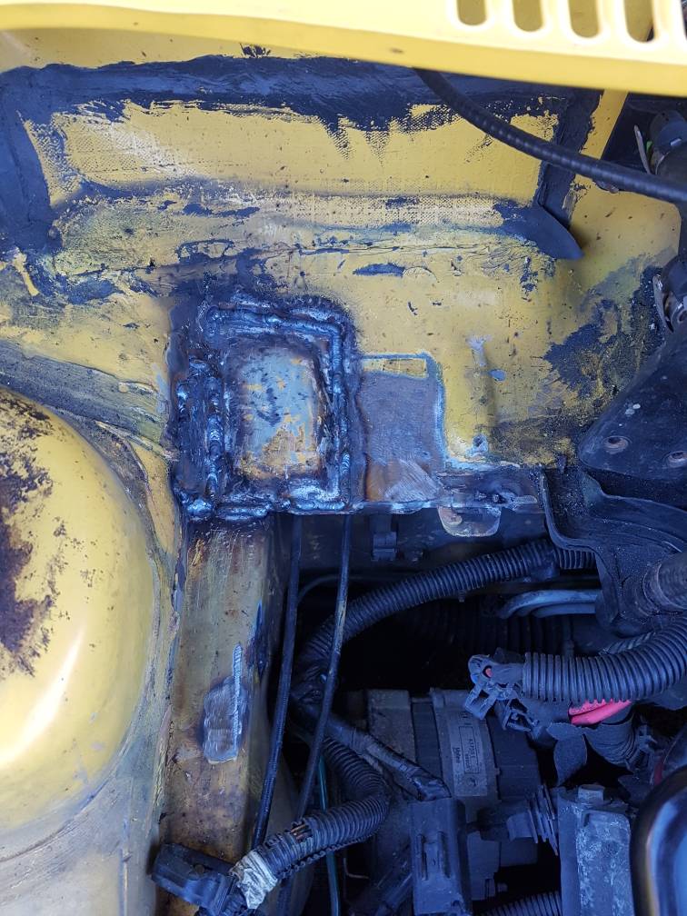

It turns out the battery tray was rotten... and there had been a previous 'repair' if you can call it that... basically someone had fasioned a bulge on the top of the bulk head from fibreglass filler... as with any fibreglass filler job thats covering rot turns out...
I could see outside from the inside... from somewhere i shouldbt have been able to...
so yes... someone had buggered the entire job of repairing a bit of rot up.. by filling it full of poo... and underneath tgis was happening...

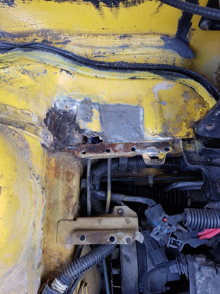

So i after removing the battery tray i then cut the fecker up to make a rough plate to cover said hole after attacking it all thoroughly with the wire brush on the drill... ill fire some cavity wax up from inside in the not so distant future but to cut a long story short.. its sorted for now... or atleast until i get the shell repainted
Its not pretty but itll do for now...

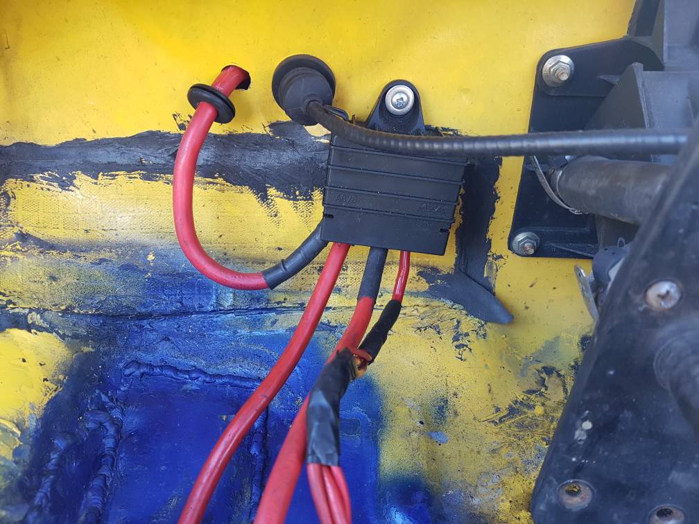

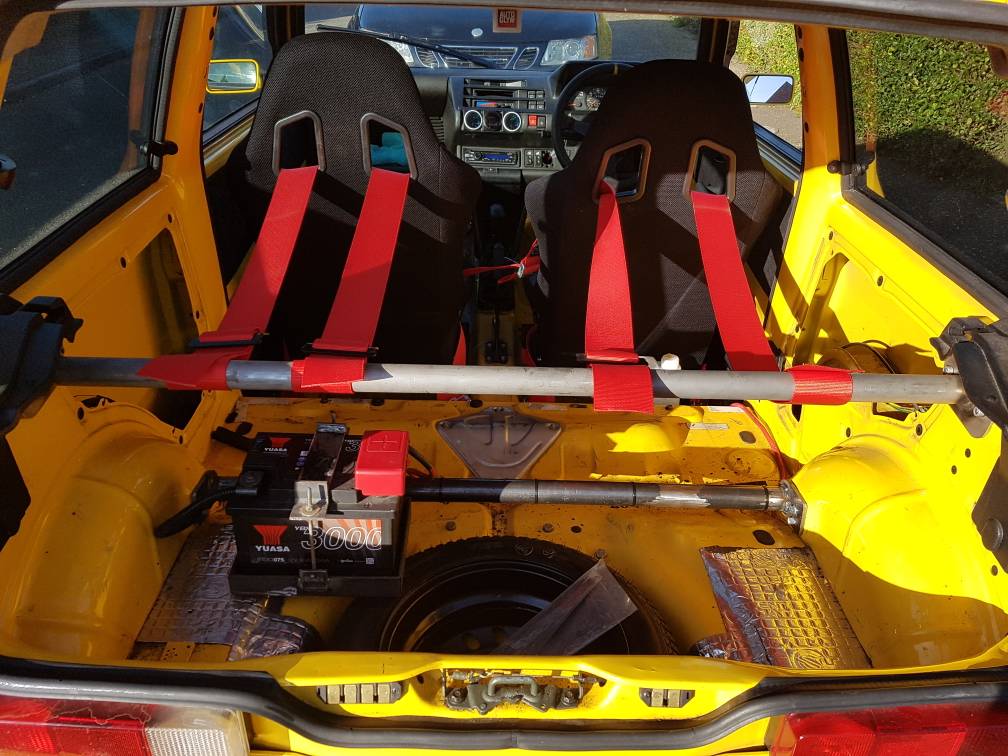

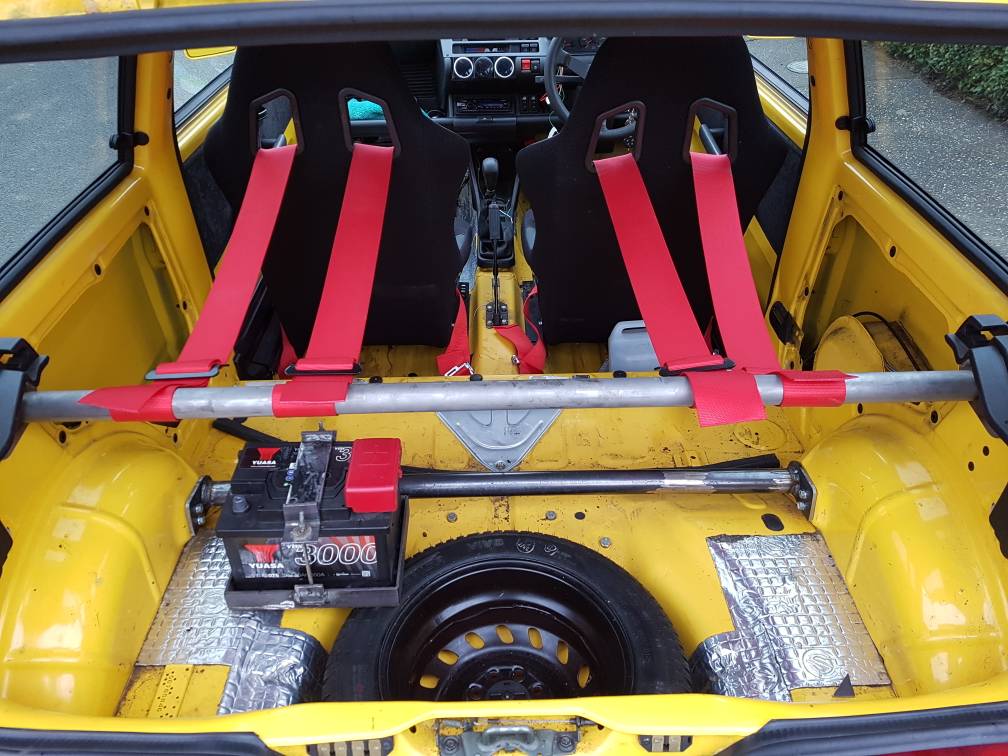

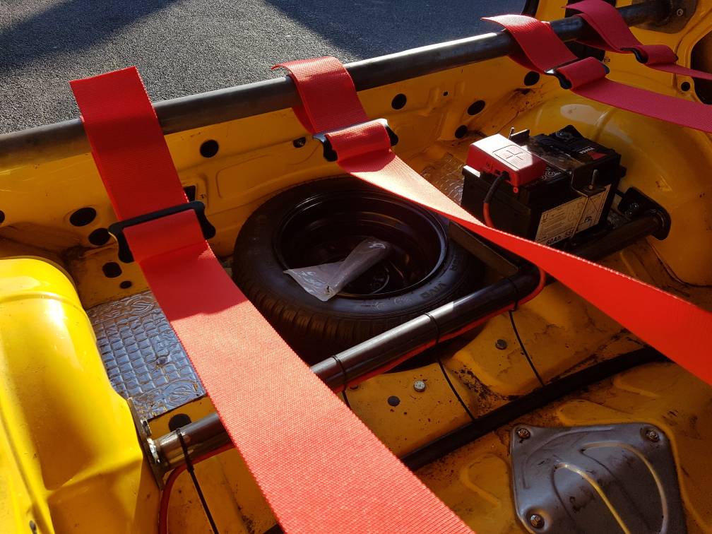

And then on to actually wiring the battery in.... a 190amp 3way splitter box was screwed to the bulkhead out of the way

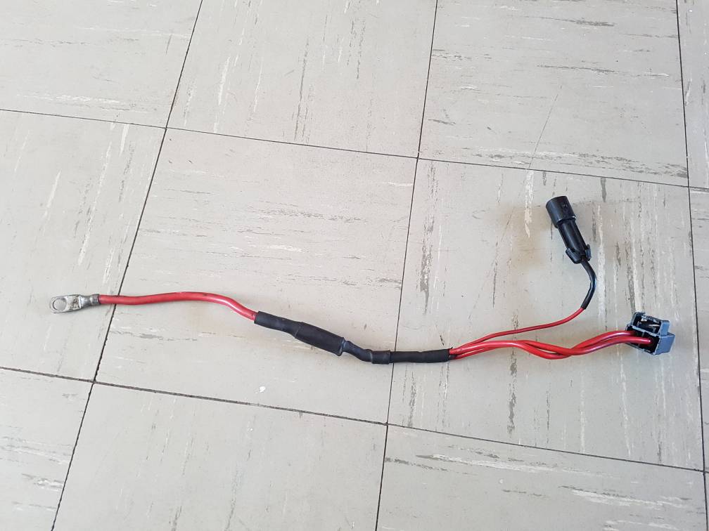

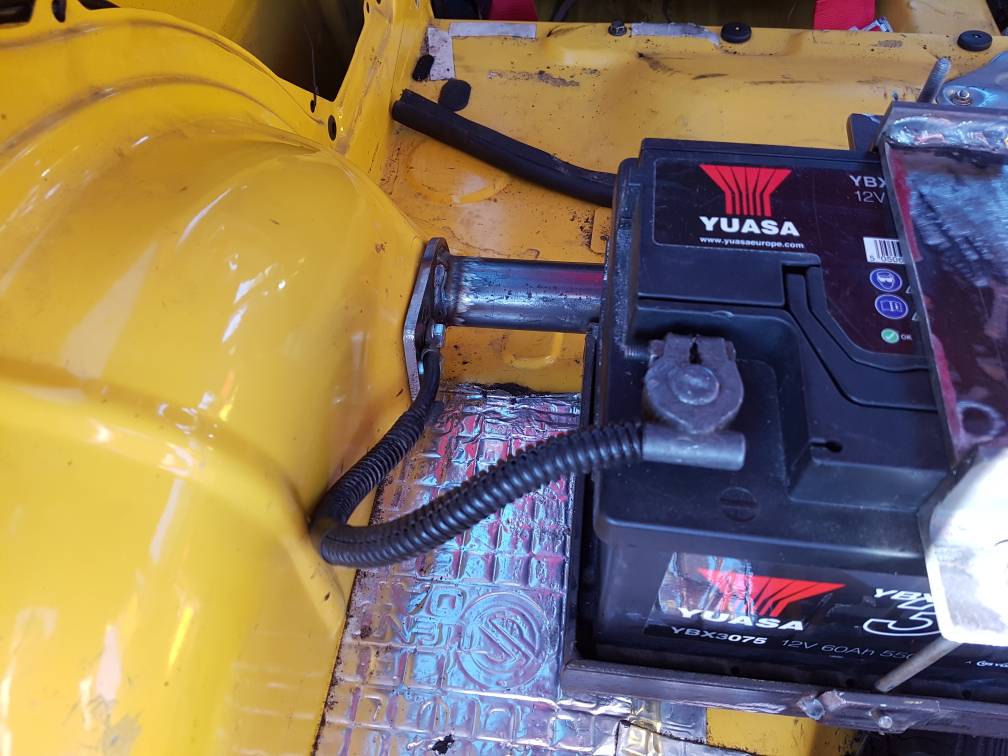

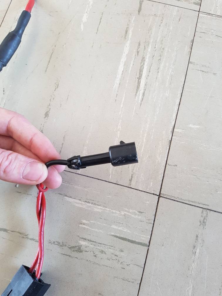

One wire was run through a gromit in the bulkhead to the rear battery one was ran to the alternator and one to the starter... the interior electrics were sorted by cutting up the old loom and terminating it so it could be plugged into the factory interior loom and a feed sent to the bullet connector that feeds power to the ecu...
Then the battery was connected to the wiring via a renault megane +ve battery connector that has a inline fuse and two separate fuses that can be used at a later date for the fusebox i will use to power the gauges, their sendors and the innovate motorsport lc-02 wideband controller.. along with the power feed for the ecu map switch function and whatever else i so choose...
The battery was earthed via the lower brace bolt using the factory earth lead from the front..
And although i didnt picture this i took the oppertunity to add an extra earth cable to the engine using the old earth boss that i removed the battery earth cable from.. you can never have too many earths right??

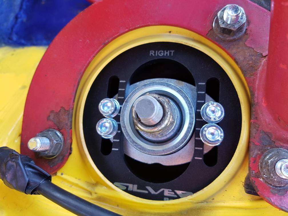

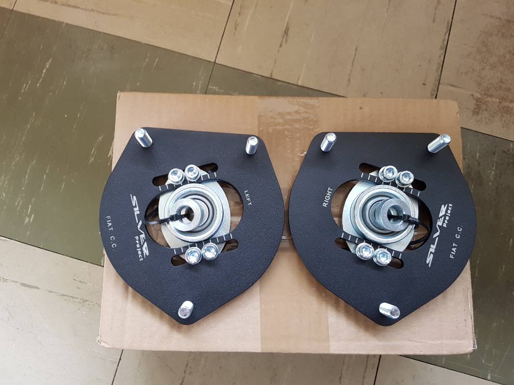

I also got the silver project camber adjustable top mounts fitted however i didnt take many pics as i was rushing to beat the lighting..

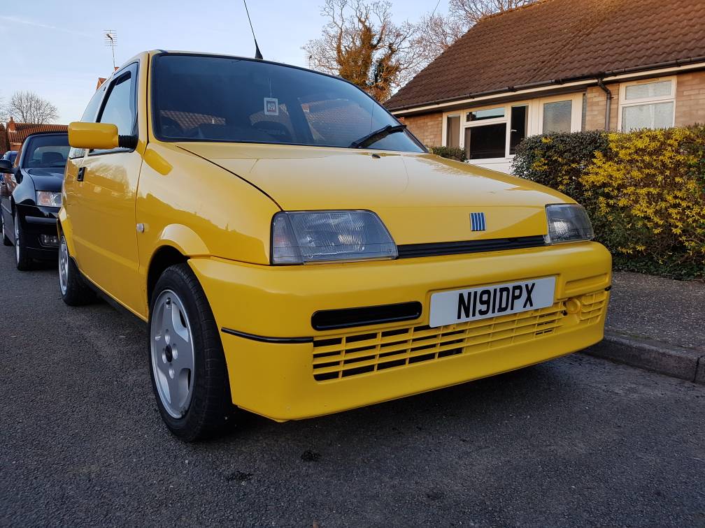

And i fitted my shorter front plate.. then i realised id not put a space between the first 3 numers and the last 3 letters... so ill be ordering another soon ??

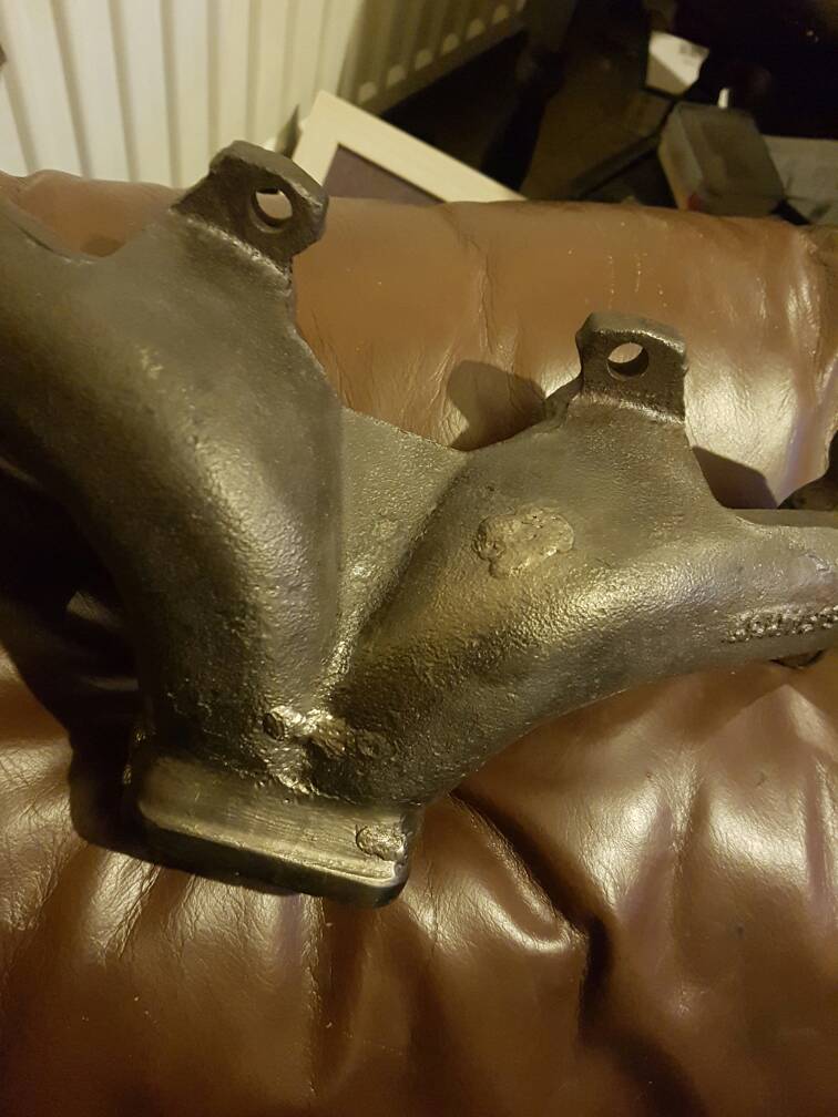

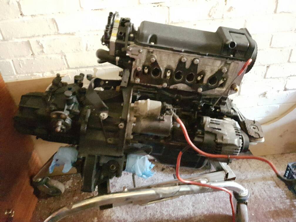

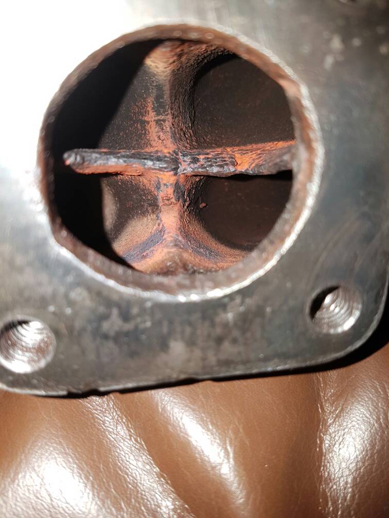

Oh and as some of you know... this happened recently...

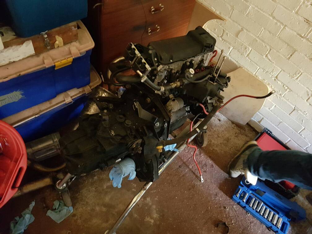

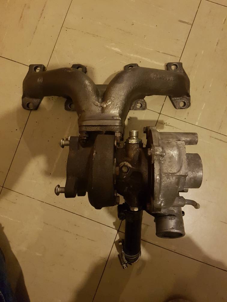

so the manifold is back from.the machine shop with a fresh skim... turbo is bolted back up and its almost ready to fit back together... i need to get the brake servo take off boss moved on the p75 inlet mani so it clears the bulkhead trim and then the engine should in theory be able to go into the bay...
This weeks jobs are fit the new driveshafts... fit new front wishbones and then fot the sei pas rack with new trackrods and rack ends... then hopefully on friday i can have the alighnment done and the new yokos fitted

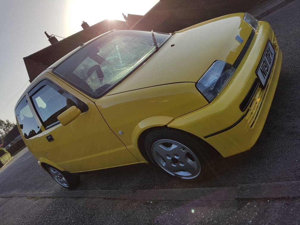

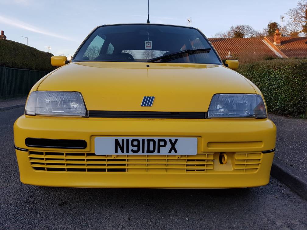

How ots sat today...
