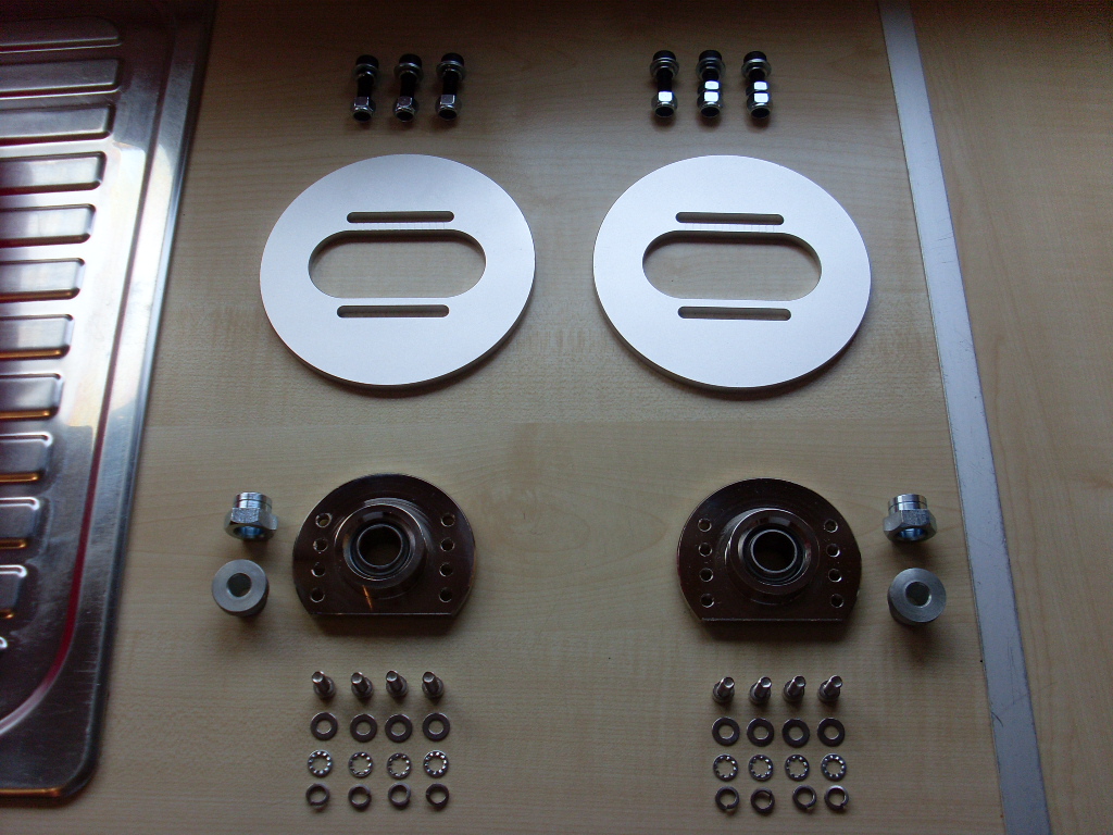

If iam honest iam not been that keen to go down to the garage at the minute but i have made a start to the adjustable camber plates i bought at the start of the year,
So what Ive done is remove the coilovers,stripped them down,and give them a good clean then fitted the new adjustable camber plates,
That's about it for now,more in the coming days & weeks,

Hi All,
Just a little update whilst i have 5 mins to spare:),
I managed to get the coilovers with the new adjustable top mount strut bearings fitted which iam happy with:),
Like i said the other day,until i get the car back to Pro Grip and get it set up on the hunter imaging system will i know whats what.........when that will be iam not sure?, as iam not sure iam puitting the old girl back on the road this year, so theres no rush?,

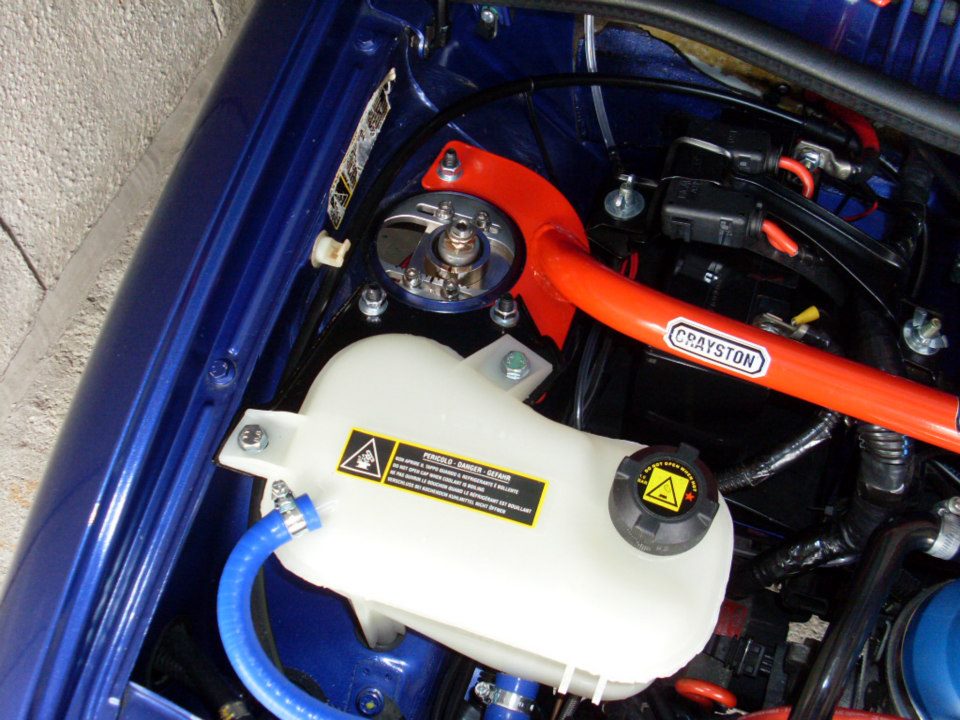

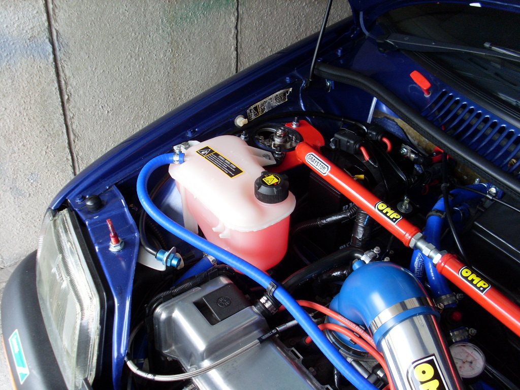

Like i said the other day i got the new coolant tank and cap fitted and bolted back in place,its now just a case of filling it back up with fresh summer winter coolant,looks much better eh,Thanks Blu;),
Here is a pic of both in one shot to keep you going.....don't say i don't give you anything:D,
What i will do for you once i get the car topped back up with fresh coolant and checked for leaks and the sump guard bolted back on will i give you a few shots of the cars new stance,

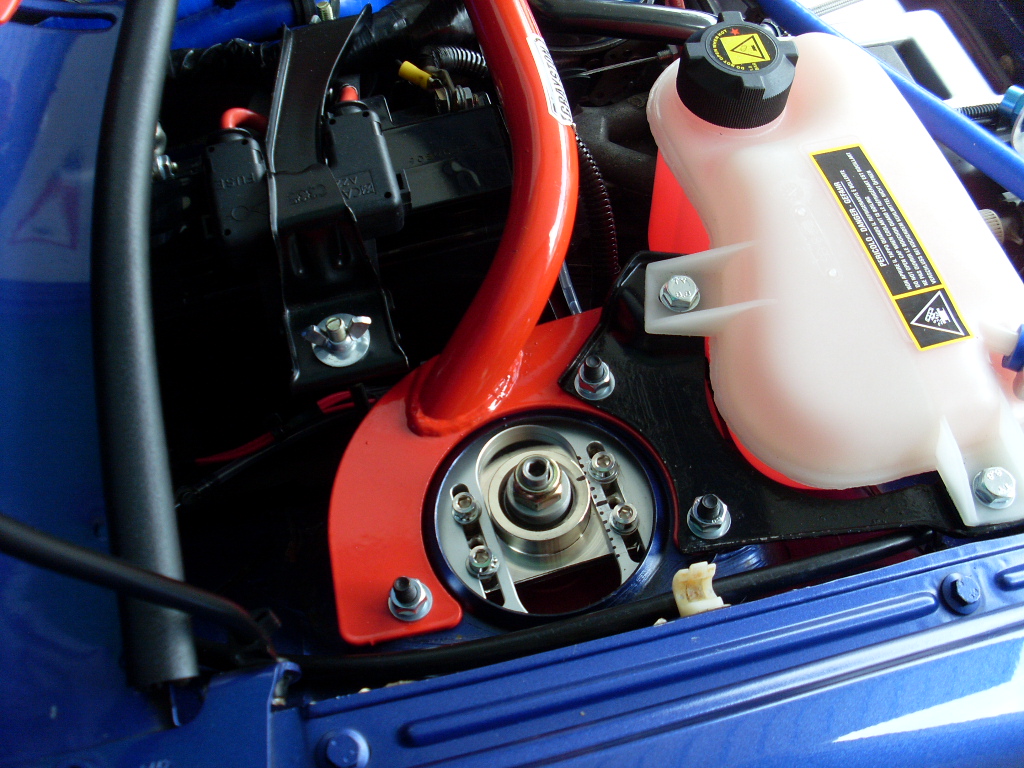

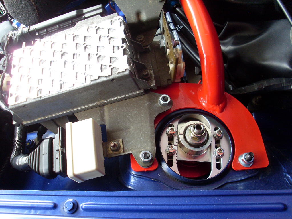

Hi All,
Right i managed to get the coolant system filled back up and checked for leaks and sump guard back on.....all good:),
Like i said the other day the new adjustable top mount bearings and coilovers are fitted and set as near as possible to each other,like i said until i get it back to Pro Grip and it set up right and tested will i know whats what,
As a rough measure the camber plate and coilovers are set at about 1.5 degees of camber......nothing to silly,
New adjustable Camber plates
Iam working on another update and improvment for the car,but thats it for now,

another Good update from you don
Question , how must camber is the max camber you would be able to set with these and your bolts?
Hi Pal,Thanks:),
These plates themselves have a range of .......- to + 3 degrees camber,the "FK Silverlines" that iam also using can also pivit to match the plates......and if memory serves me well?, using the "FK Silverlines" i was also able to slightly adjust the camber with normal top mount bearings the last time i had it set up on the Hunter Imiging System as there is some give on the bearing itself as its moulded into a rubber mount, thuse allowing you to have slight adjustment on the pivit bolt itself on the coilover where its bolted to the hub.............Hope this helps,
Cheers Don
