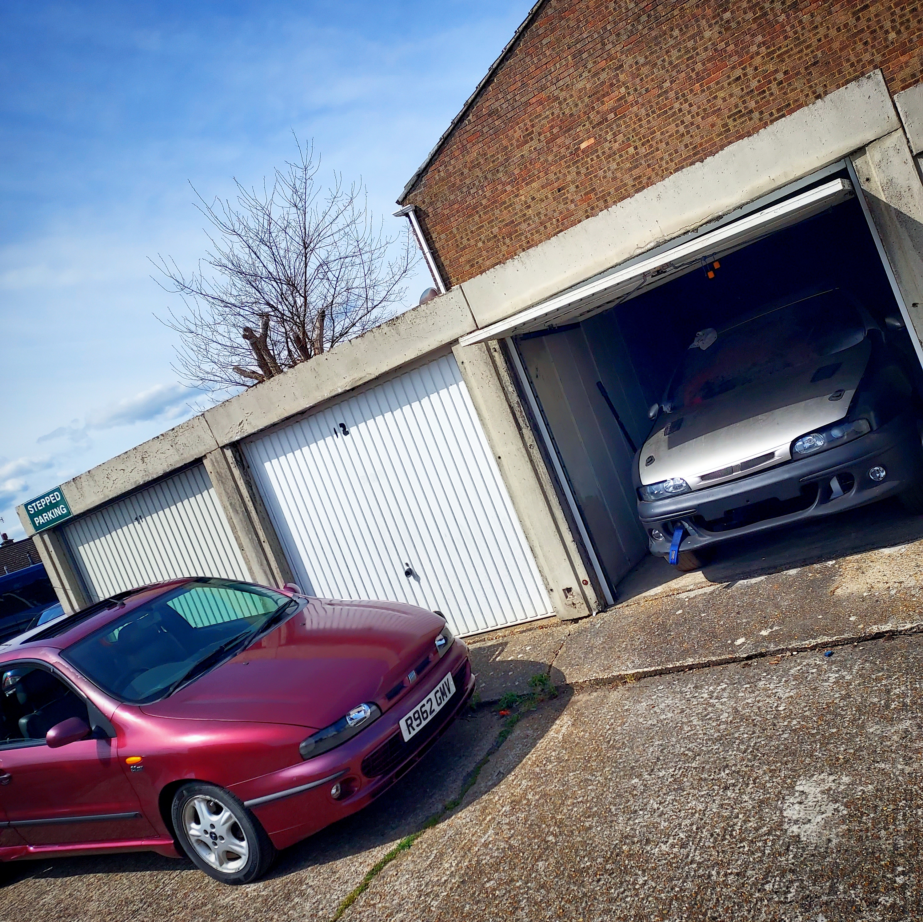

In January 2016 i Bought this lovely 155 HGT from blu73
Immediately fitted the car with sone Marea HLX polyelliptical headlights, some wind deflectors which Chris kindly gave me, a Marea centre console and that was it
I used the car for a couple of months but in April 16 the car developed several issues on the way back from Brooklands
After a few hours taking the engine to pieces we diagnosed a Cracked block [emoji22]

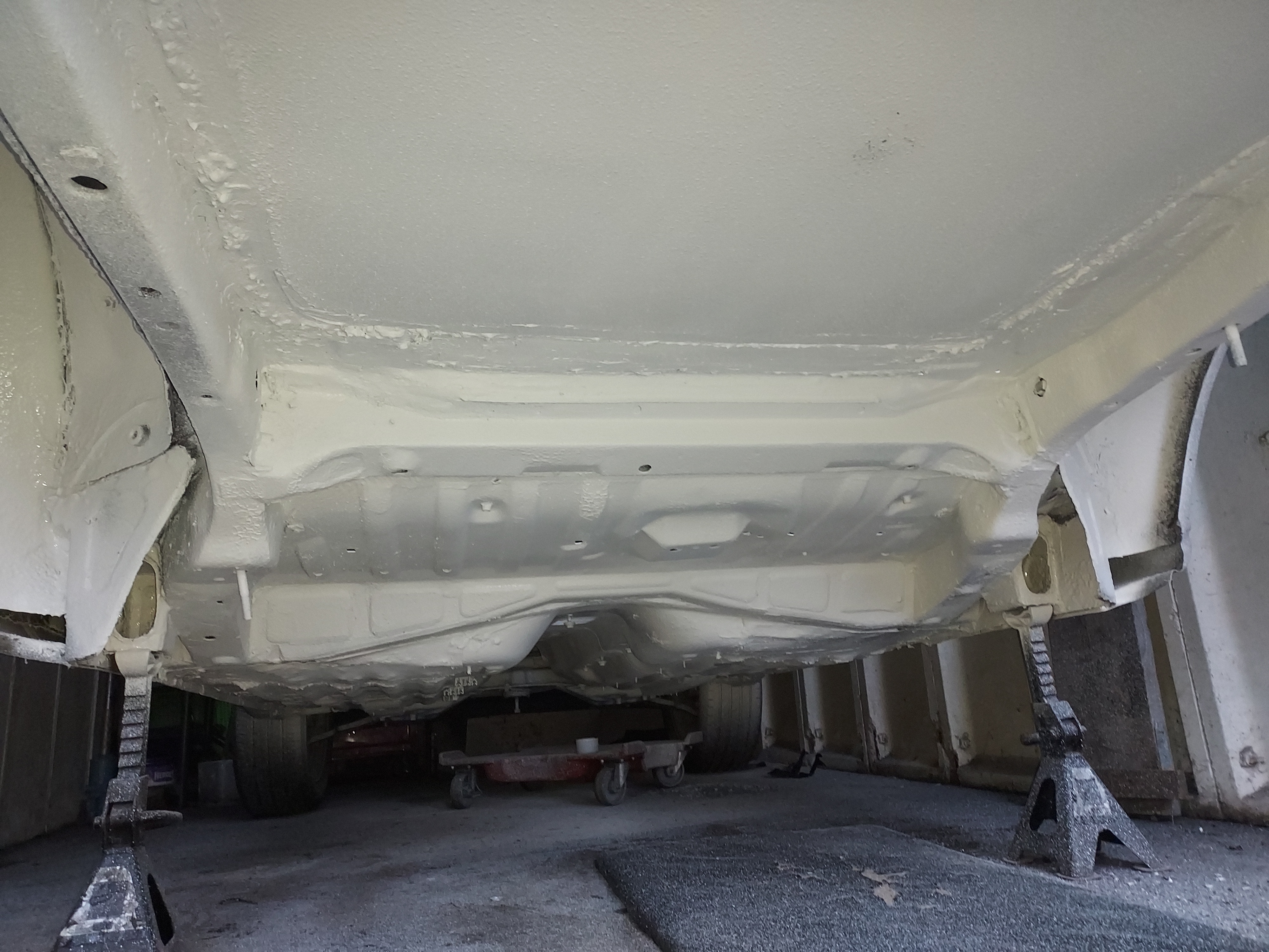

Whilst waiting for that to arrive i decided to tackle the rest of the rust on the rear end
Both of the rear inner arches were completly shot ....so currently on the hunt some clean ones .....
But whatbi could was cleaned and treated and temporarily painted .....
Once all the welding and repairing is complete i will be fully painting the complete underside in body coulor ....
Last week i finaly got the subframe back from powder coating and was test fitted .....
