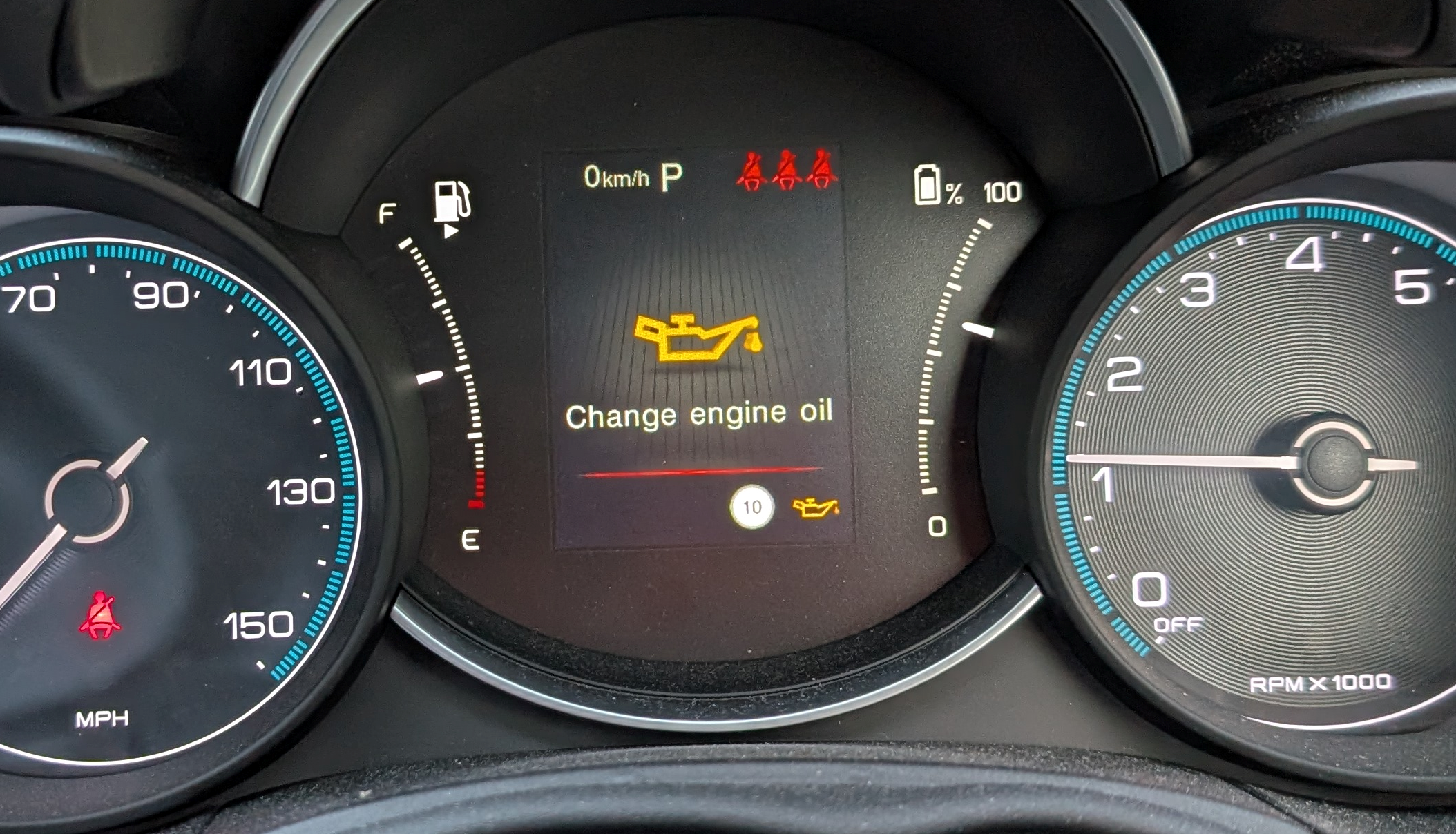

So my car has done 2200 miles and it's saying change engine oil. which seems premature....

My 500X is occasionally showing the same YELLOW warning. It has done 4,300 miles since the last oil change and for the Service Computer based on mileage it is not due yet. The 365 day service warning came and went a long time ago. Last full service was in July 2020 at 27K miles.
If you check the handbook you will see that the YELLOW symbol is when the engine ECU thinks you have done too many short drive cycles and is erring on the side of caution. When an oil change is compulsory based on the mileage/service computer then required the legend an warning will be RED.
In my case the warning goes away after an engine stop on cycle and only reappears if I do multiple short runs.
Now one can discuss is this "you have only done multiple short drive cycles" but still well under the normal oil change mileage a Fiat mechanism to get you to visit the Fiat dealer for an unnecessary oil change, bit like the every 365 days even if the car has only been used 12 or so times.
MY opinion. If the oil is only 2200 miles old and the Service Computer is not showing service required then the yellow warning should go away and if you drive some longer distances then you should be fine. If you only ever do short drive cycles then you have to decide if you think a modern quality oil can survive under these low mileage cycle conditions.
I guess one reason this warning appears (besides getting you to visit the dealer) is that if the engine is not getting up to running temperature for a period of time then natural condensation/combustion water will not be evaporated off and recycled through the engine via the crank case breather. In this case I would expect emulsion (cream deposits) to be visible if things are getting too bad.

2200 miles in about 8 months (if you took ownership at the end of May) suggest short cycles, indeed, or infrequent use.
If that's the case, the ECU could suggest doing a long country trip rather than change the oil.
