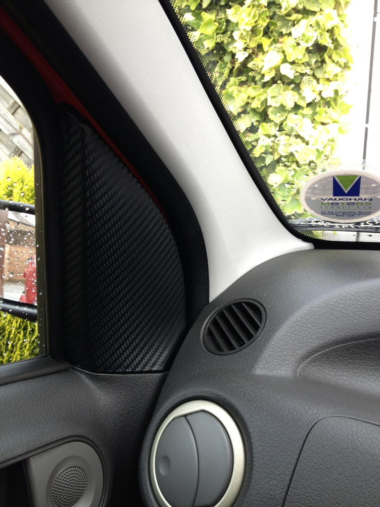

I had my centre console done in carbon wrap but couldn't get it quite right so I sprayed it black. (not really sure I like that so thinking of doing it red)
I left the vents on either side in wrap though
How easy or difficult is it to get those vents out. ???
dead easy and tool free.
- open vents, feed ur fingers through grab back of the rim and pull. try pulling it 1 side out first. they just push in really.
Or u can use trim tools or flat driver to pray them off but wrap driver in something soft so u dont damage trim around

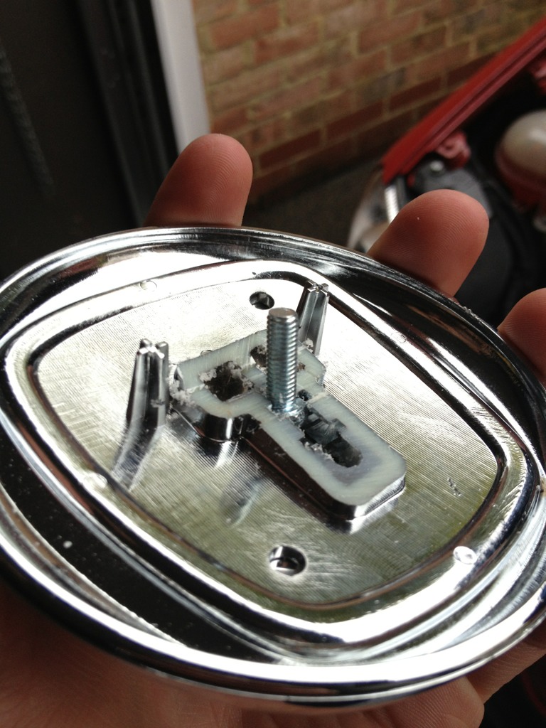

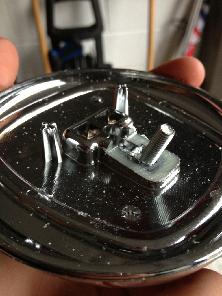

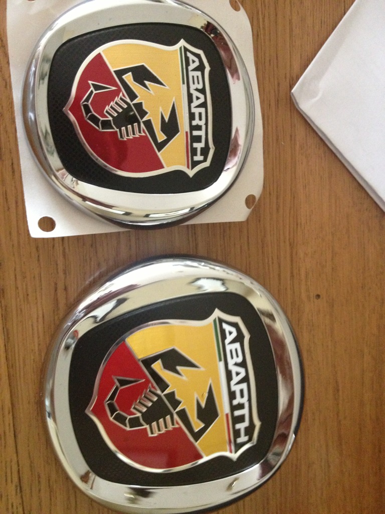

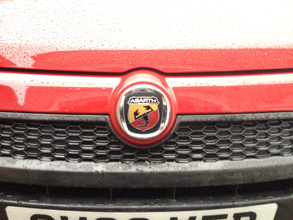

Front badge was tricky. Had to loosen the 4 bumper bolts and flex the bumper to get behind it but the badge needed cutting down in the middle because it was not flush so we did it with a little Hak saw then went on nicely! ImageUploadedByFIAT Forum1369846200.072184.jpg
