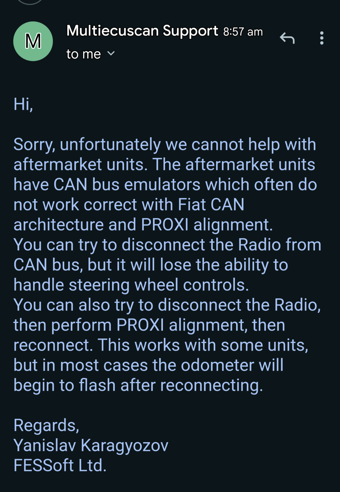

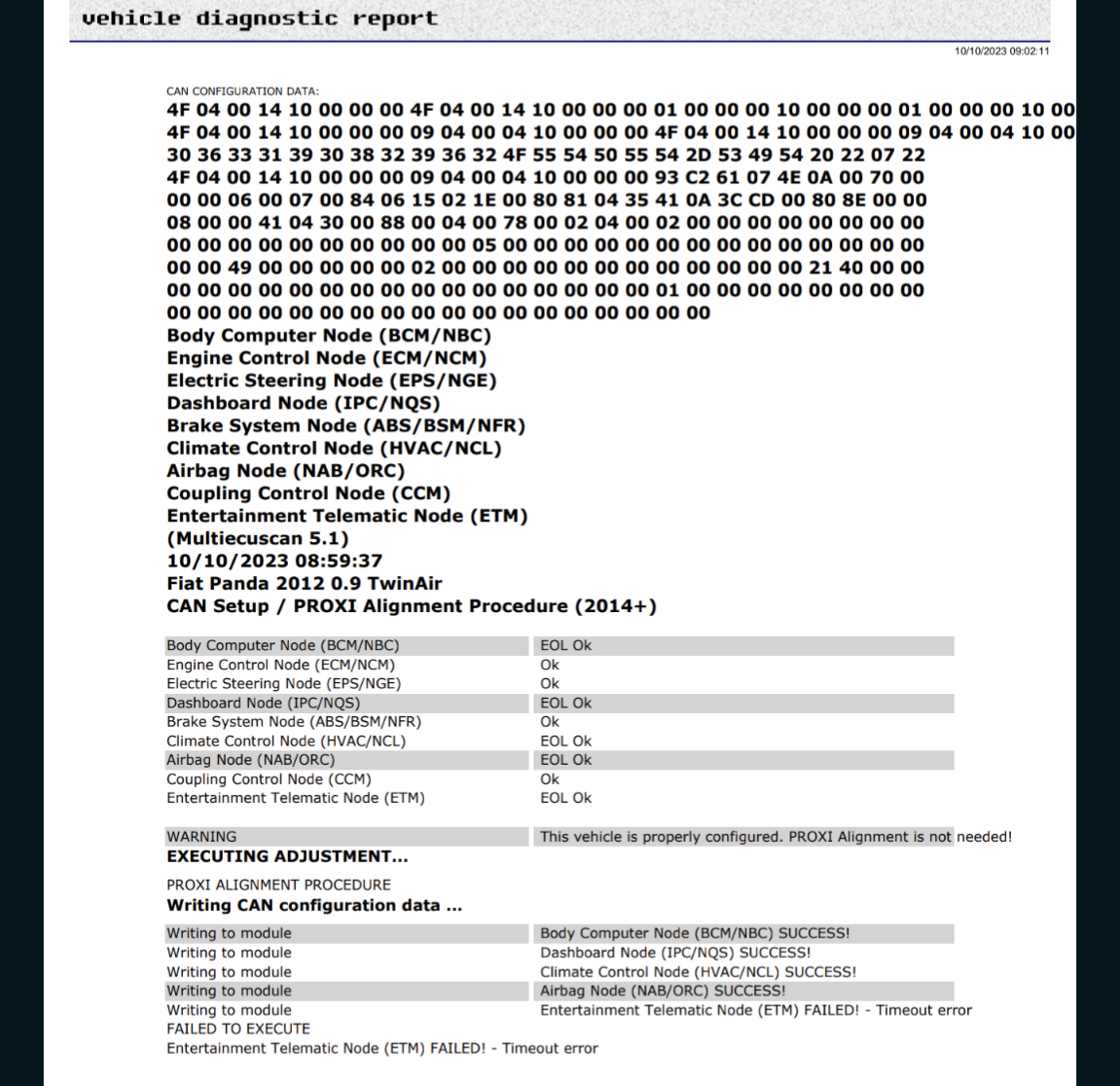

Good morning guys, having no luck getting my flashing odometer reset. I emailed Gendan who I bought my kit from who told me to contact the MultiECUScan support team and attached their feedback. I don't really want to attempt to remove the stereo to try things, especially when the reason I spent £110 on the kit was to hopefully plug it in and solve the issue. Surely I'm not the first person to ever fit an aftermarket stereo? I've also attached my report showing the timeout error.
In a nutshell the standard headunit was removed and replace with a Pioneer unit, reversing camera and Connects2 leads.
