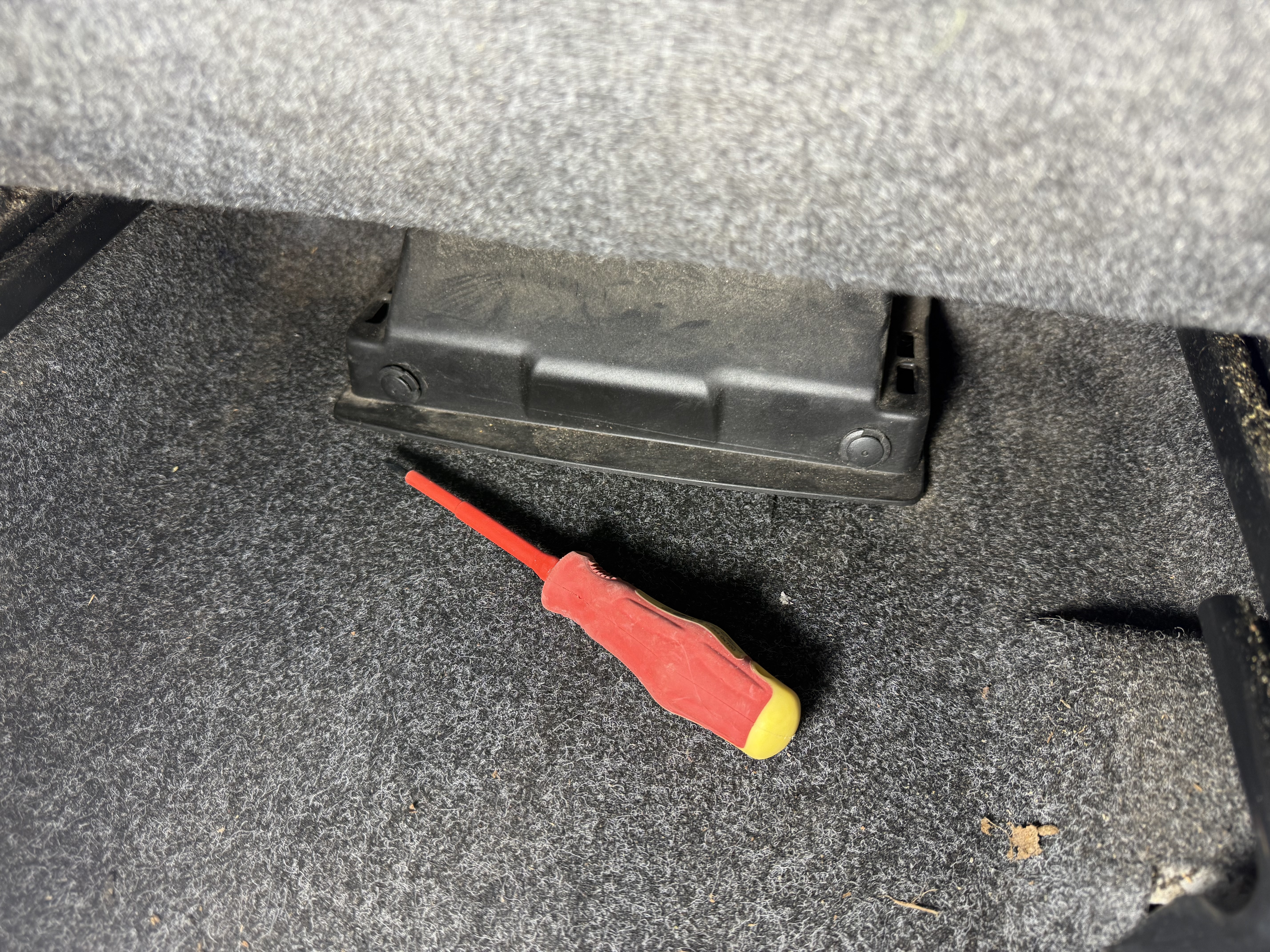

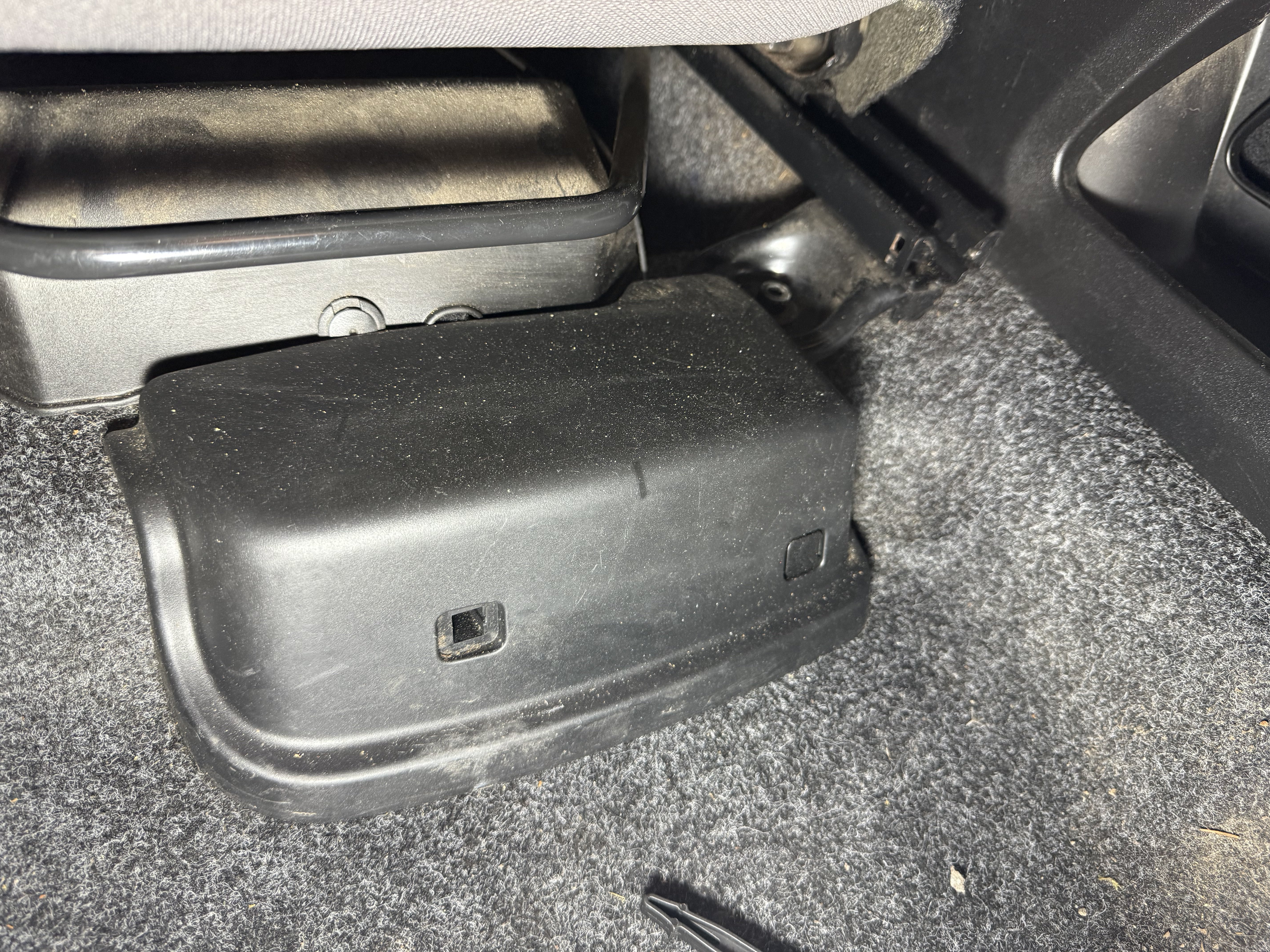

Back to the Panda after a week and the battery is totally flat. I decided to remove the B&M module to see if that will stop the drain.
Much easier to get to than on a 500 by the looks of it! Seat still in place. Removed the trim from under the front of the drivers seat (pull out 2 x plugs then pull forward)
Then removed the single plastic retaining peg from the front of the B&M cover and two from the back…
The module is secured by 4 x 8mm nuts. To remove the loom plug, first depress the little tab (arrow on first photo) then pull the black lever back which pulls the plug out (arrow on second photo)
Apologies for the ropey images- just thought it might be handy for anyone else who has similar trouble.
Let’s just hope that was the reason for the battery drain 🤞
A picture paints a thousand words, as they say. Thanks for posting them.
Images are in fact brilliant. On the 500 you cant see how it works
