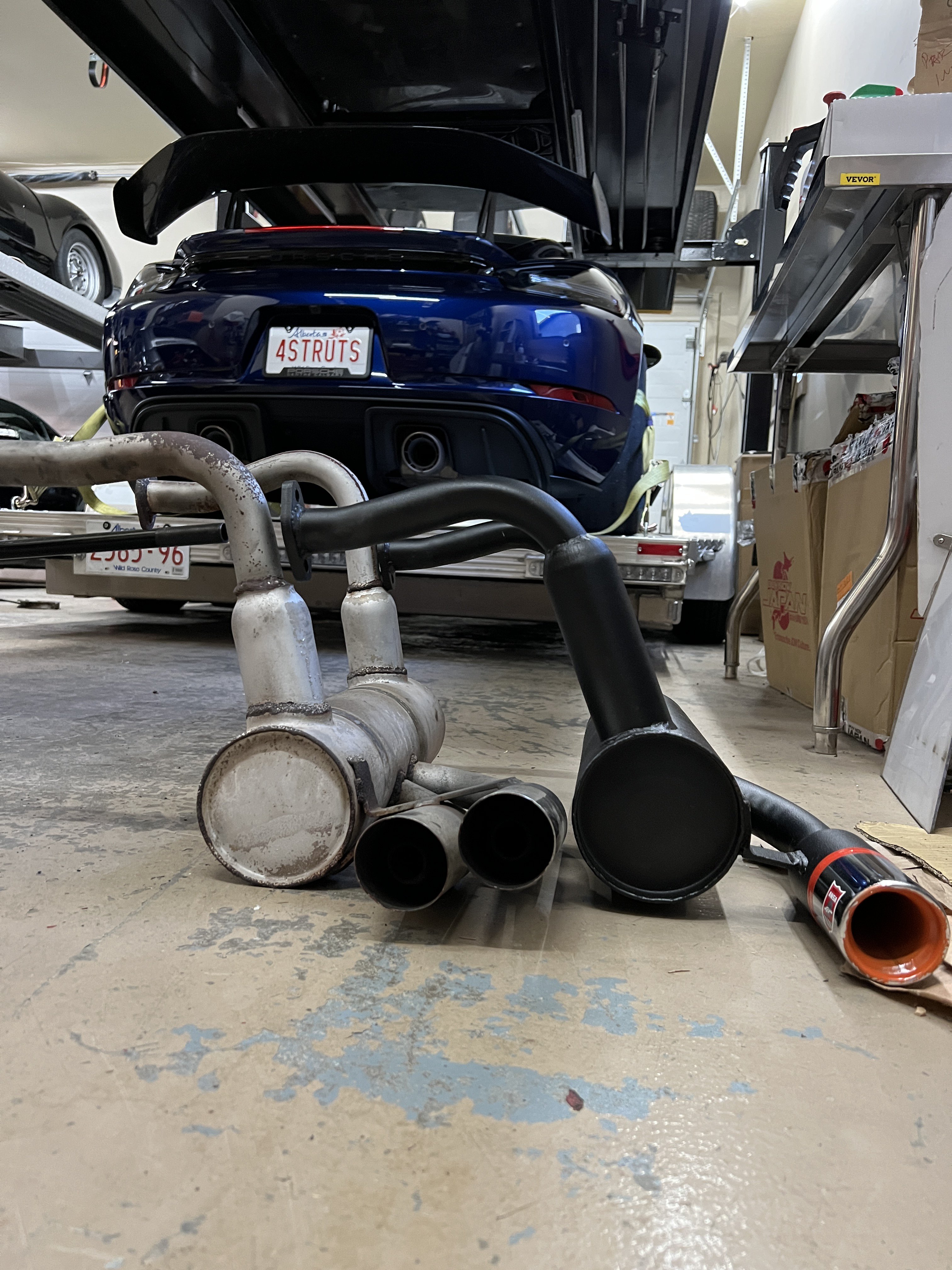

The F/L muffler sits higher than the R/126 but I am wondering if the brackets that bolt to the block are interchangeable so that a system from one can be used on the other?

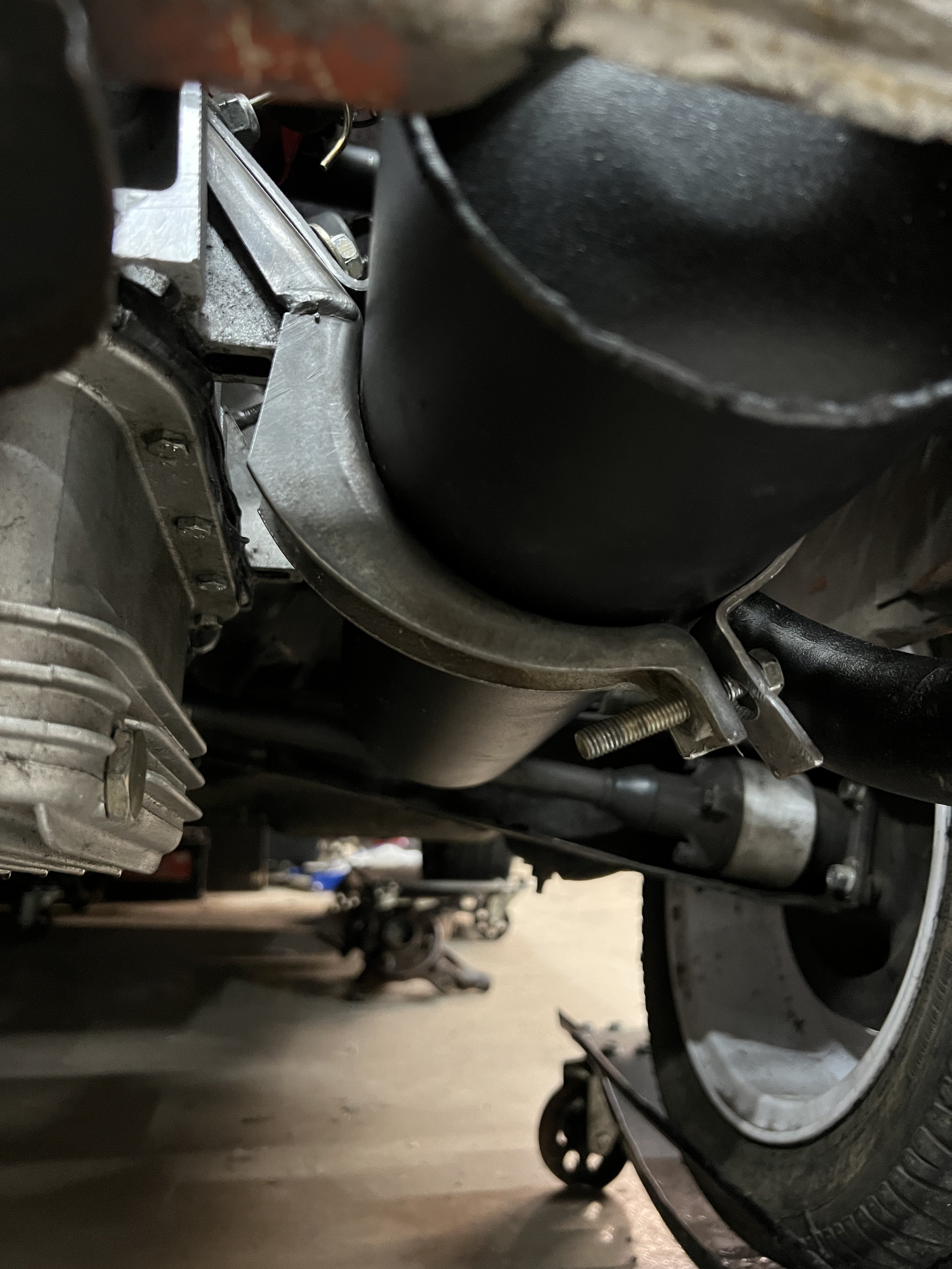

Understood. I believe I have ended ordering an F/L muffler for my 126a block. Debating now what to do. Does anyone have a picture of the block of a F/L in this area? Here is how my muffler is currently sitting in relation to the studs.

I don't think it will fit unless you use some serious heat on the pipes in a few plavces and do a lot of precision bending. I would cancel that order and get a 126 exhaust system and matching brackets. Do you have the 126 thermostat cowling?

The exhaust is an ANSA unit made for an F/L

The ANSA exhaust I purchased has a muffler with an identical diameter to the exhaust I removed from the car that was supported by the OEM clamps.

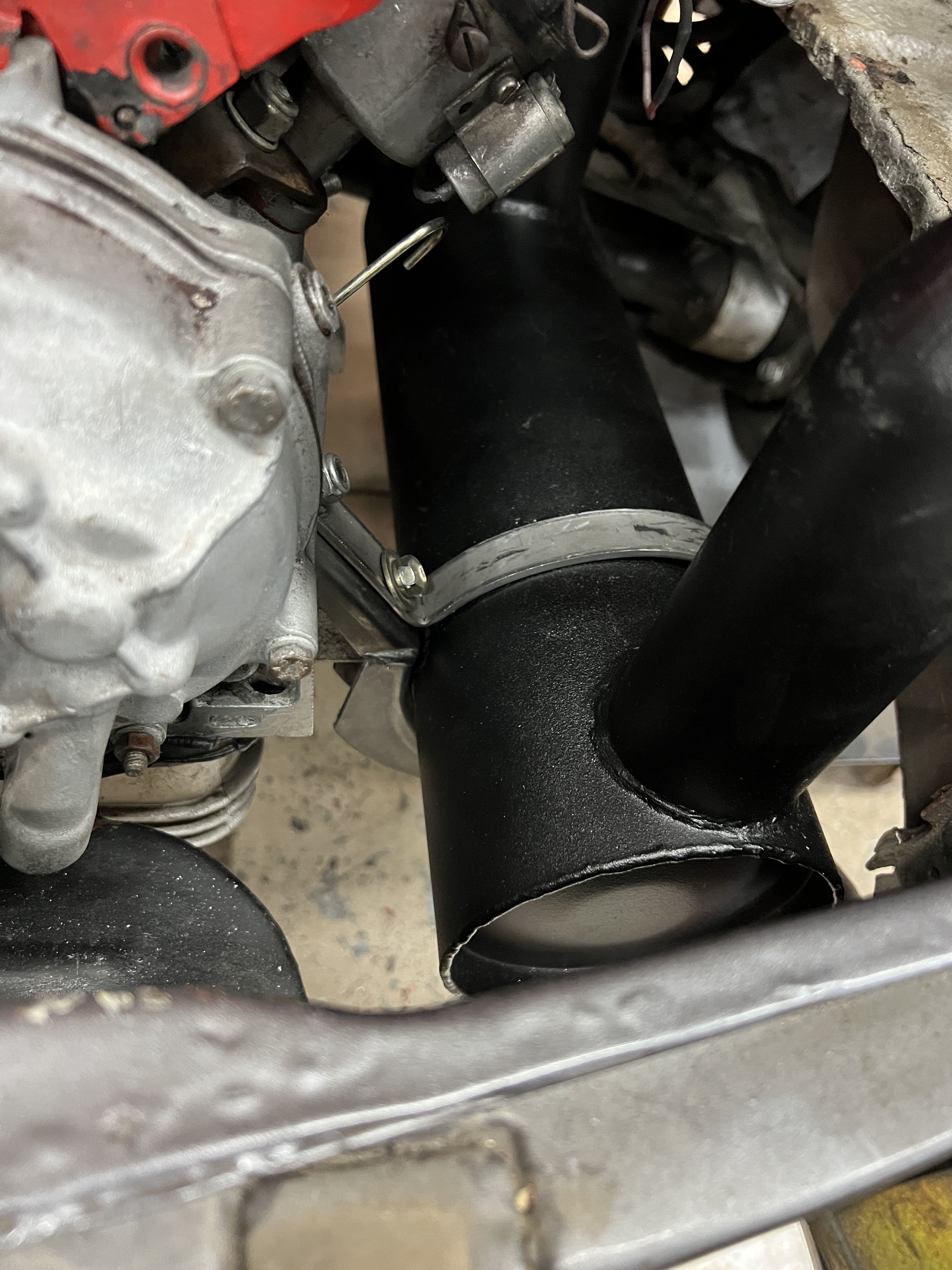

Unfortunately, modifications will be much more involved that slotting the holes. The muffler sits a coupe inches vertically higher but the clamps both have no where to slide up without hitting the engine. The surface that holds the studs is at some angle.

Thats unfortunate. Looks like you might have limited options. Either have a new exhaust bracket made, or lengthen the exhaust down runners to allow the resonator chamber to sit in the bracket.
Very odd that although the pipes are the same style, they dimensionally are different. The old one you had is definetly one of the sport style mufflers. Shame that its different.

Hi Sprockett, I've had the same problem, my hybrid engines are both fitted with 126A crankcases from the 126 not the 500R. One modified exhaust system (CSC Marmitte) fitted straight onto the engine with no problem, but an unknown 'sport' exhaust originally fitted to my engine had the rear downpipe cut to shorten it and the car engine bay butchered to allow the forward downpipe to fit. One set of clamps fitted, the new set for a 'sport' exhaust did not. Like yours they were miles out!!! So I had to carefully cut, bend and weld the offending brackets to fit - it's a great job for a weekend if you're lucky (maybe two). Because the brackets have some semblance of a curve you can cut and bend them to shape, an acceptable finish is dependant on how much of a faff you can withstand:sneaky::sneaky::sneaky::sneaky: clean all the welds up with an angle grinder and a lick of paint and hey presto!!!!! or maybe send them back????
@Bleeding Knuckles thanks for the pics. My intention is to attempt to modify the longer R/126 supports I have to fit the shorter D/F/L exhaust I purchased. I have already confirmed it bolts up the engine just fine and only the supports are an issue.
