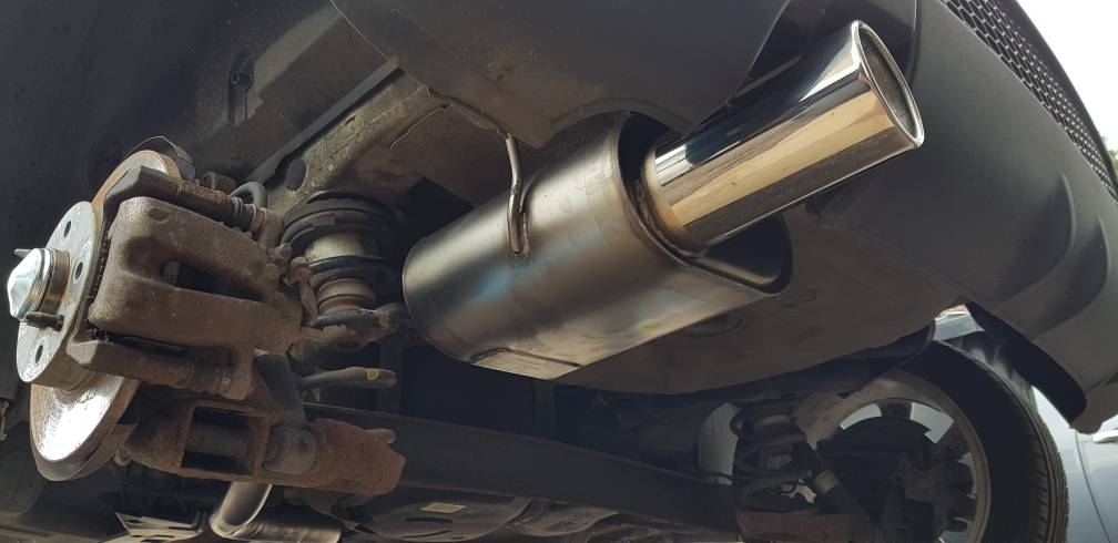

edit: forgot, a crack appeared in the mid-pipe silencer, tried to weld it up but it only lasted a week before it started leaking again. So need to sort that out soon too, I have a plan but i don't know if it'll work yet so I'll update on this further once i have messed with it, parts are on their way for this already.
Mine has developed an exhaust noise. I suspect it's mid pipe. They really need a brace from the pipe to the silencer case but that would mean selling fewer silencers.
I might see if a universal stainless silencer will fit.

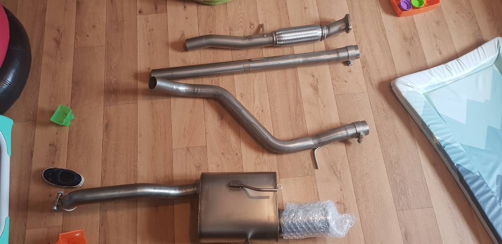

Exhaust wise, i have some bits here now, just need some time to fit it all up, same goes for the belts etc.

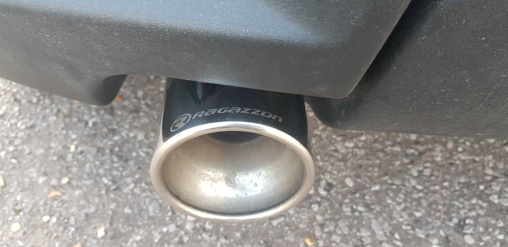

its the normal ragazzon rear box with the group n middle section.. Its obviously louder but its not offensive at all. Has a nice burble to it at idle now but its not loud or droning cruising at motorway speeds. Tbh if you go WOT once you get halfway through the revs the noisiest thing is still the intake not the exhaust, it seems to be loudest on overrun the exhaust. Doesnt really do any pops or bangs at all no, but i suspect if it had no cat on it then it would be popping and banging.

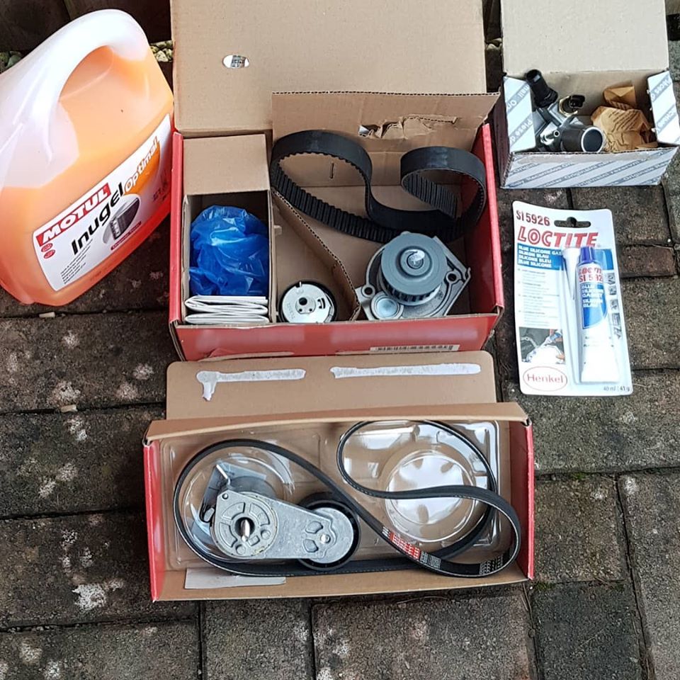

Well nothing exciting to update here, just boring servicing stuff.
Took advantage of the nice (for january) weather at the weekend and got this little lot fitted.
So thats Gates branded timing belt kit with tensioner and waterpump, Gates branded aux belt and tensioner, genuine new thermostat.
Timing belt looked pretty old but not too bad in the grand scheme, I've changed much worse looking ones lol - but old enough to not be able to make out any brand or part numbers beyond a made in italy marking. And the waterpump was an unbranded one with a cheap nasty plastic impeller and way more sealer than is required - proof someone has been in there and changed it at some point which i guess is a good thing but i suspect prior to the previous owners ownership, can't see Freebo as the type to use the cheapest nastiest parts available haha. Aux belt on it was gates brand so thats been changed along the way too but it was in pretty bad condition, muchos cracking. So all in all pretty happy i decided to get all this done. The stat, well that didn't give me any reason to want to change it but as i was there with the cooling system empty and tis only 2 bolts i figured why not.
Thought i had stuff to do an oil change already, but if i do i have lost it in the house move :bang: So thats ordered and en route. Only other thing to report is ABS fault - I had this come up once ages ago and MES reported a rear sensor, cleared and it went away but its back now and constant - sensor ordered.
edit: OK, scrolling back a few posts i dont think I have mentioned that I have recently cleaned the air filter - again kinda boring and i probably didnt post it as it would have been a hugely boring post lol

You are correct, I'm not the type to knowingly use those parts, OEM or decent off brand at as push for me. From memory it was all done before I bought the car unfortunately, might be mentioned in the service book? Was one of the reasons I went for it as it had been done at the right time/mileage for the engine unlike many many others I saw at the time.
I thought i remembered you saying it had been done but wasnt sure.. and figured that we have had it nearly 2 and half years now, and you had it since late 2015, so even if the mileage isn't at the interval yet its certainly been almost 5 years so decided to just do it.
If done at the correct mileage, without looking it up i think thats about 50k, its just clocked past 80k so approaching 5 years and 30k seems a reasonable time to change it all. And its not an expensive job if you do it all yourself (y)
I've got one of the cheap timing kits. I have done it without though if you dont have them.. I bought one as I've ended up doing the job quite a few times being that i had a valver in my old cinq, i looked after my mums old punto sporting and we bought the 100hp, along with helping others Ive done this quite a few times now lol.
Timing is not done at TDC on these, its done when all the pistons are level. So if you get 2 long thin things exactly same length, bit of welding wire or something, whip out the plugs and put the 2 things in plug hole 1 & 2. Then take out the allen head screw on the front of the head. Then turn the engine over (from the crank not the cam) until the 2 long things are exactly level with each other and put your finger in the hole on the head to feel if the slot in the cam is facing forward - if not turn engine until level again and poke your finger again. When its in the right place (iirc its with no.1 on the compression stroke but the slot on the cam only lines up once and thats the right spot) use an allen key through the hole into the slot on the cam to hold the cam - iirc its either 10 or 11mm fits in nicely. You could mark the bottom pulley at this point if you so desire but you have the things in the plug holes showing you its not moved so not 100% necessary.
Now everything is in the right place, undo tensioner and remove belt, crack the front cam pulley bolt loose, just loose enough that it will spin on the cam. Put the new belt on and tension it with the tensioner, then nip up the cam pulley bolt (tight af, you dont want that backing out!!!)
Turn it over by hand, at least 4 full turns of the crank so the engine has done 2 full cycles, make sure the little indicators you have used in the cylinders still line up level with the slot in the cam points towards the hole.
Job done, well bar putting putting the bolt back in the head and refitting the engine mount and belt covers etc.
