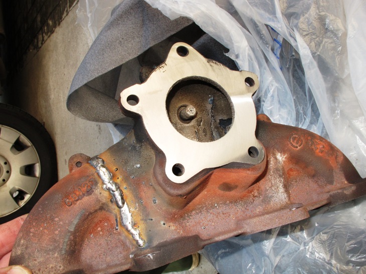

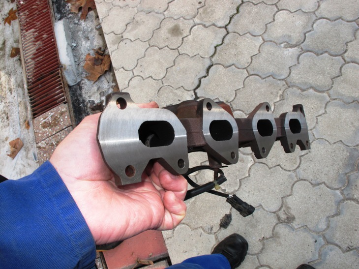

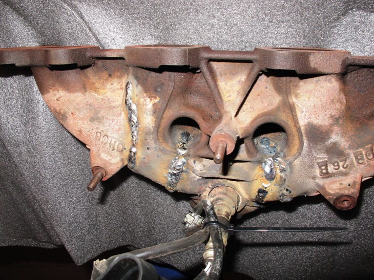

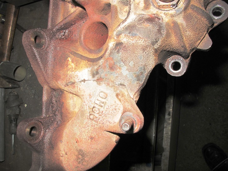

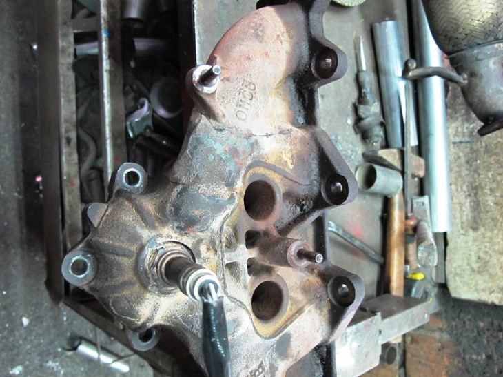

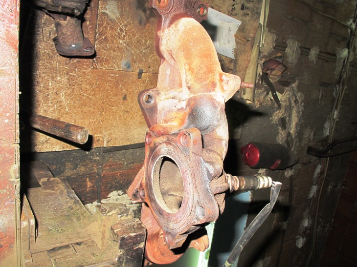

I have problem, multipla 1.6 BiPower in idling no consrtant and small rpm,
problem is standard, carack minfold exaust
look picture
cracked 4 lines
welding
and prepar to montage

Hi, in idle on CNG is no stabil RPM, very, very small big noise on small rpm, problem is no big, you dismaintance minfold exaust, carfuly velding, and clining vith machine sanding...
