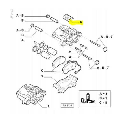

That's the front brake (without the disc):
Is the spring you're talking about marked as number 6?

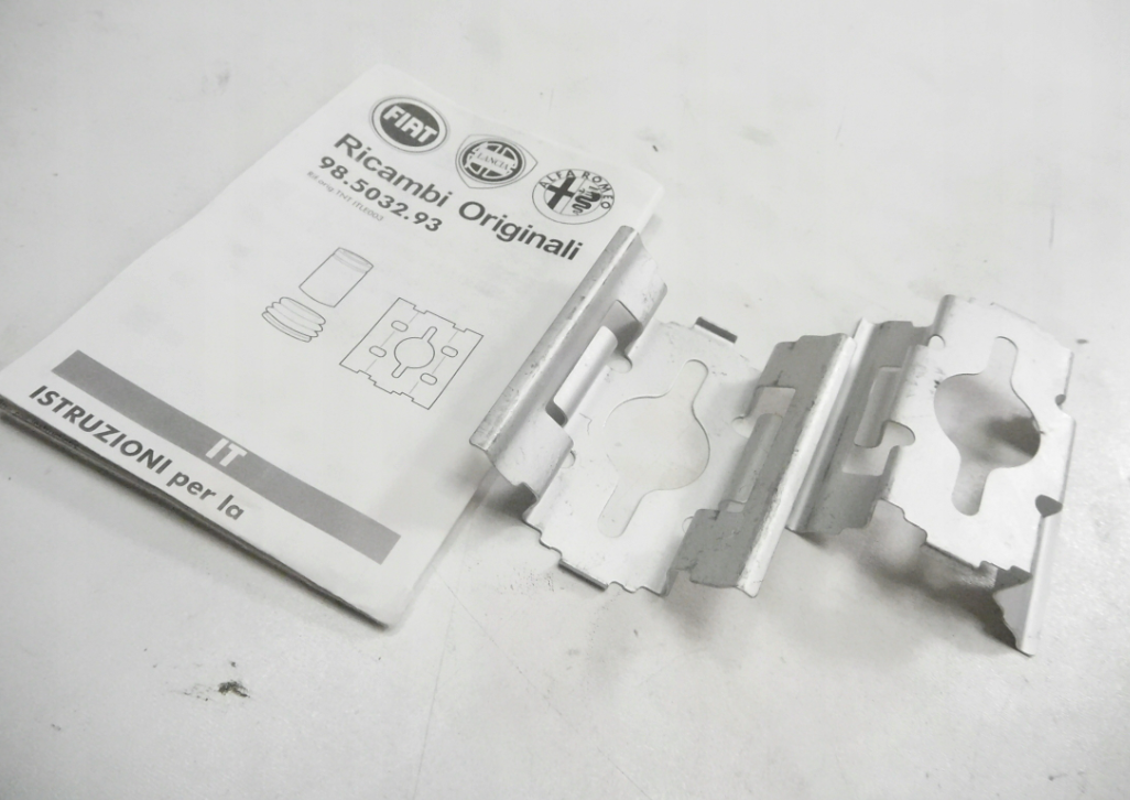

The spring looks like this:
If so, they have the original repair kit, the part number is 77365104.
But again, you have to confirm it is the right one for your van, as they messed with the brakes :D

There should be another repair kit with the elements marked A, B, A-B etc.
Yep that looks like the bits i need. Thank you for the help and diagrams, much appreciated 🙏.
