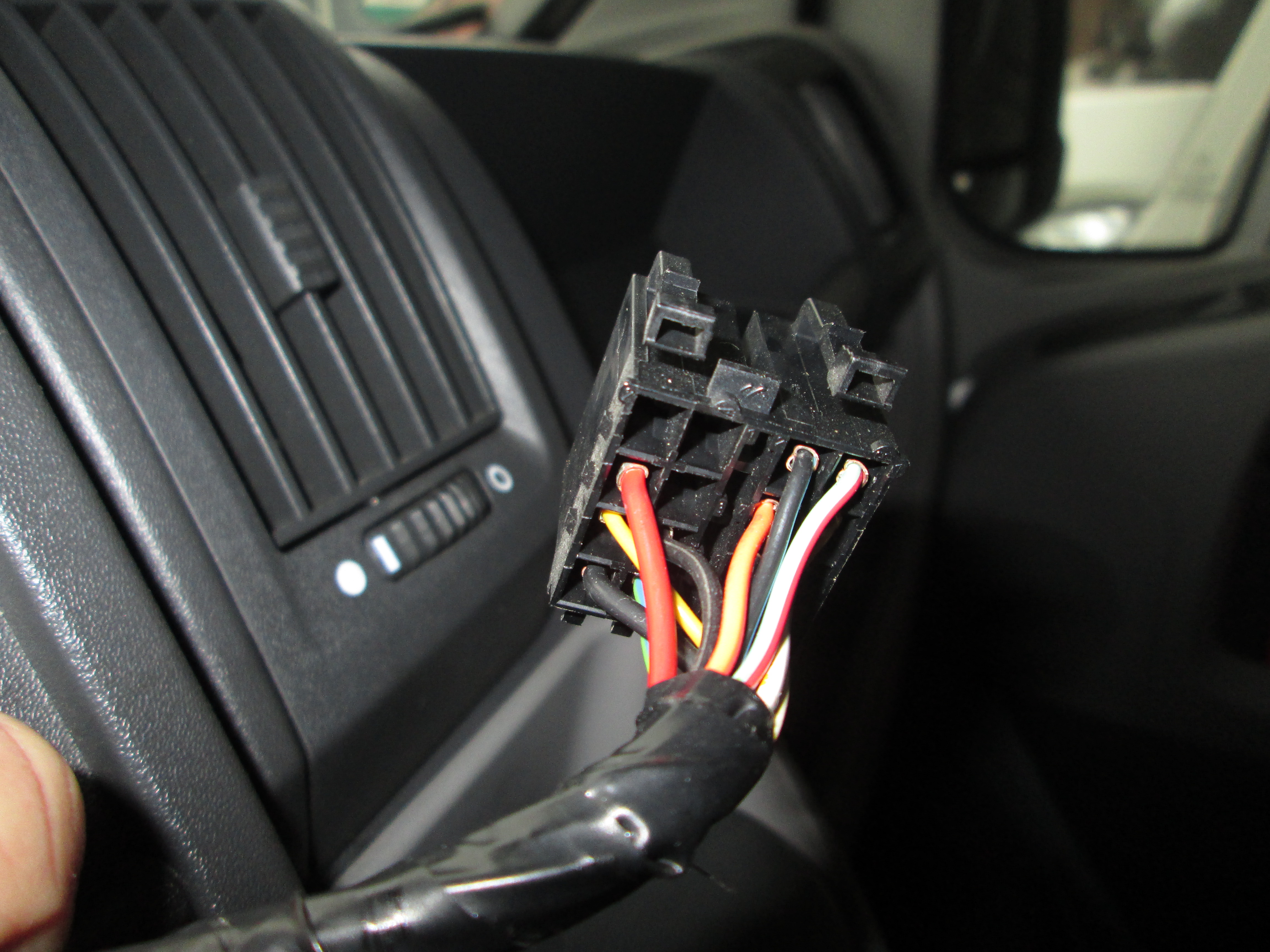

We have a Fiat Ducato Knaus camper, and I want tot assemble a Fiat Uconnect Navi in it. I've bought it from a gentleman who wanted a bigger screen in his new 2015 car, including the radiocode..
But our Duc is made in 2008, and I do not see the Canbus wires in the Iso plug in the dash at A1 en A3..I thought my car would have Canbus wires, but no...(n)(n)
Is it possible to mount wires myself from te body computer Can bus, to the Iso plug? (can high and can Low). :confused:

The connector shows the canbus pins in the picture.

Have you tried a unit at the Dealers they are a load of rubbish. Maps seem to be only available when Fiat decide on an update. POI's can only be loaded one at a time not downloaded in a block. It will need the CanBus to operate properly as otherwise it will not turn off when you switch the ignition off and will not know that it should dim the display when you put your lights on. I take it you are trying to fit it in a X250. If so you will need to connect into the can bus which you can pick up off the OBD2 Connector. Only problem with doing that is that the vehicle CanBus is not going to be happy as it will find an entertainment module that it should not have. This is not a major problem as all it will do is flash the mileage on the speedo. You need to get a PROXI reset from your FIAT Dealer to sort this. However once you do that the date and time functions may dissapear from the MENU Button and you have to change them via the radio / sat nav.
Well how do I know all this. I took my UConnect5 out and left it on the shelf in the garage. I then tried to fit a New Blaupunkt 945 unit. Mine is Fiat X290 Motorhome. Sounds simple but it's not. Which is how I found out about the CanBus because without the UConnect5 unit in the CanBus was not happy and the Date / Time and Mileage Started flashing :bang:
I have now sorted all my problems and have a great Radio / Sat Nav fitted.
There are TWO Can buses CAN H and CAN L is one set CANHIS H and CANHIS L is the other set. I don't know if you need both sets to make it work. You may also have a problem getting the right connector for the back of the radio.
You will also find that this is a very very stripped down version of TomTom software and many of the TomTom functions like changing voices are not available.
