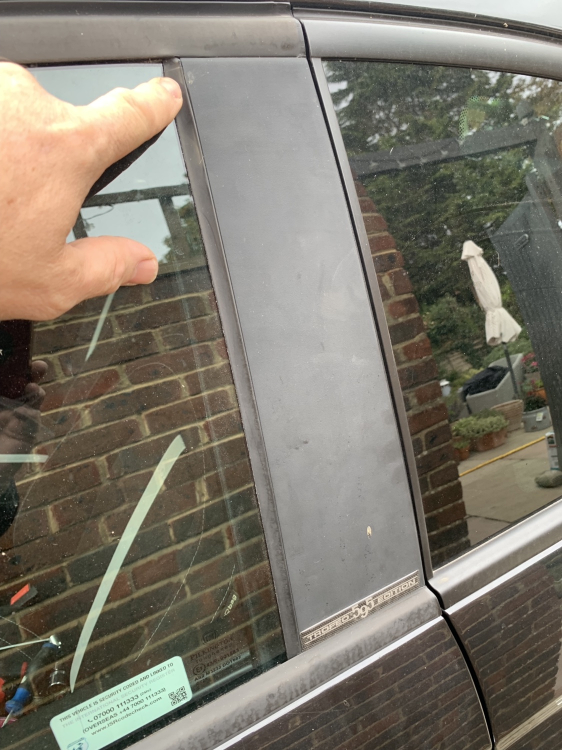

Our A500 has some really manky peeling B-pillar trims and I want to reskin them. Question is, do they just pop off or is there a more technical way of removing them?

They are held on by two torx screws. You have to move the door rubbers out of the way to get to them. Fiddly but once the two screws are out the just pull off. Fiddly to get back in too.

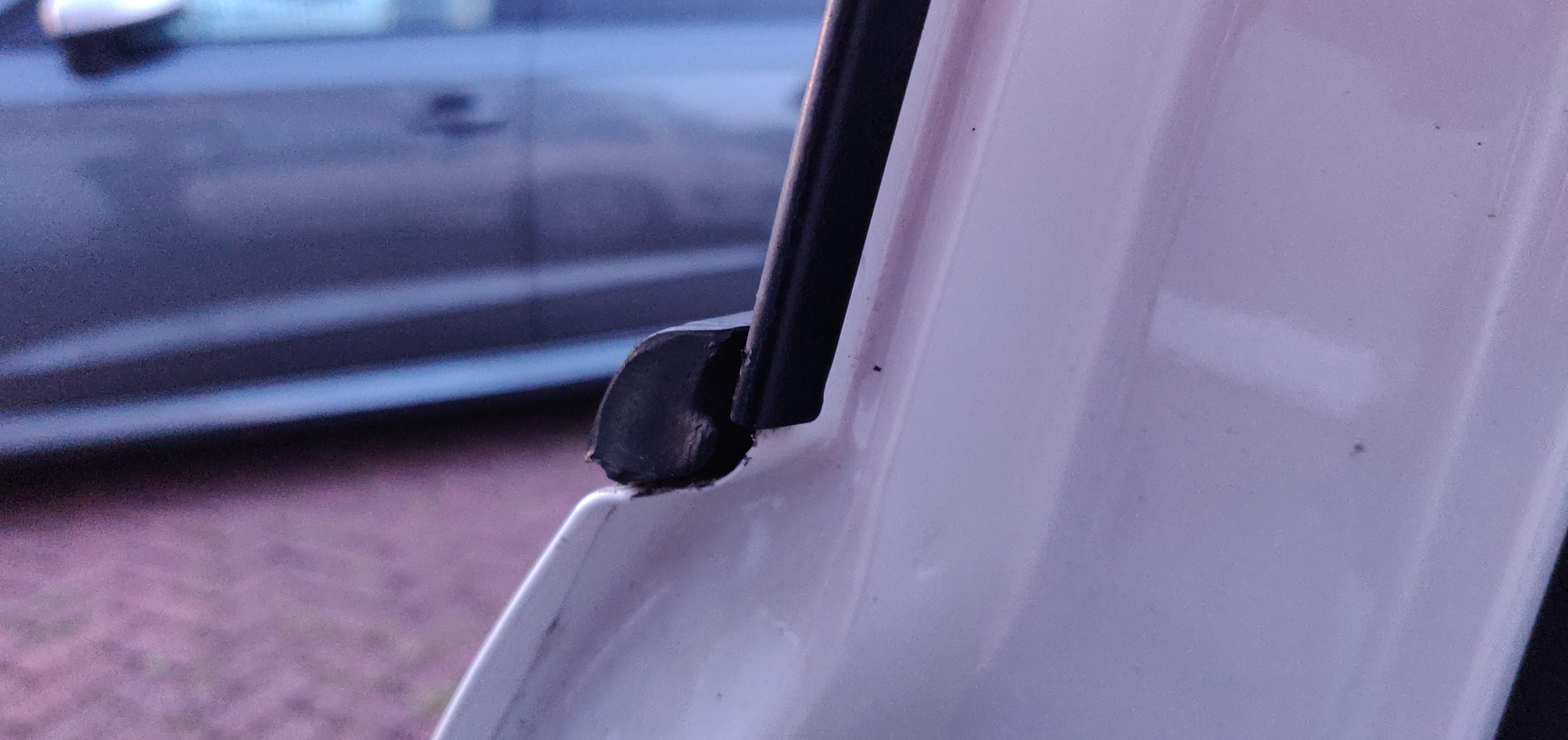

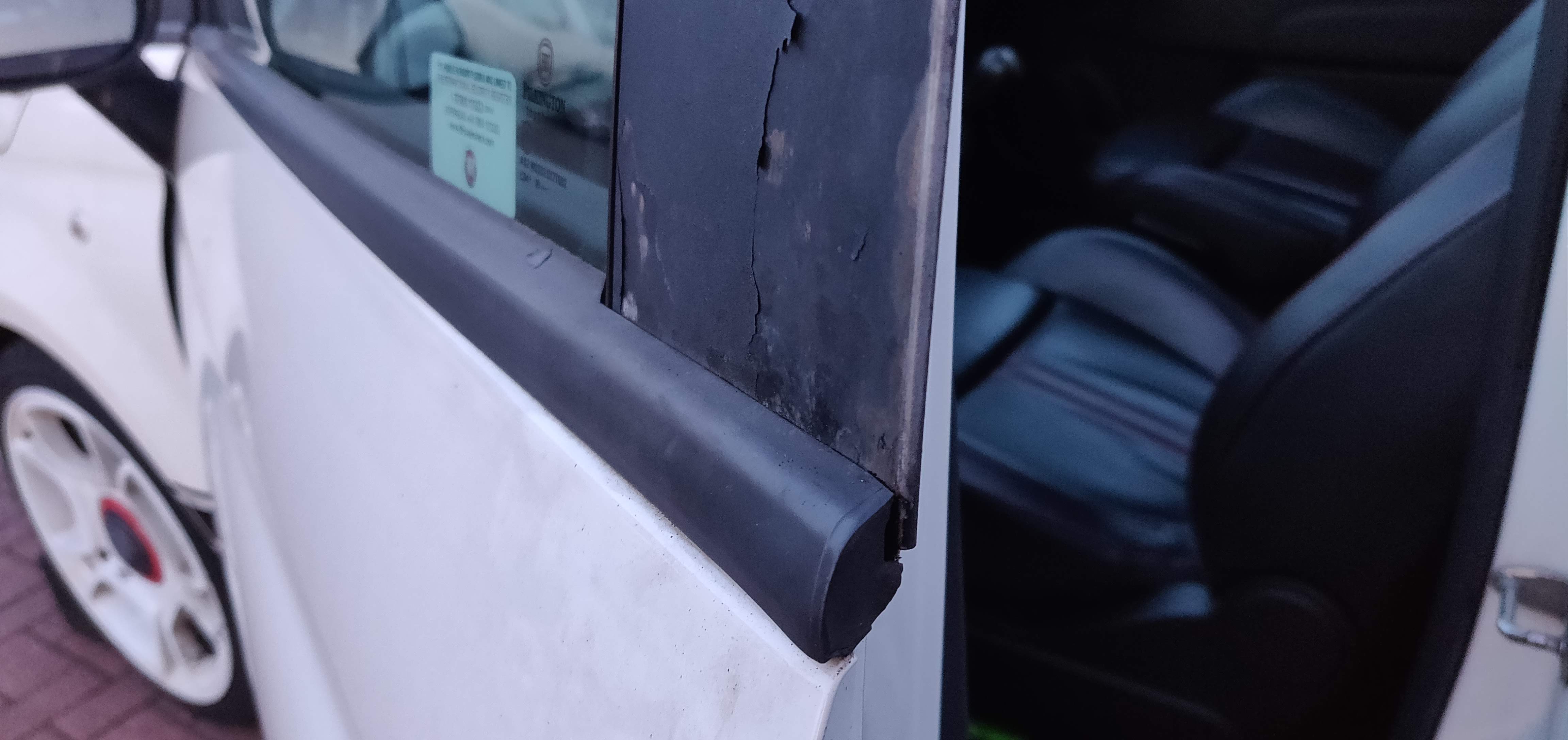

With regard to the seals, am I looking at the right areas (as per the photos I've attached)? Is there a magic to getting them off other than just prying them free?

This one is a 59 plate, so just touching 10 years old now.
I have a sneaking suspicion someone previously used something like an alloy wheel cleaner on them, or at least something a little more hardcore than soap and water.
I've certainly read online about the finish peeling on the trims but never beginning to corrode, though I guess if they are left for long enough that'll happen!
Dan.
