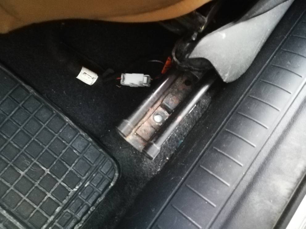

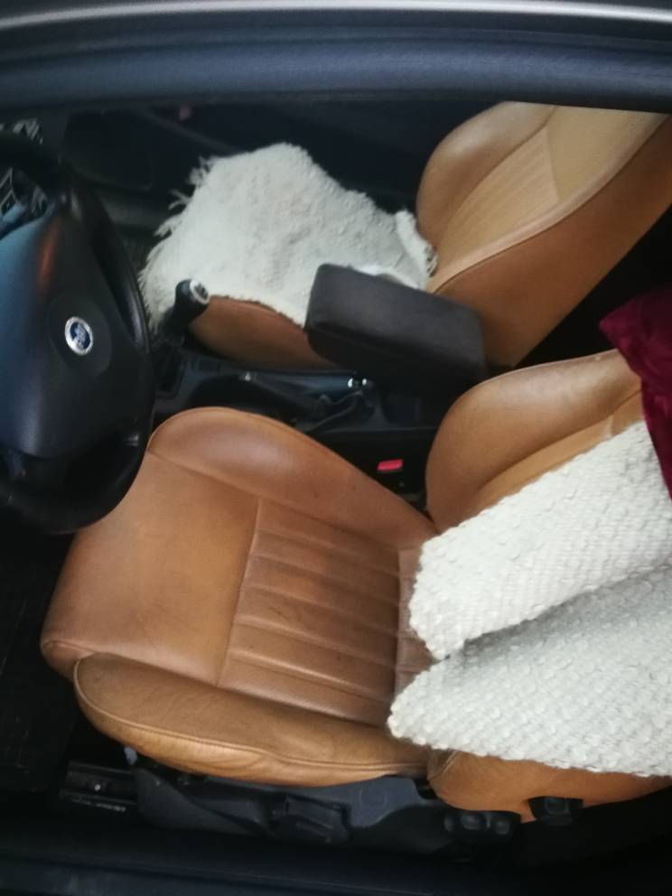

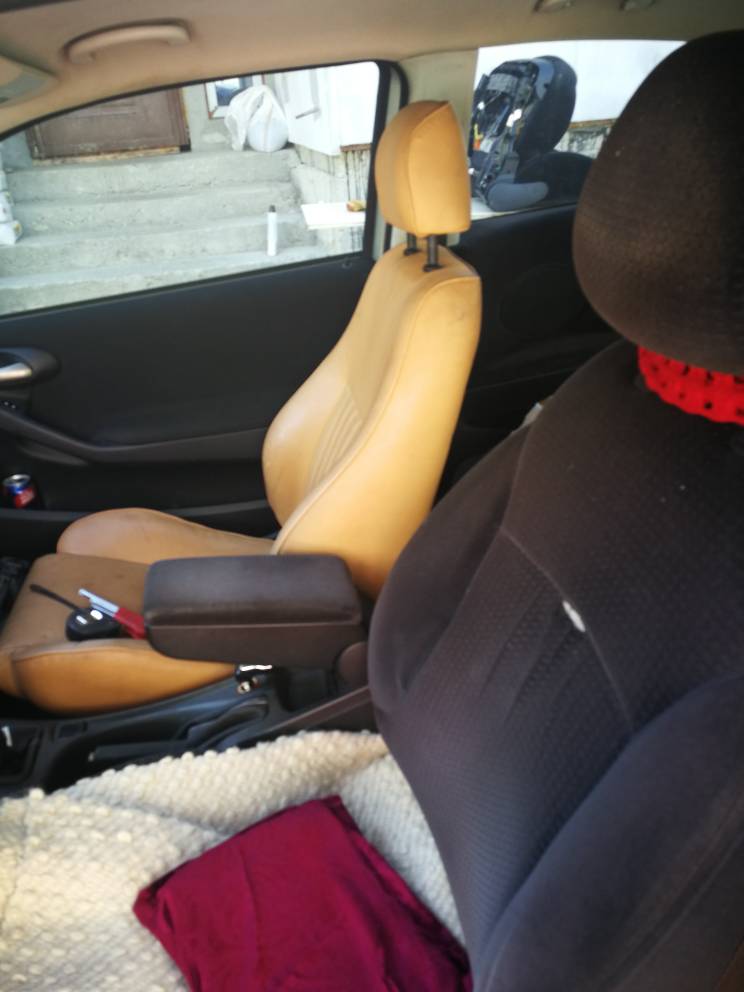

I swapped the rails from the old seats on to these ones and managed to fit them, the only problem is that on the driver's side one hole isn't aligned but that is not such a big deal, the seat is sturdy. and I also kept the seat belt lock from the old seats to fit the seat belt and the wires. IMG_20180420_202255.jpegIMG_20180420_160144.jpegIMG_20180420_202301.jpeg
.... well good news. after a morning of me and my dad messing around with a few ideas we fitted them using some little adapter brackets. iv taken photos of most of the things we did so if anyone else is going to atempt this, i can give some guidance.
anyway, very happy with the result, they looking amazing, hold you in alot more than my standard seats did and still are very comfy. I will be atempting to try and fit the back bench tomorrow if i get time. ( got to fit a new bottom arm on it.)
only other thing is that i havent connected the airbags up yet. I had a look at the wiring on the two seats. they both have 3 wires going to the plug which are the same colours aswell, blue, black and brown on both seats, but the actual plug on the alfa seats are different. should i just connect the matching colours and take a chance?
i just dont want to connect them and then have the airbags go off in the seat because iv connected it up wrong :rolleyes:
