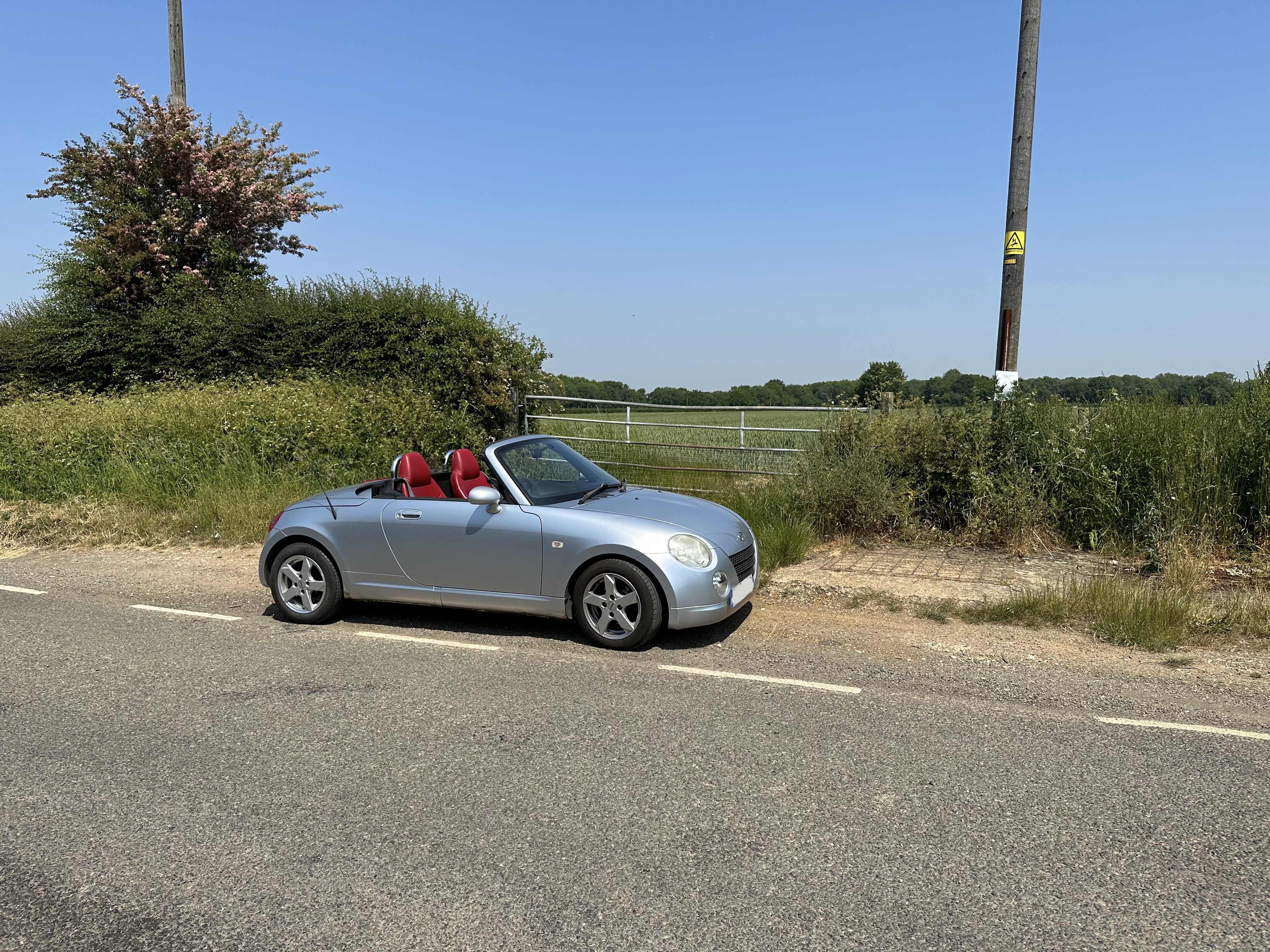

It's got some rust starting to appear but its last MOT was clean sheet, 1 owner from new, serviced annually and covered just 32k miles.
Oh and the roof folds down. I keep forgetting that and have only driven it once with it actually folded back :cool:

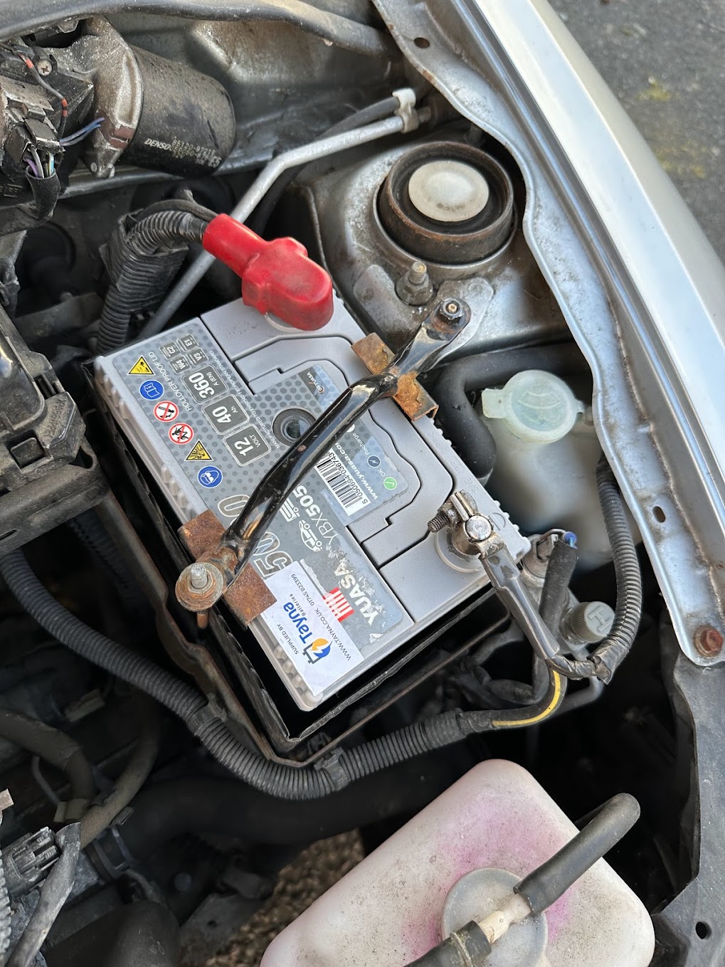

A fairly uninteresting update but I've finally fitted a much needed new battery, the old one still cranked the engine over fine but with any significant electrical load at idle the voltage would plummet and cause the alternator belt to slip. I had let it run completely flat twice so its not a huge surprise it's lost a fair bit of capacity and it was only rated 33Ah from new...
New Yuasa fitted, 40Ah, seems to be the largest capacity in this size. (Excuse my rusty battery clamp, much like the rest of the car it too rusts for fun)
What a world of difference its made though, no more belt squeal, holds its voltage much better.

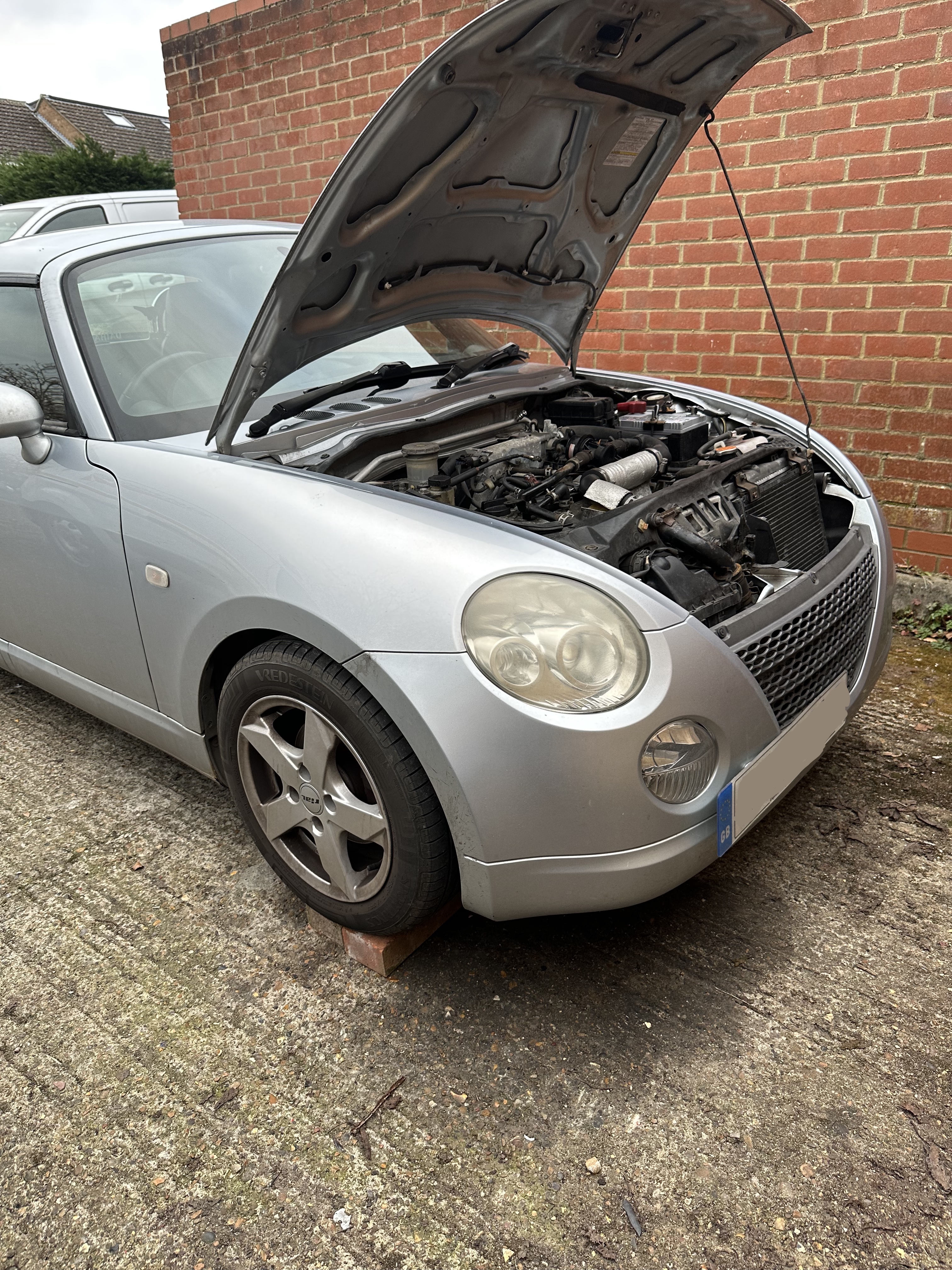

Made a start on it, have to drive it up onto bricks first as my jack doesn't even vaguely fit underneath it.
Checked I could get my new oil filter wrenchy thing onto the filter, no problems there so I dumped the oil. Removed the filter, its too big to go through the mount... 🤬 I really didn't fancy the remove the front end of the car approach in the cold so old filter screwed back on 😶

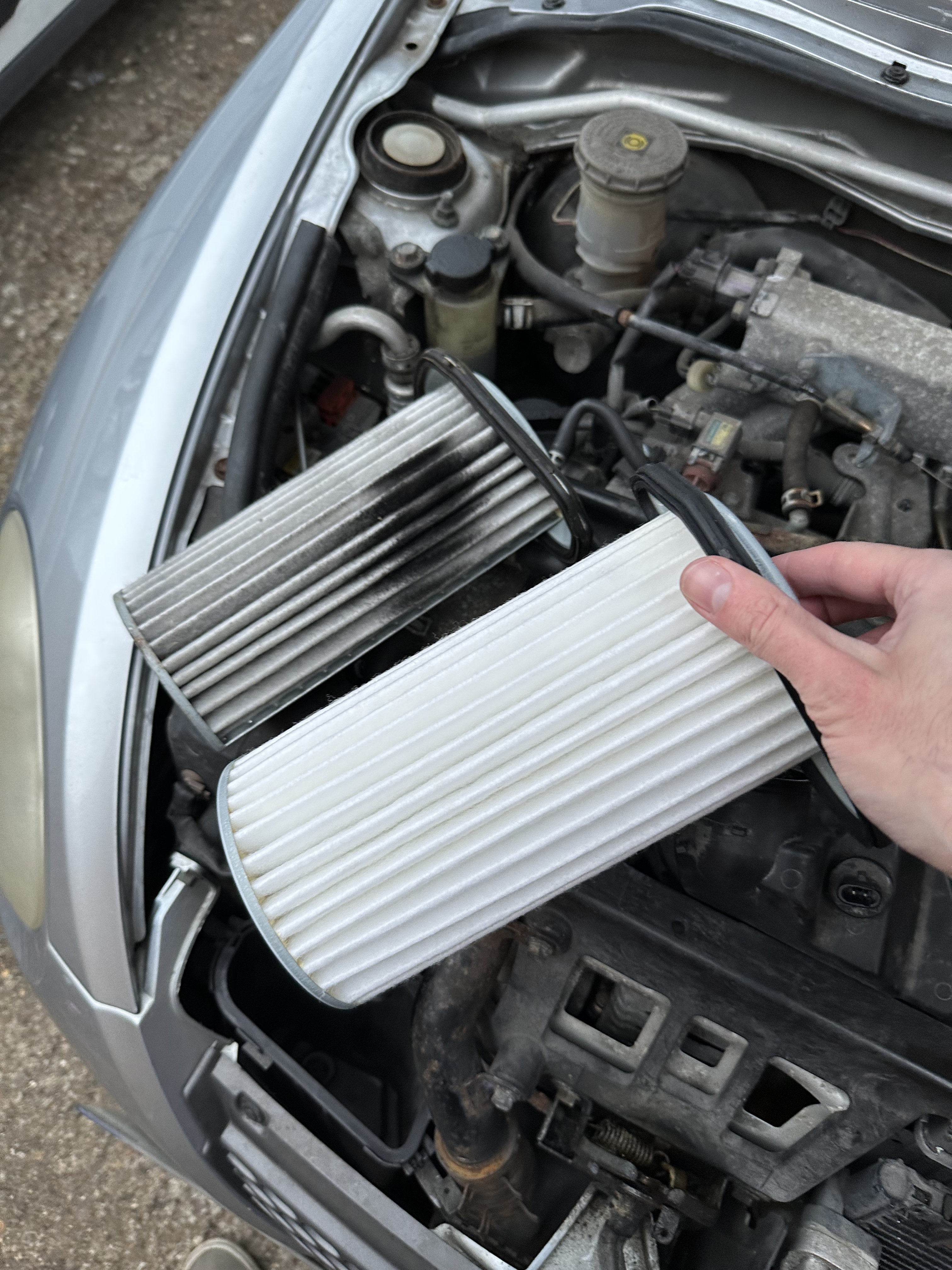

Fresh oil in at the least and I did the air filter which is just about the only easy job on the car.
It'll just have to manage with the old oil filter for a month until I can be bothered to do the filter change the hard way... At least it has fresh oil, that has to be worth something...

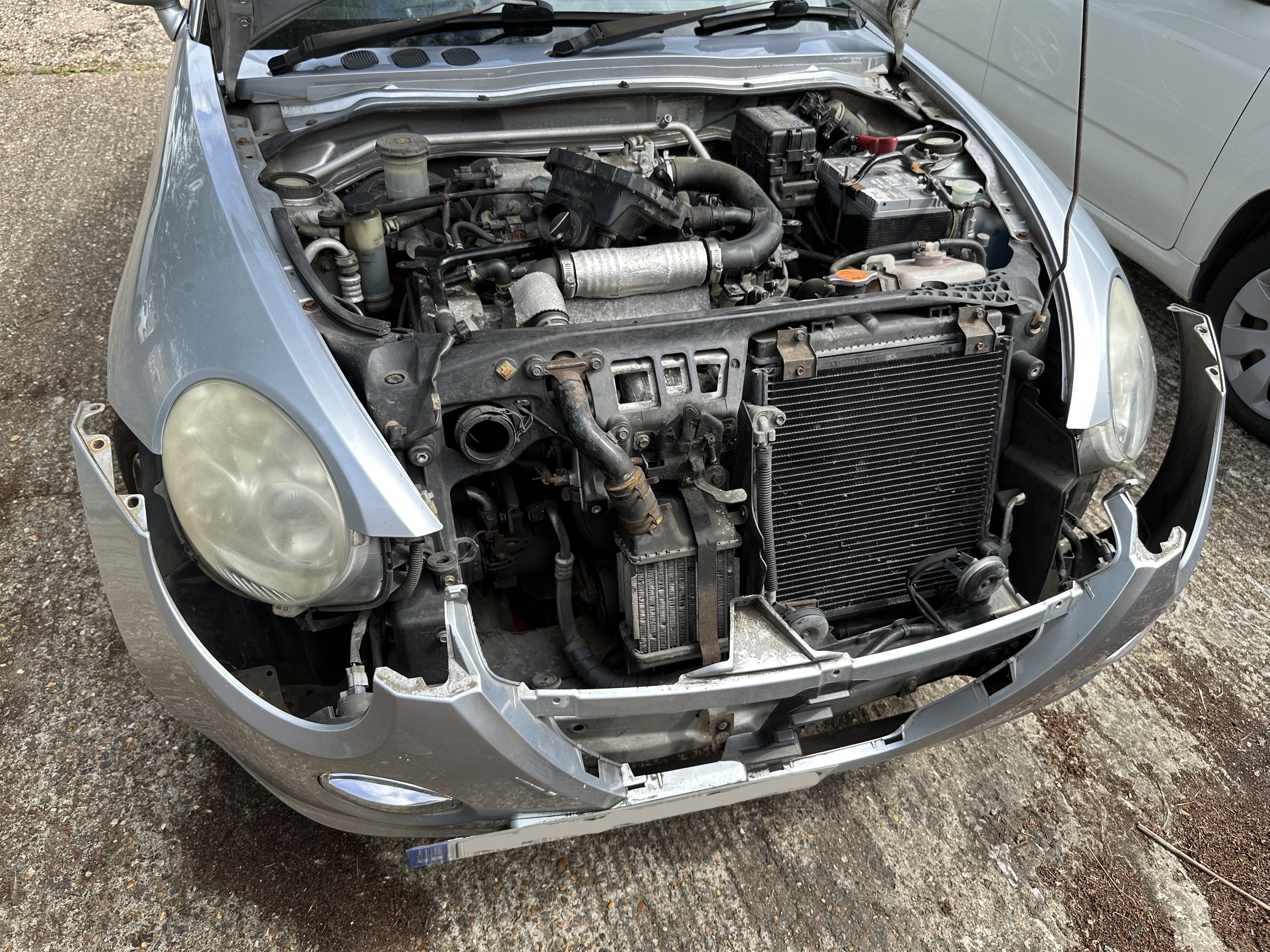

Finally pulled the front bumper, it was a pain as expected and even then you have to cram your arm through a small gap to reach the oil filer. Got there in the end and correct sized one now attached, hope to never have to take this bumper off again....

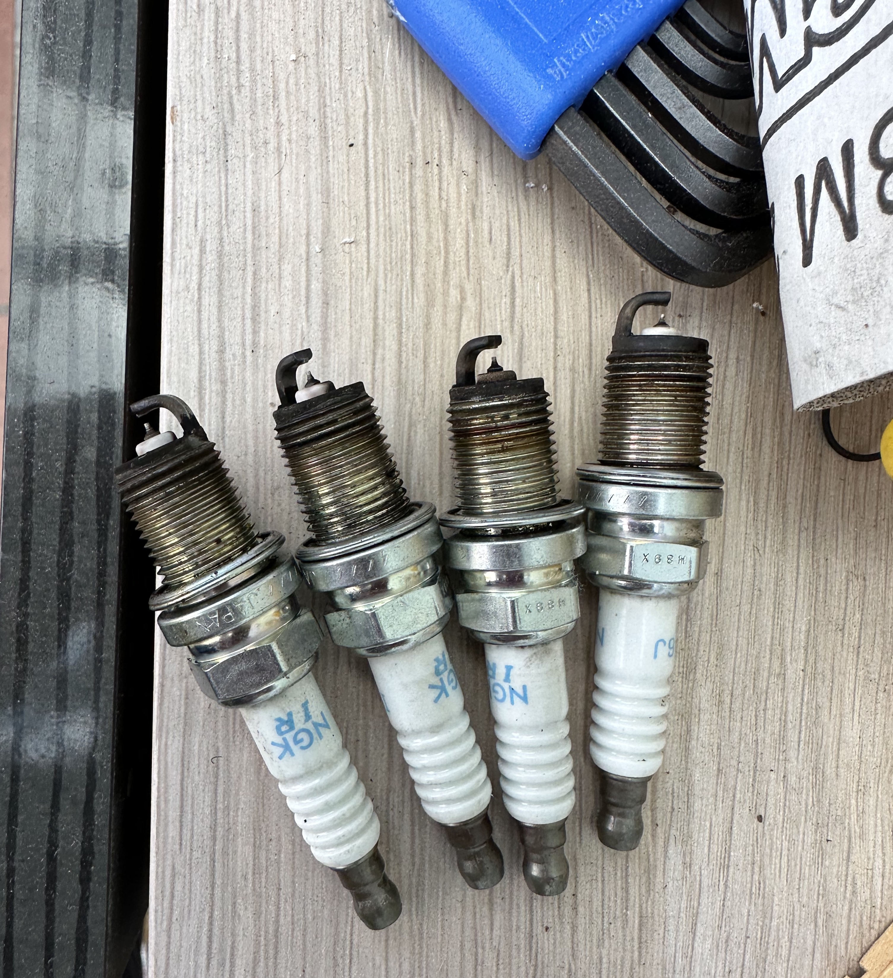

Changed the spark plugs, actually found an invoice for them having been done 14k ago so I was surprised how dark they were, I did run the car with a broken O2 sensor for a good while so may have contributed?

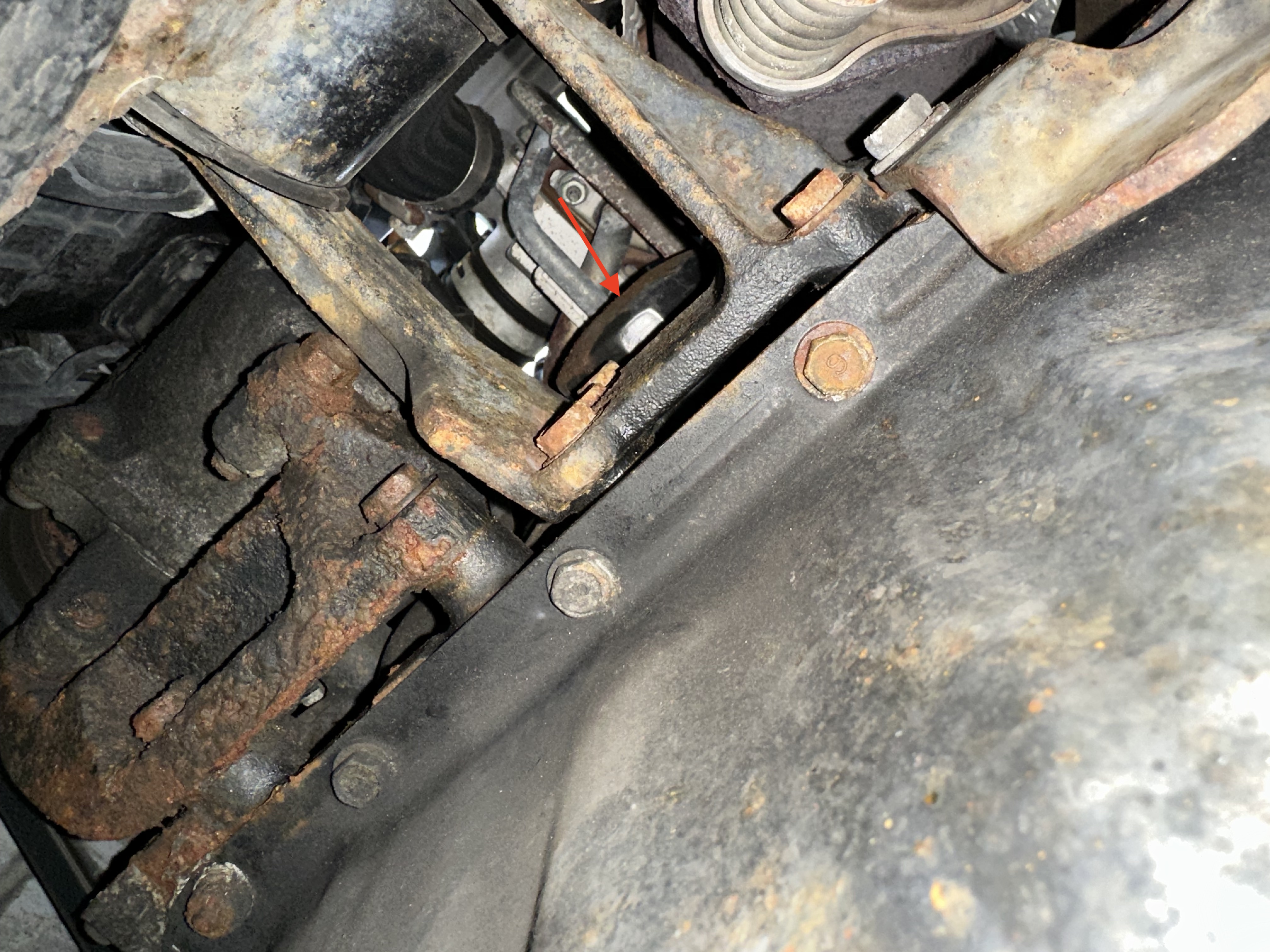

Had a fight with the alternator and lost, can't get the damn thing off access is pretty awful (wheel off and some arm contortion) but I can't get my breaker bar in and my spanners just don't give me the leverage. I will soak it in some plusgas next time I have a stab.
It is alarmingly close to the ground and I suspect the damage was done driving though a flood (not a deep one but then the car only has about 5" of ground clearance) so I suspect the alternator saw a good drowning. Will have to get the sills addressed early spring
