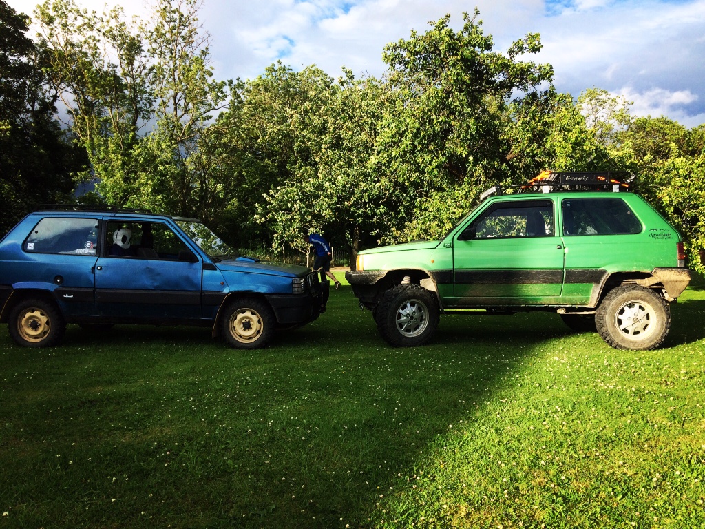

Our diy kit covered all of the above items
But went a little further as we fitted over size wheels+28%
And increased track wheel base
But it is far more involved
By dropping the engine and lowering all body to suspension. Connections by 50mm , this method requires the vehicle to be completely stripped and accessible A lot has been learned from the various stages of IMG_1507180208.101938.jpgThe result

By dropping the engine and lowering all body to suspension. Connections by 50mm , this method requires the vehicle to be completely stripped and accessible A lot has been learned from the various stages of View attachment 184846The result

I was going to say no till I saw those images....tempting...:slayer:
