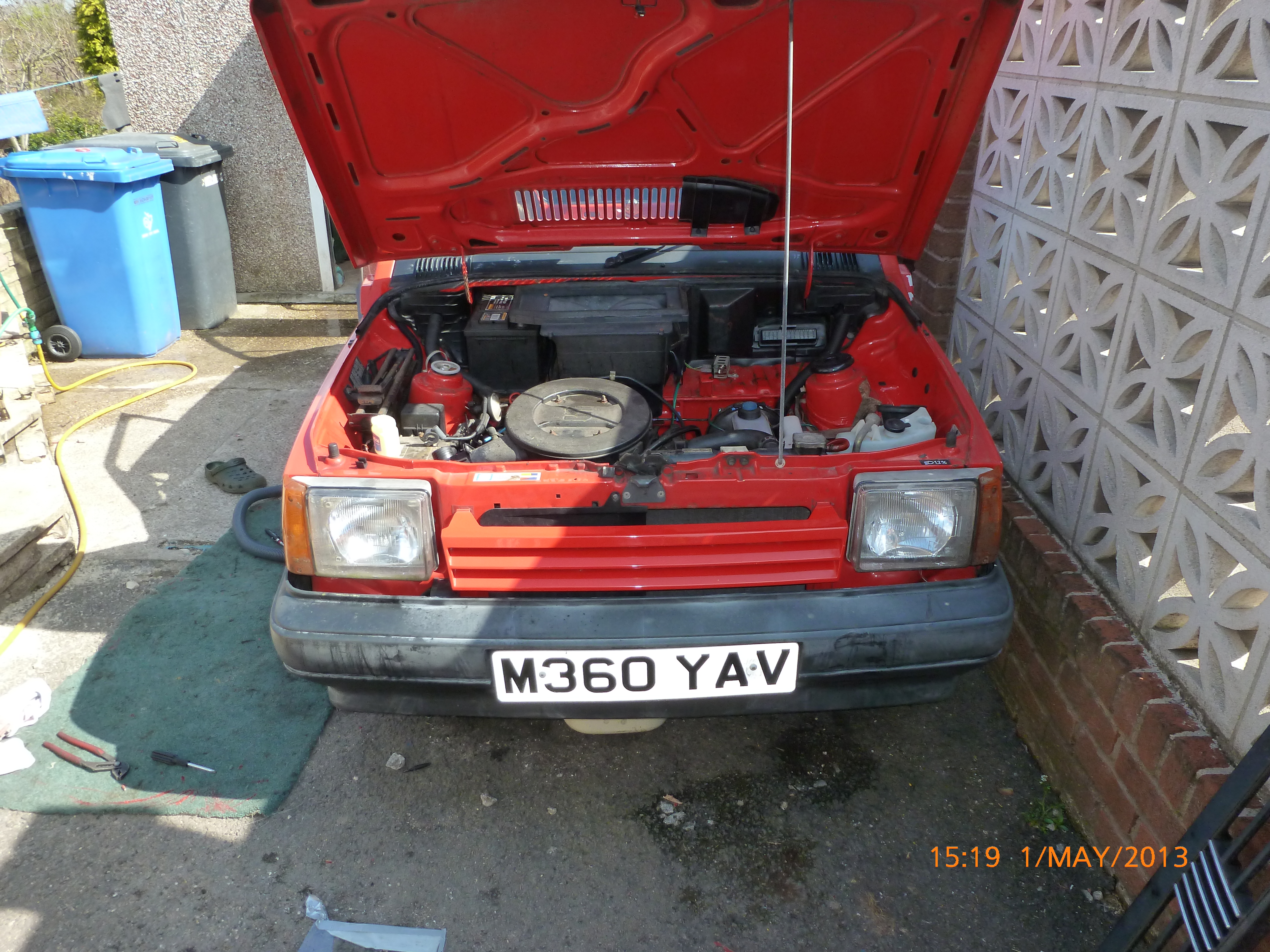

well i looked around it found i could not get the bonnet open, would not pop up when i tried to open it. i did in the end get it open and soon spotted the "causes of death fault".
a really melted wire leading from the alternator that should of been connected to the starter motor, it somehow worked free and arced to the engine block causing the alternator to lock up and burn the diode bridge out. it also had short run issues like quite a bit of water logged oil in the oil filler (these engines get that, its normal), a smashed front headlight, on the inside the drivers side seat belt has been worn by something causing it to fray, and it is also missing a wing mirror.

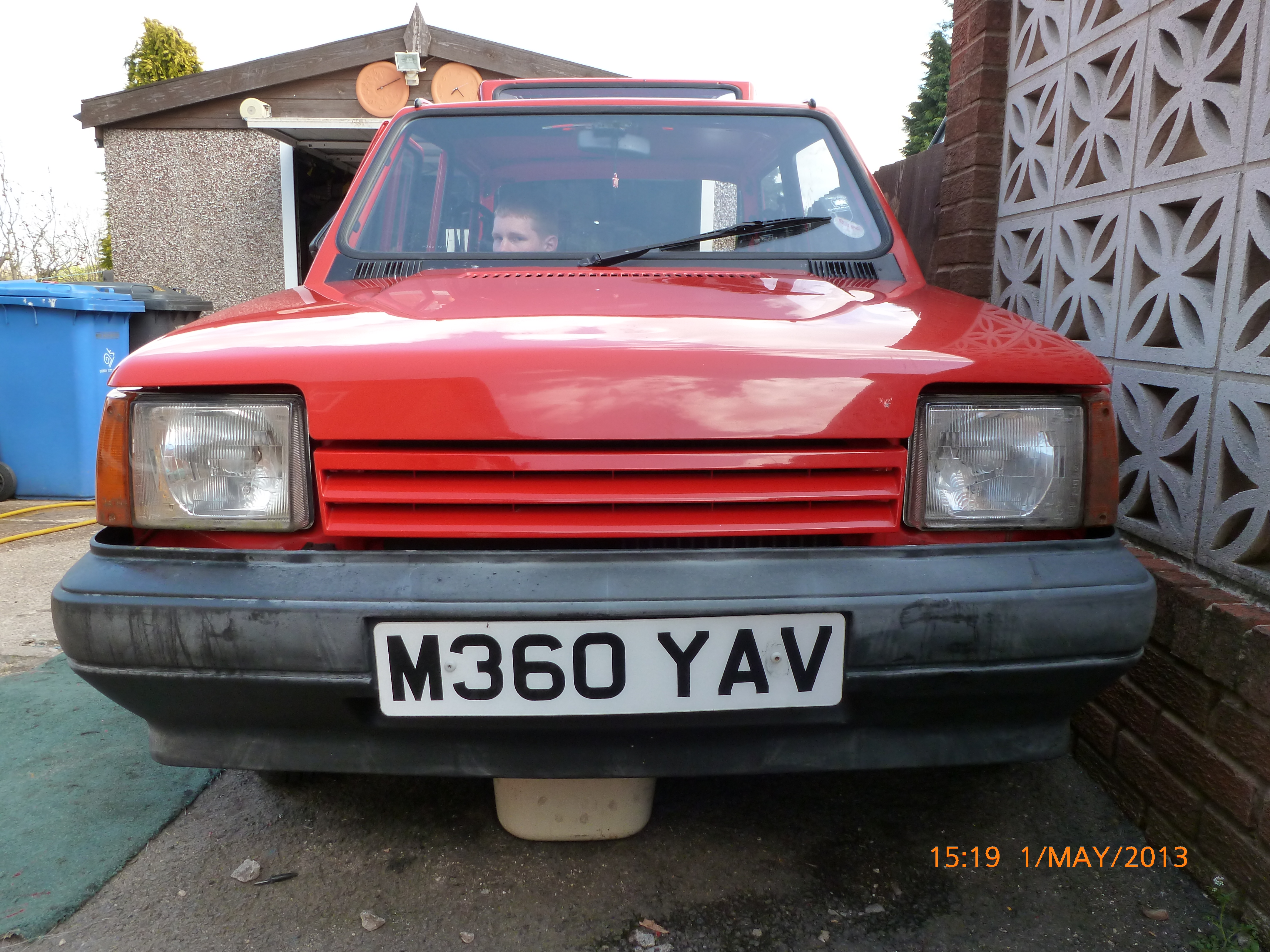

Today:
i have found out that red hammerite is the exact same colour match as the paint on the marbella.

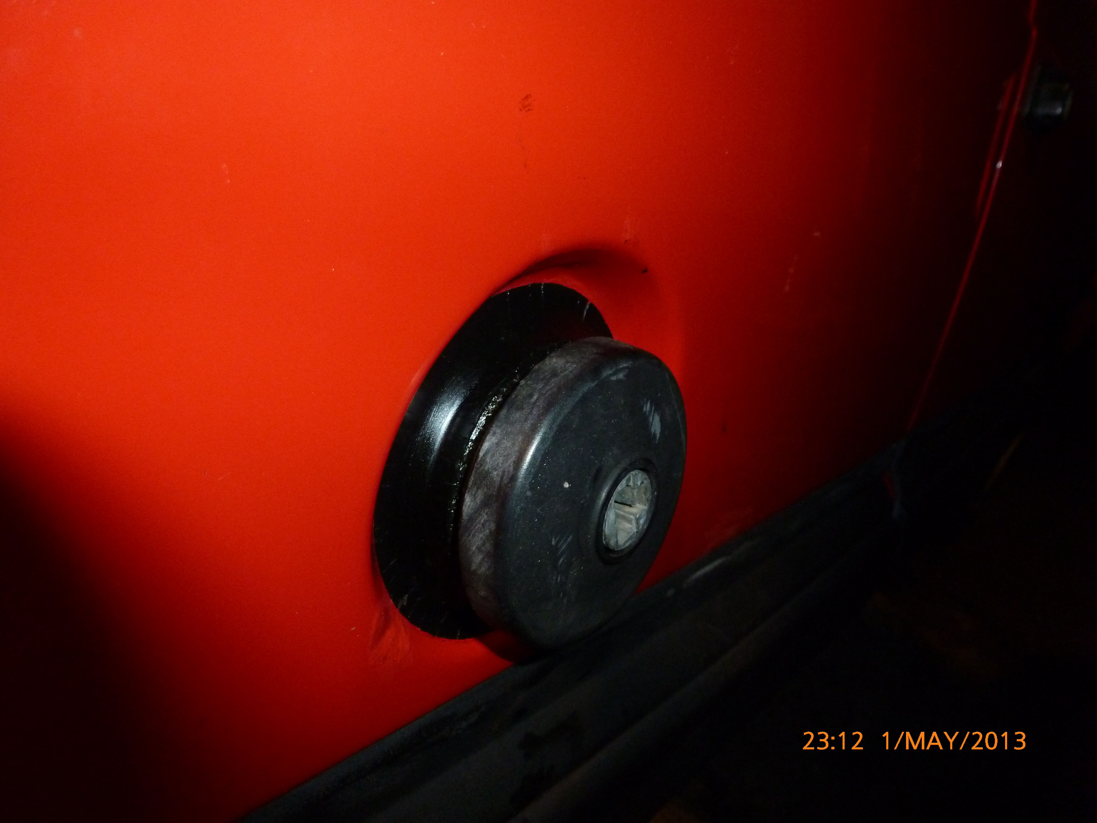

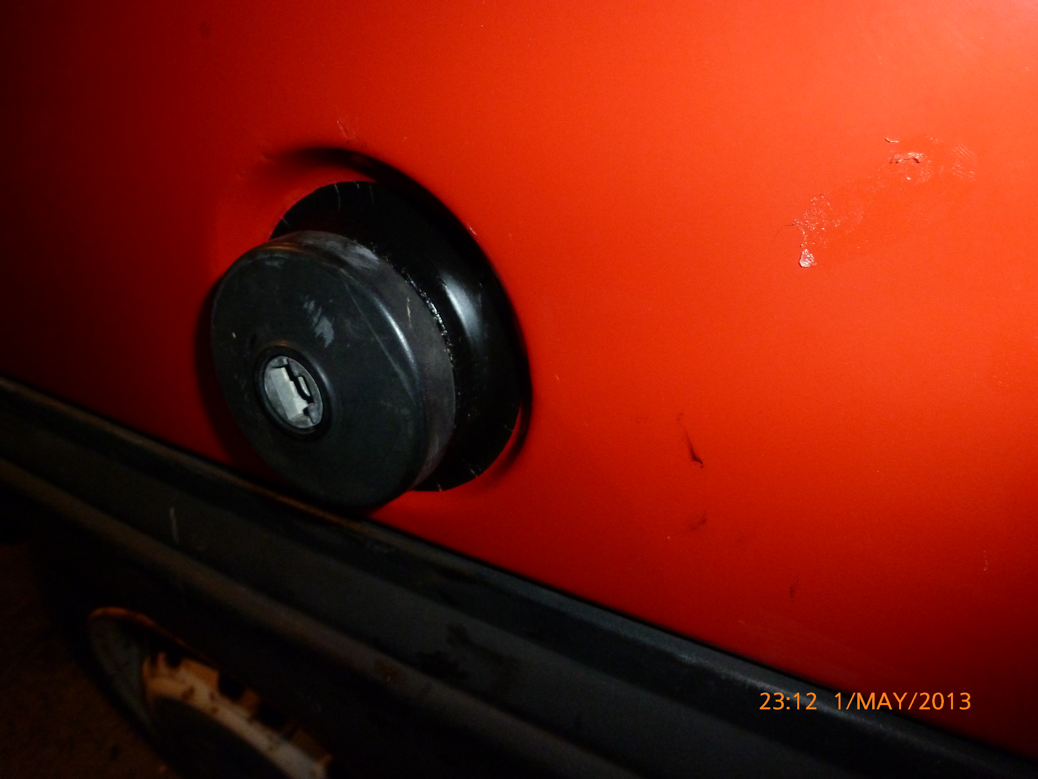

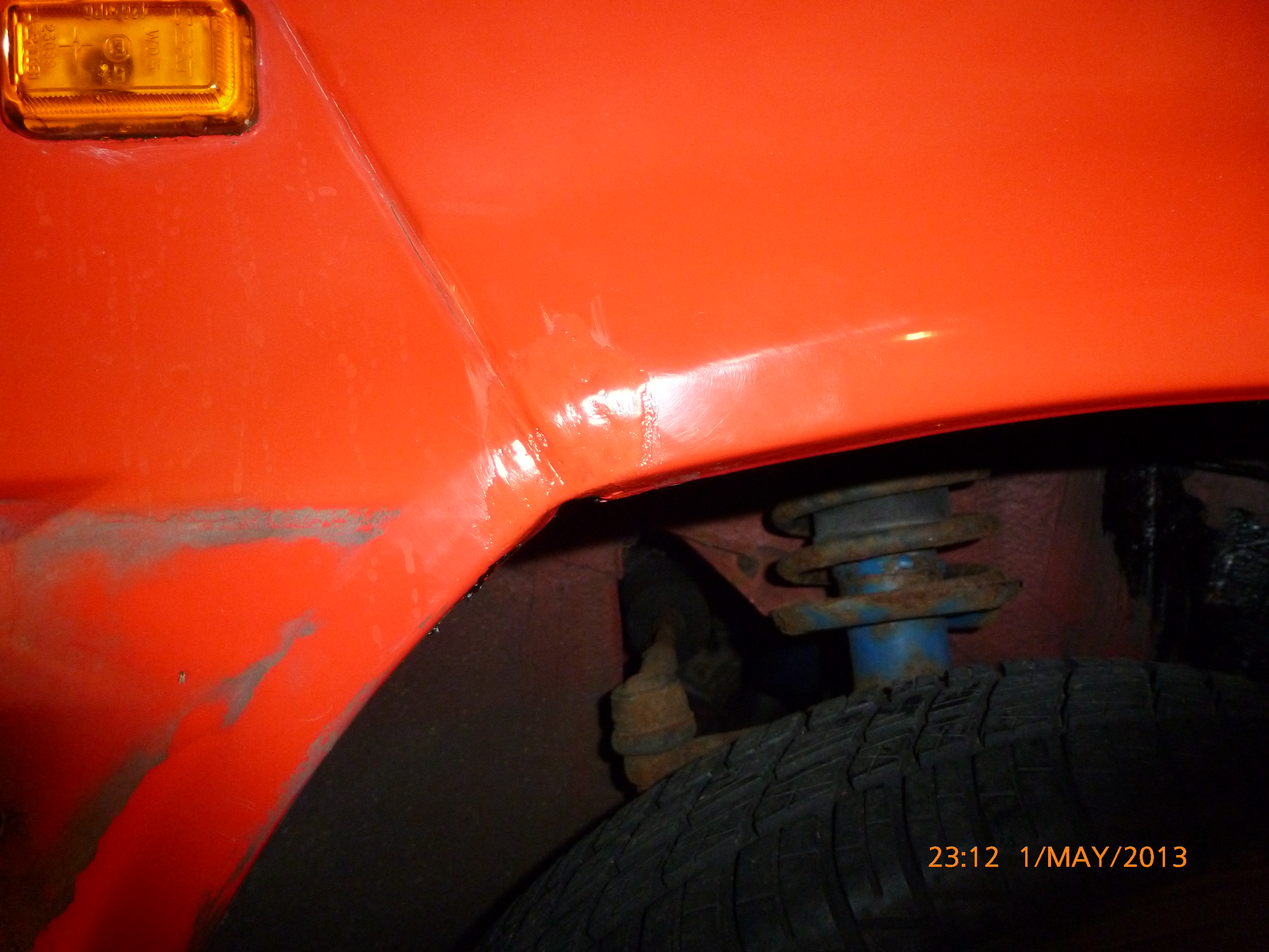

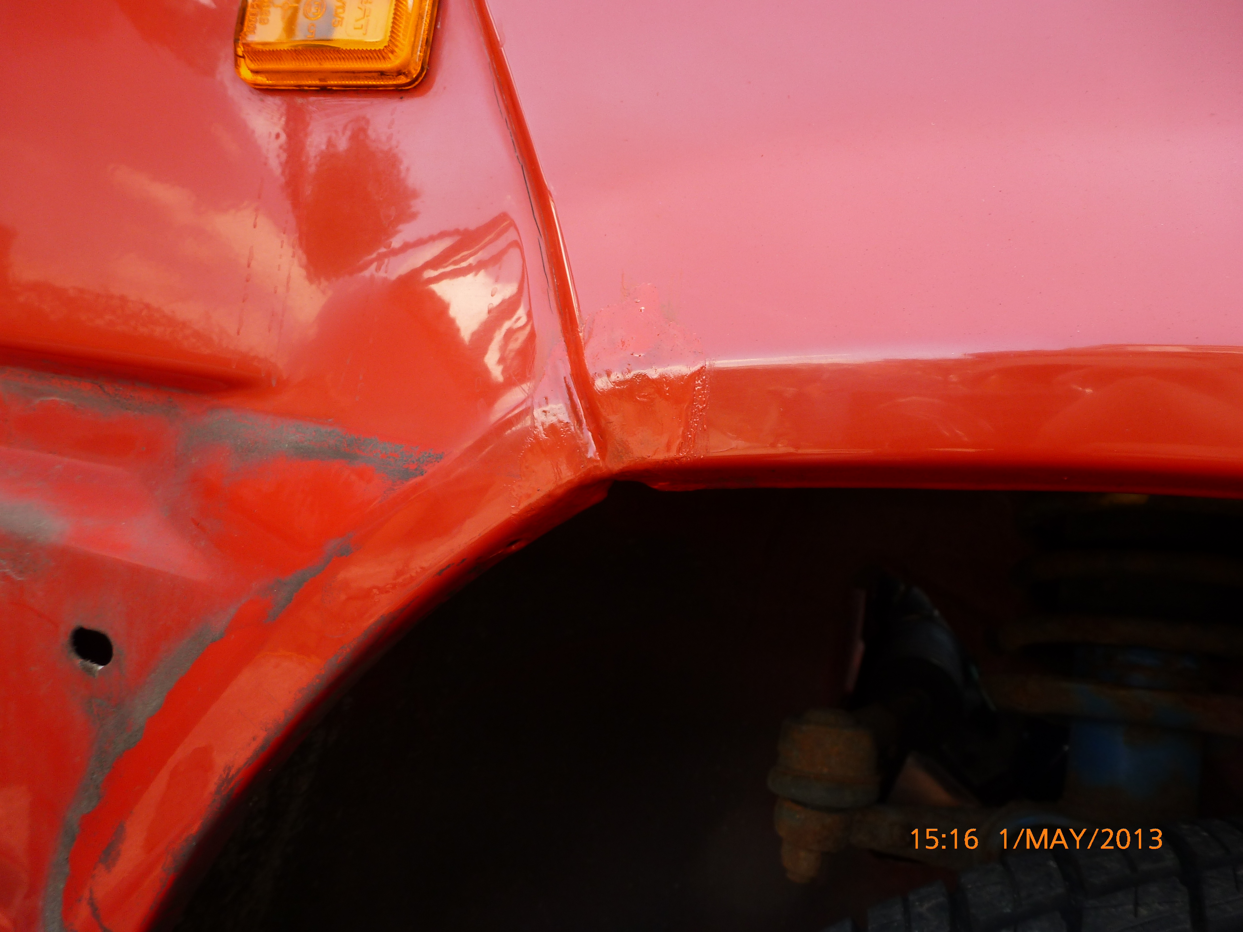

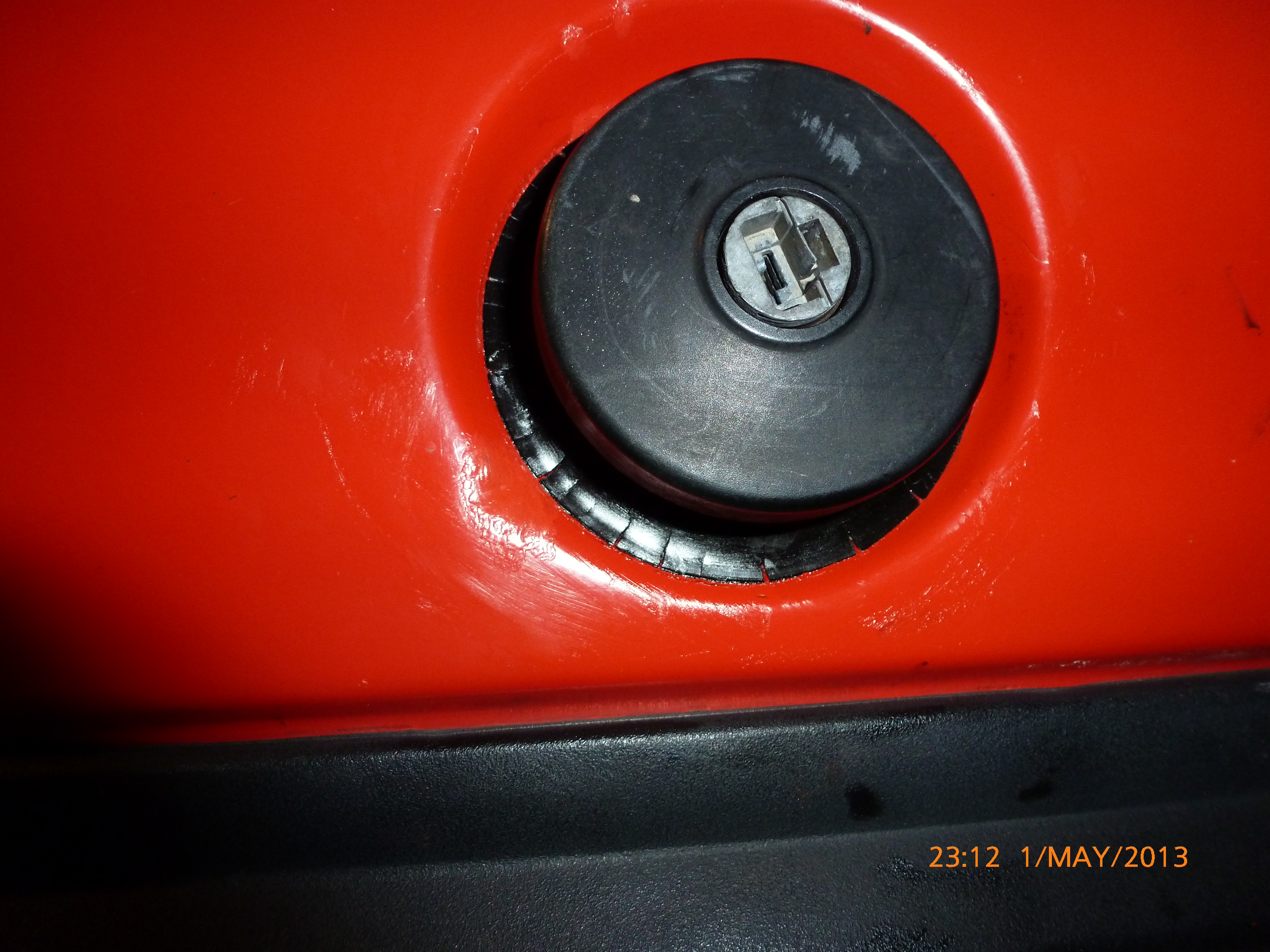

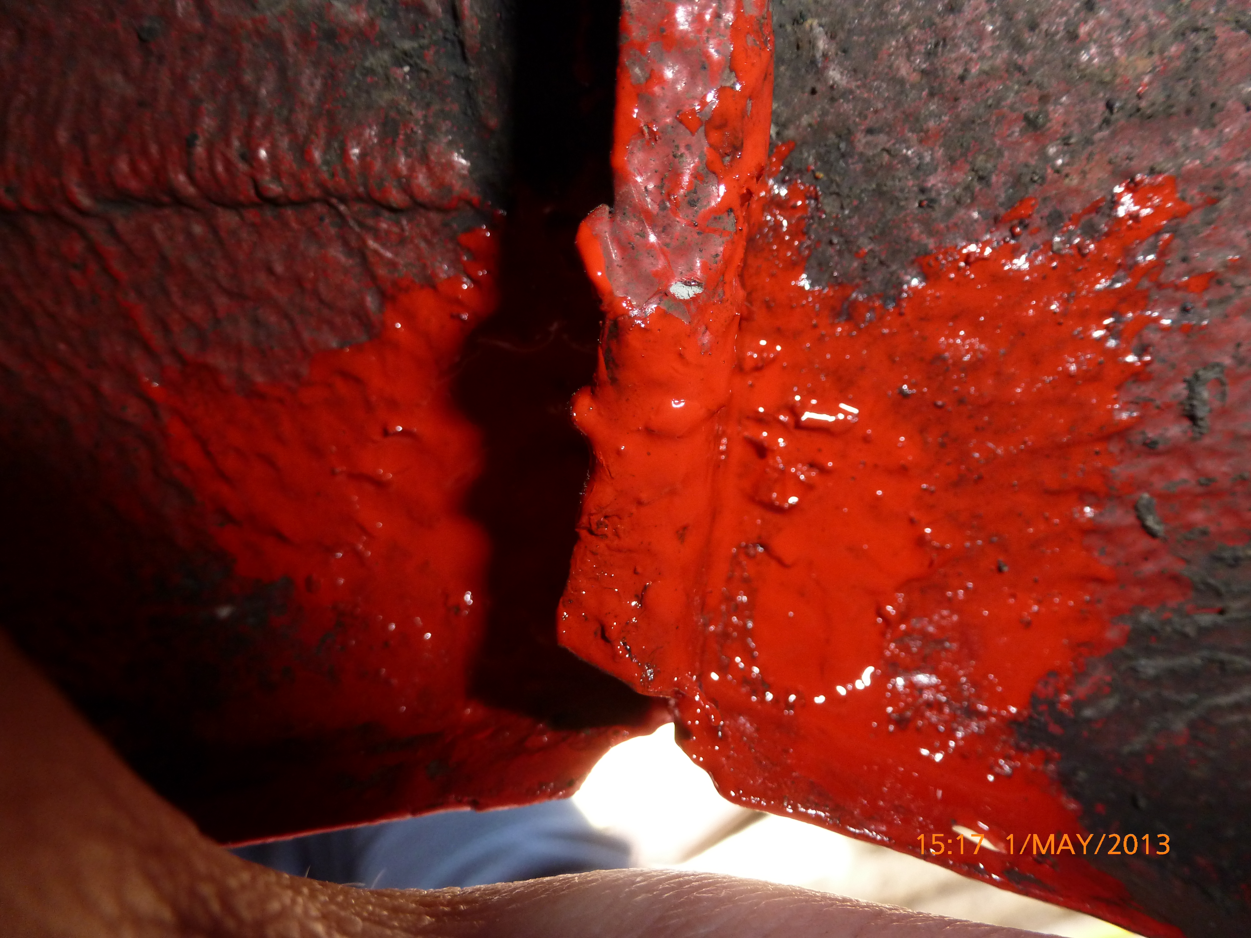

i have sorted the vandalised fuel filler pipe, that includes sanding down all the rust that occurred when the A'holes tried to pinch fuel from its tank. (as you rember from my last video, me showing the damage where some one tried to prize the fuel filler off with a screw driver.)

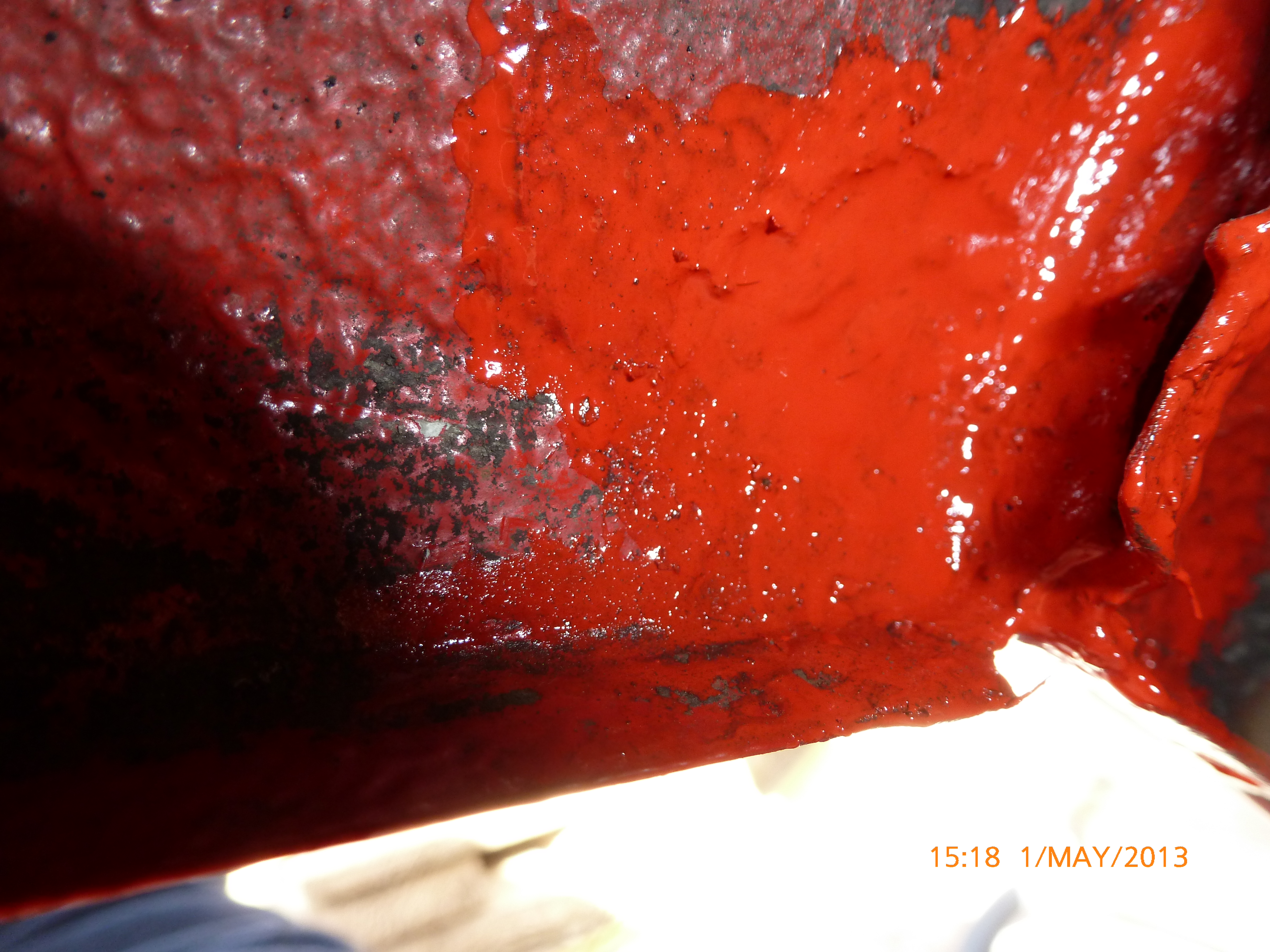

undersealed the whole rear drivers side inner wheel arch, yes even the filler pipe as the galvanized finish was starting to fail.

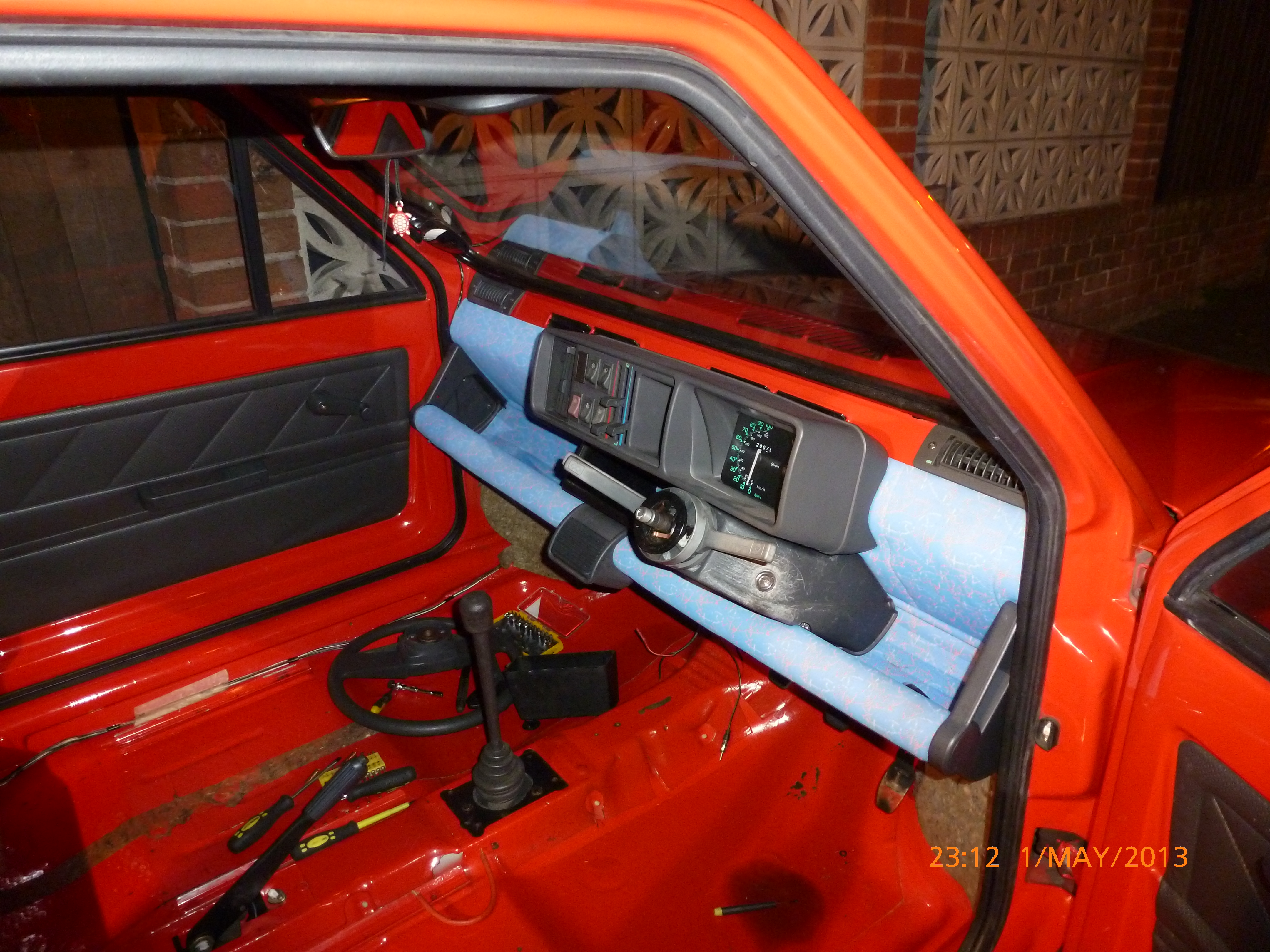

fully striped down the rest of the inside of the car, and dash to clean it all. now it is half way back together and dash replaced.

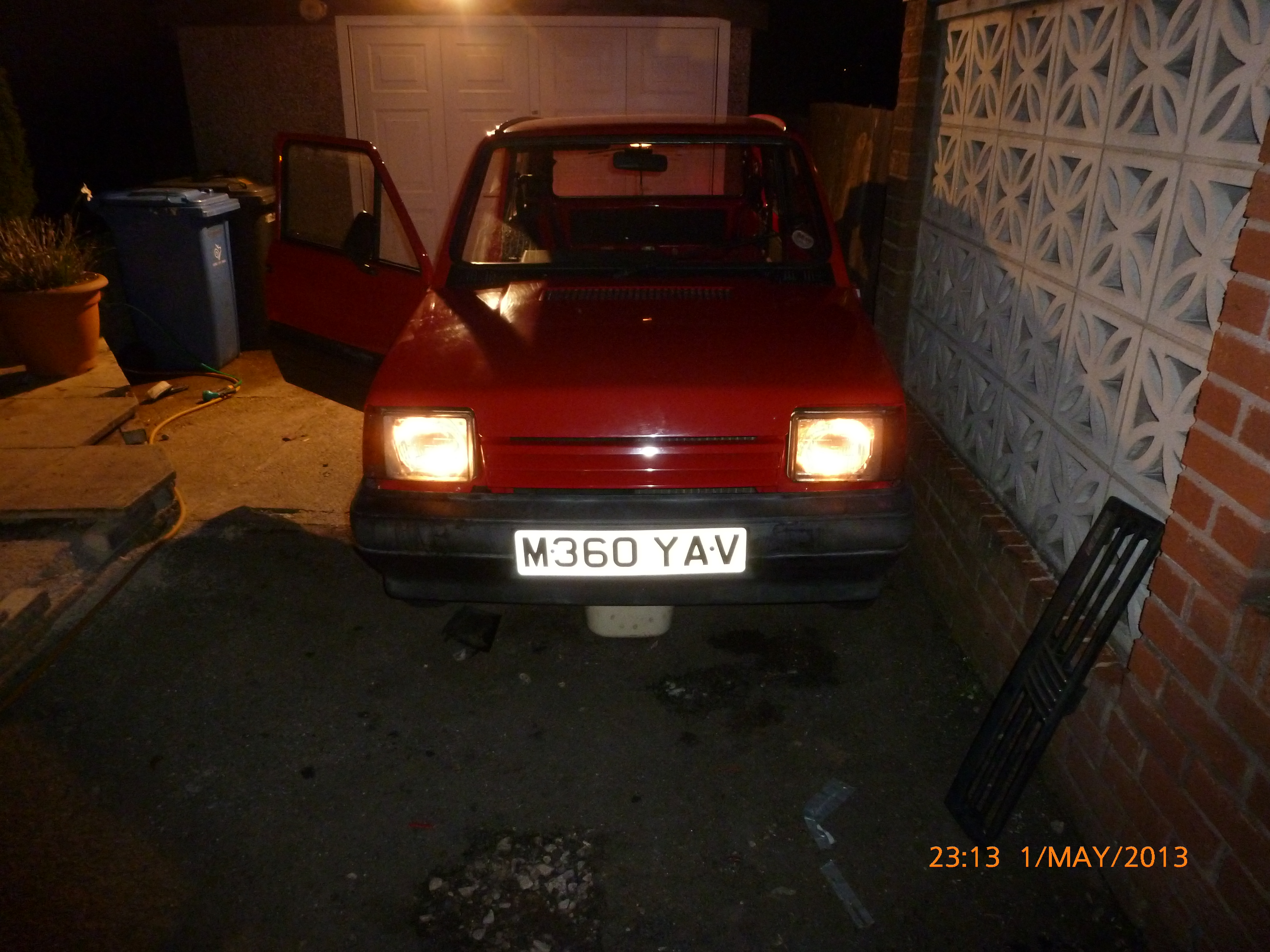

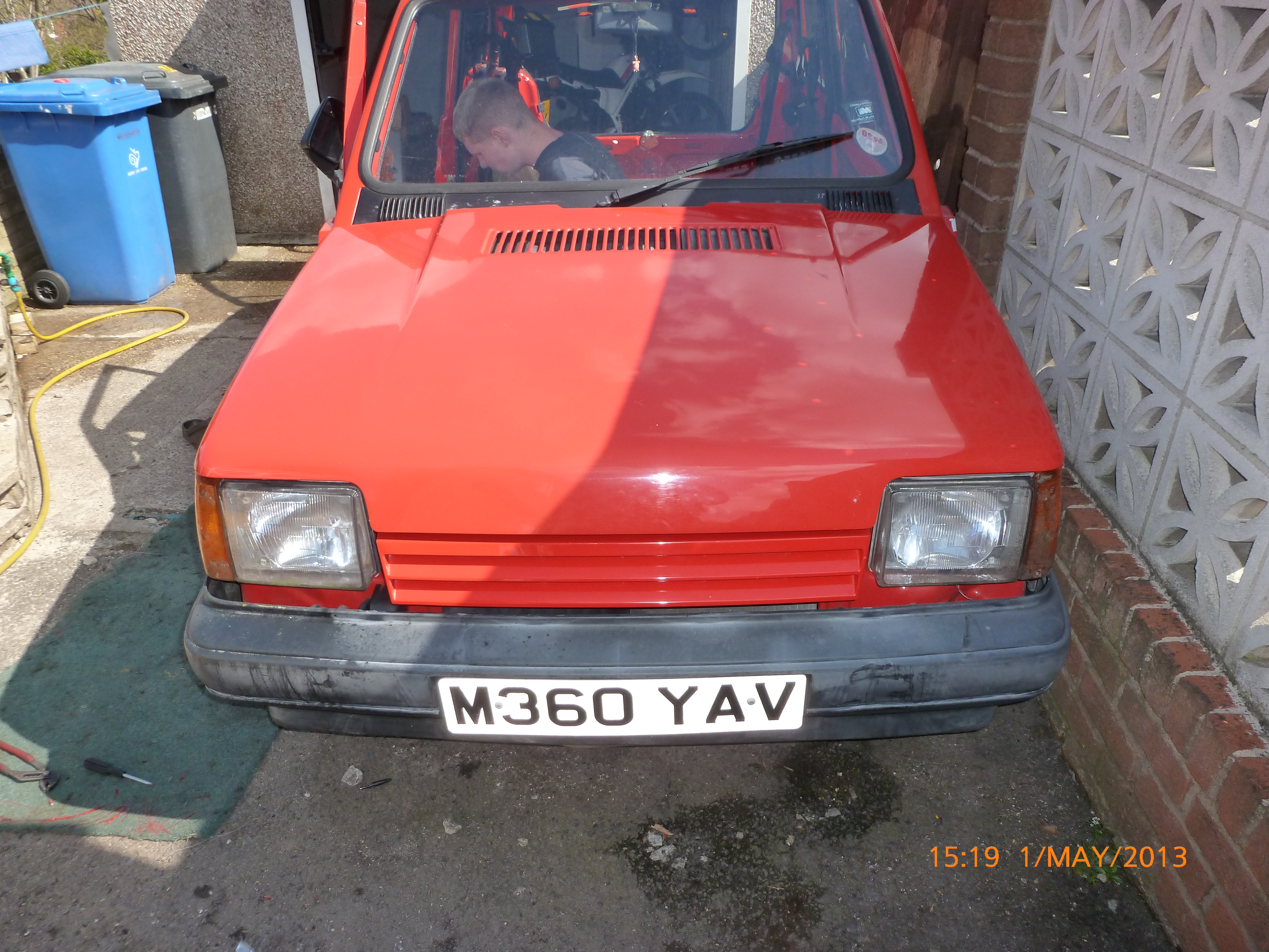

both headlights changed for panda headlights so they match, and all wired in.
and checked gearbox oil level... its low. unsure how low.
here.. have some pictures.. go on take a few..

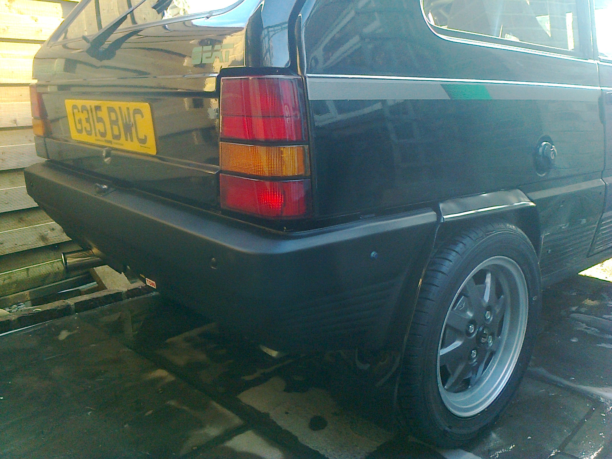

Ok well seeing as I have failed at the oil I will redeem myself by explaining panda mk1 and marbella differences :p

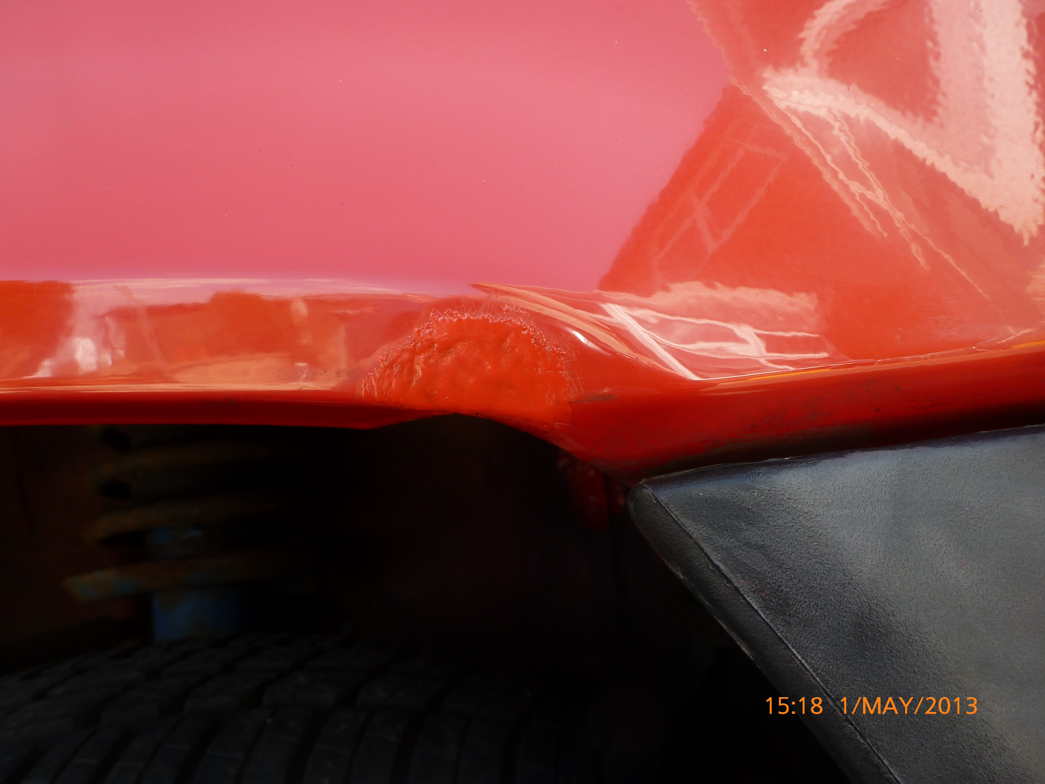

The entire front can be made to look panda pretty easily as the bumper mounts in the same place and so do the headlights. Panda bonnet will fit no problem but because it has a different windscreen scuttle there will be a larger gap at the windscreen to bonnet interface. The marbella has a nice bonnet actually that goes right up to the windscreen (almost like one of these modern type cars one see's driving around :p). The panda grille though will need those top tabs welded on as the marbella grille slots into the front panel directly.
The side panels hide all the lovely ribbing pattern and are reasonably easy to remove but unfortunately leave a tonne of fixing holes which would need some kind fibreglassing / welding up.
The mk1 rear bumper fits fine as well but your tail lights are wider and so fitting the mk1 tail lights will leave a gap into the rear wing quarter. You cannot fit a mk1 tailgate to a marbella unfortunately as the hole is smaller for to accomodate the wider tail lights. You would have to cut this section out and weldin in panda tail light surrounding bodywork in order to get a panda boot to fit.
Other than that the car is the same :p
In fact I bought mine with the intention of building a mk1 replica which I think I have gotten as far as I can now (without doing some of those more major things mentioned above!).
No more side panels and panda mk1 bumper really suits it I think (with some custom mods to accomodate the wide wheels :devil:):
