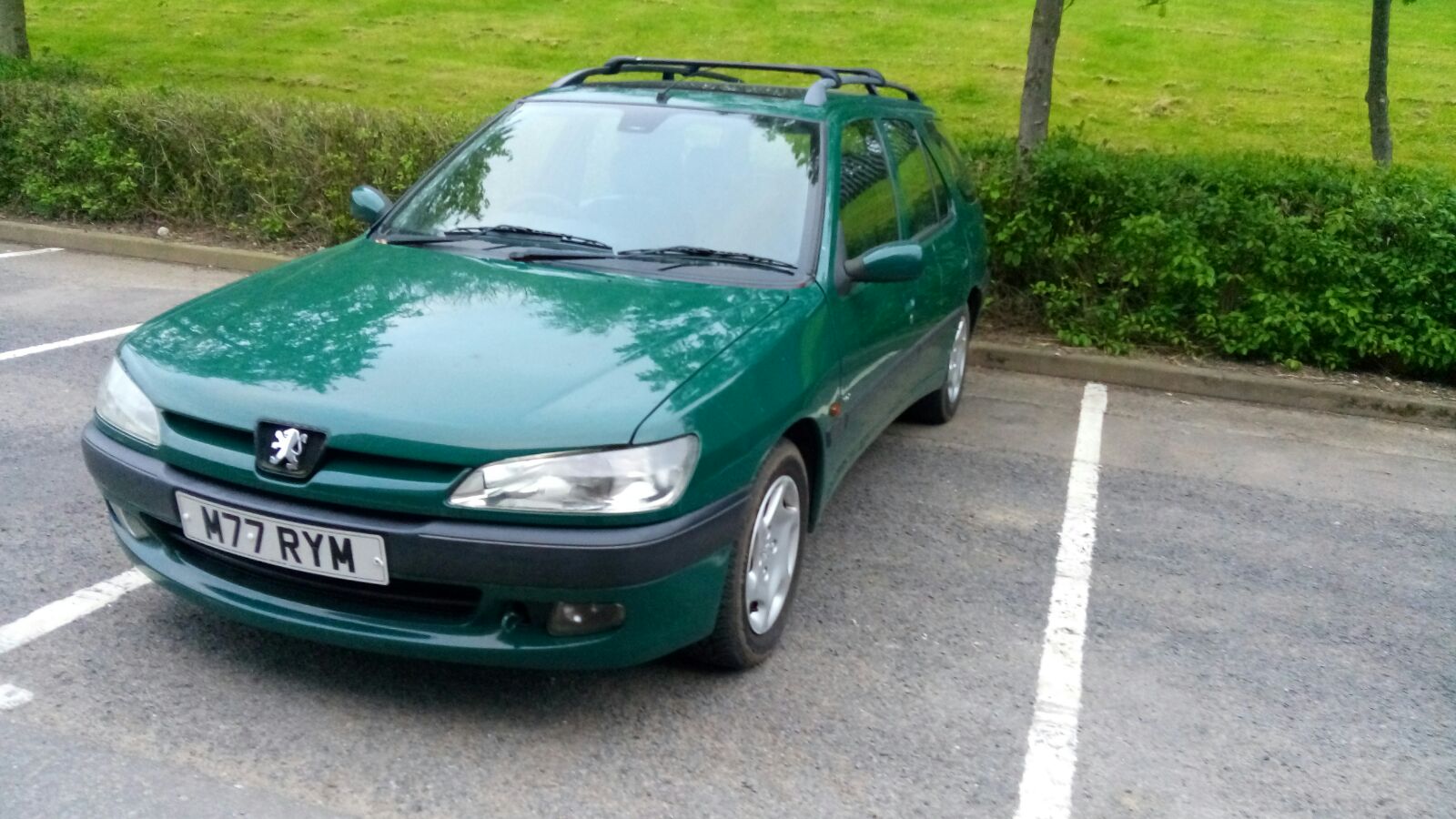

So i present to you, A car that cost me a grand total of £50!
A Green Peugeot 306 estate with the 1.9 XUD (1905cc) turbo diesel engine.
i bought this car almost 2 weeks ago. it was from one of my brothers work colleagues. it had been in there family for 16 years. the car has never been serviced in this time. just the oil topped up when it needed it and parts replacing for the MOT. its just had a whole complete exhaust fitted to it!.

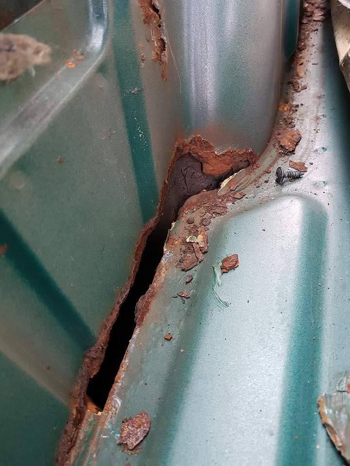

the only rust it seems to have is around the sun roof. i will have to look into ways of fixing this. one of the methods i though of was to chip out the crusty rust, use some rust converter, paint it using whatever then to fill the holes use expanding foam, cut off level then hollowed down to give me a structure to apply filler to then skim and sand it smooth. the foam is pretty water resistant so should prevent any more rust on the inside. its a bodge as the best way of fixing it is to cut out the bad and weld in new but the car cost me £50 and i think this would work just as well.
