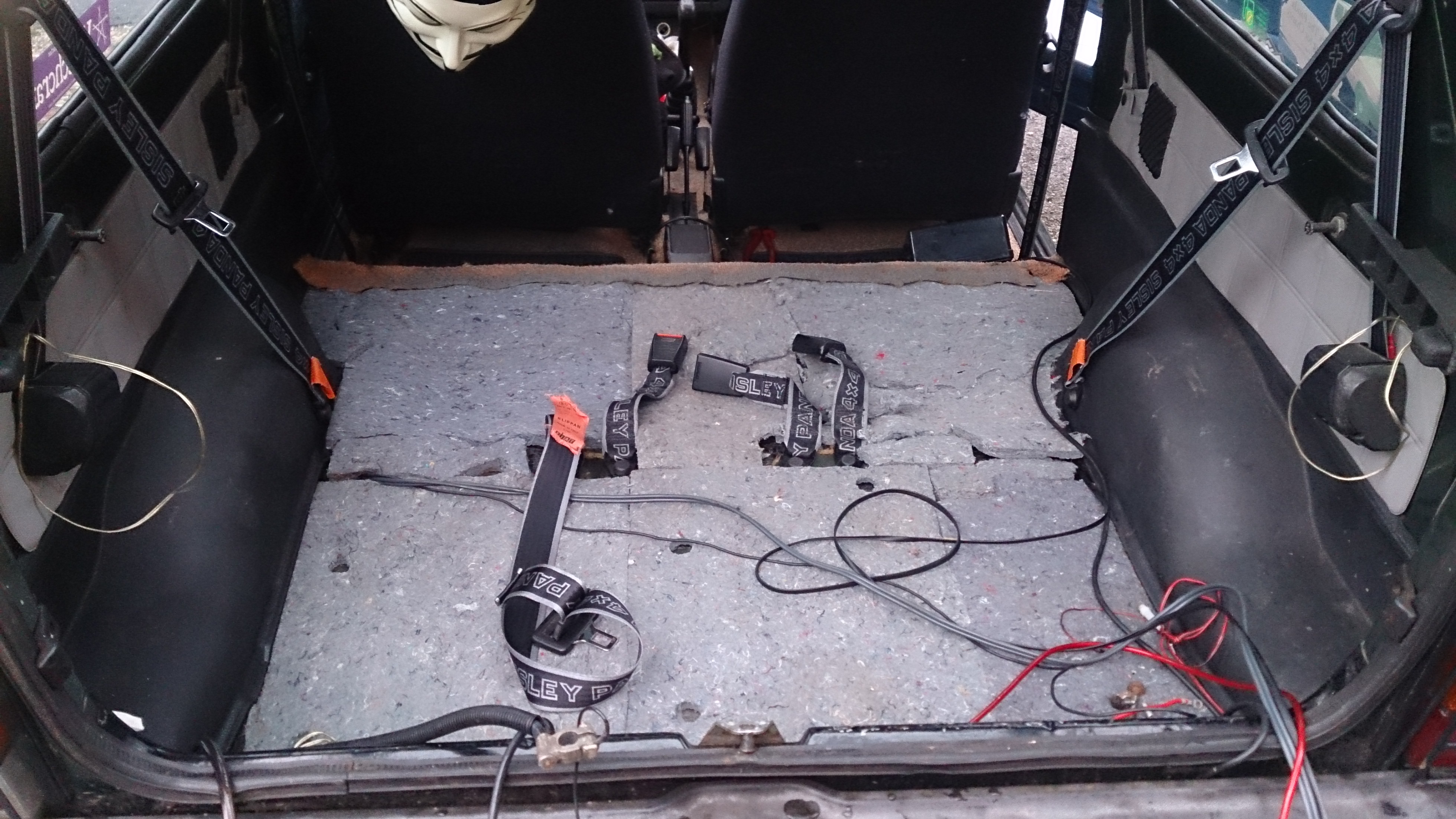

those of you who have been in Talon, wonder why he is such a quiet panda.. this is why.
its under everything, all the plastics and carpets!
now you know why i dont really want to go in deep water with him.
Fallout is going to be so loud... it has -Nothing- (but a rubber floor from a 750) in it..
yup! soaked with water and with all this add-ons like bullbar, fancy electronic gadgets and this lighthouse equipment on the front plus the radar mast on the hook and we have nissan patrol class heavy weight panda champion:D

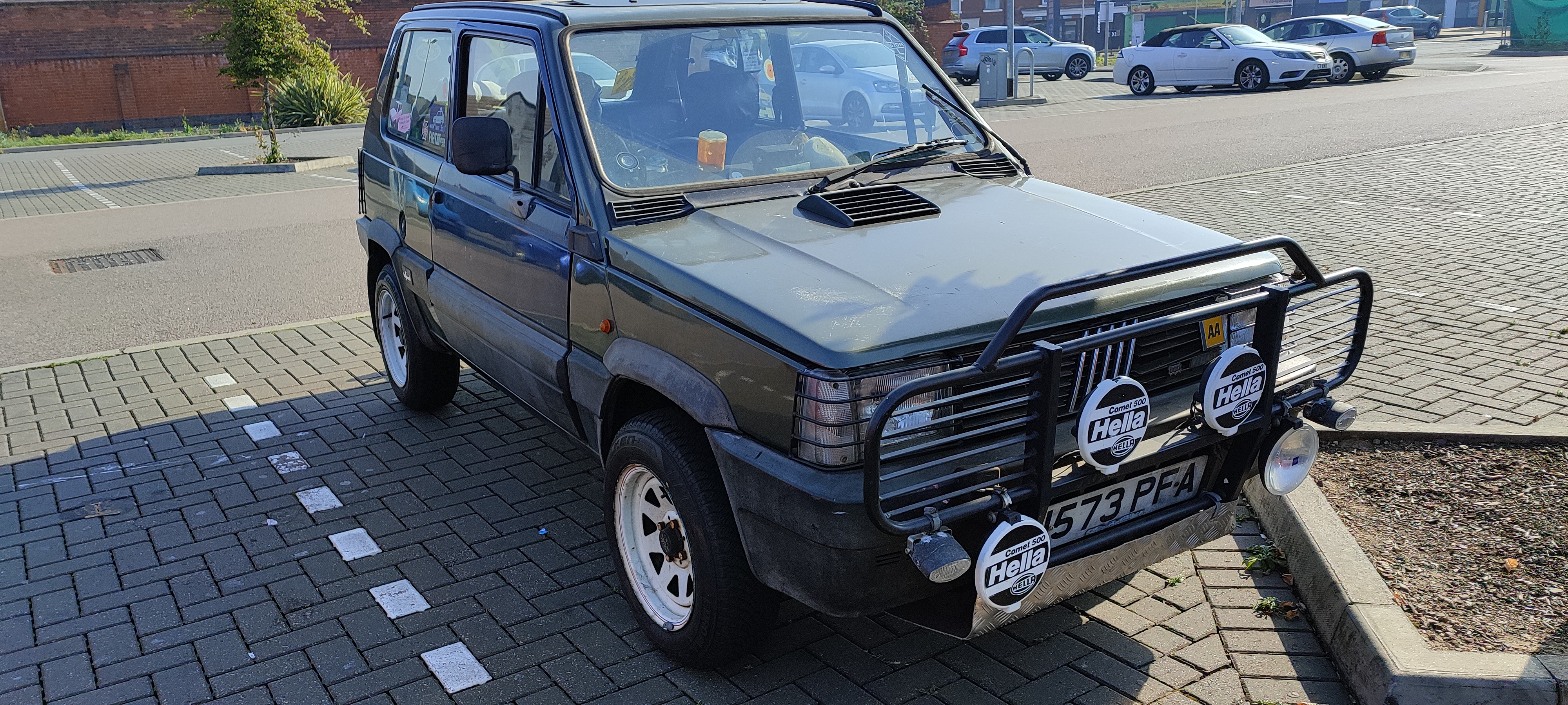

heres a picture of Talon in a Aldi car park a few days ago:
and a picture of the inside from yesterday:
its so good to be piloting Talon again. the bonnet seems HUGE! back to basics, just how it should be.
